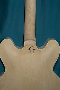

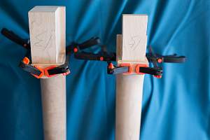

    As I mentioned in my first post for the build [with photo] I explained how I wanted to sort that gap out between the neck and the rear of the body by adding some wood to the neck heel.
    So that's what I've been doing today [same on my ES-3 build]
    I'll give it 24 hours drying time then shape it.

    I pretty much finished the heel extension that now brings the neck flush to the back of the body.
    One thing I've sort of had second thoughts about, and that's leaving the small bit of binding across the top of the neck pocket at the bodies rear..... I think it would look very amateurish if I let it on.
    Any recommendations on removing it cleanly without disturbing the binding on the sides ?
    Would Acetone be of any use removing it?
    I'd rather use a solvent if possible to soften the glue, as I know it's going to be rather frayed ply underneath it [which I intend to fill with a sawdust/titebond mix]
  4. #24
    Tweaky I think the binding below the neck pocket looks good. Fair risk of damaging the joining binding on the horns if you remove it
