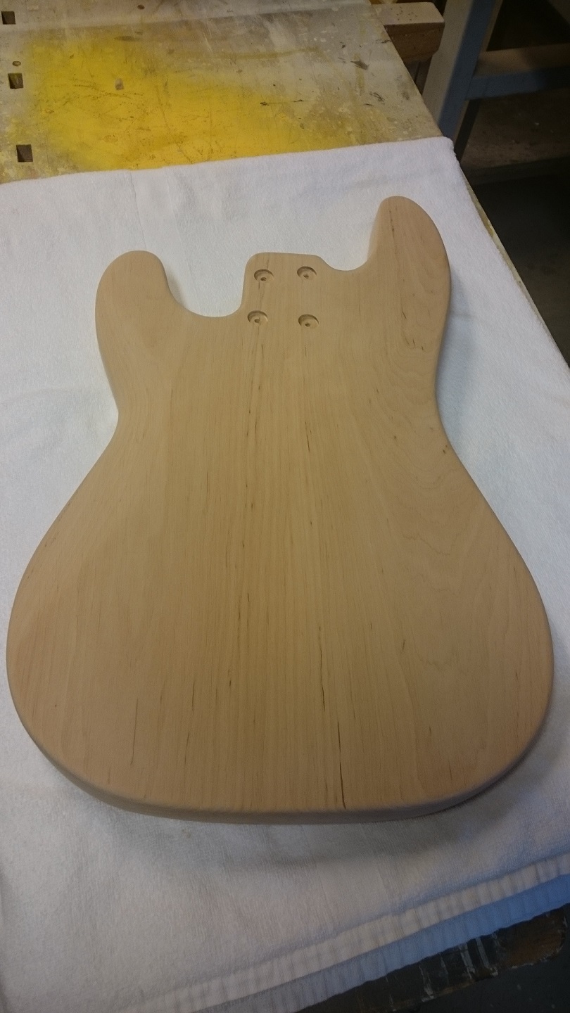

    Got the pups aligned couple of days ago and then sanded and shaped the body with 60-120-180-240-320 grits. Now it would seem that the sanding part is mostly over.
    The pups have a quite short string spacing - mainly the DM Model One since it's meant for the short scale narrow neck SG-type of bass. Therefore can't be perfectly aligned with the strings but that won't matter. What puzzles me is the DiMarzio's attachment - It's so high even when on top of scratchplate that adjusting it to match string volume is quite challenging. Not so sure it's even meant to be adjusted or what type of screws it usually comes with (bought it used and just received the pup). Could not find any pics online about the matter. The SD would seem to be ok.
    Now it's scratchplate time (black plastic) and cutting a control plate out of a sheet of stainless steel (polishing afterwards). Placing these on the body and then on to finding a blend for the color.
    Here's some pics so far:

  4. #24
    looks excellent Arzi
    can't wait to see some colour on. Will the orange and black be stained or solid paint ?
    Hopefully you can work out the height of the DM pup. Best sort it out before you start staining/painting. Maybe the cavity needs to be deeper ?
  5. #25
    Member Arzi's Avatar
    May 2015
    Vantaa, Finland
    400
    Hi
    It will be stain. Still not sure if I'll do the burst - might be sweeter without just grain popped. That way the scratch plate would pop too and more orange would show as well as grain.
    The cavity is deep enough but I was hoping I wouldn't have to make a cavity as big as the wider edges so that it would look cleaner around. Maybe if I just make the hole on the scratchplate bigger then it will be about 2mm lower and still quite clean looking. The edges are so much wider than the coils that it will look stupid if raised too much. We'll see...
