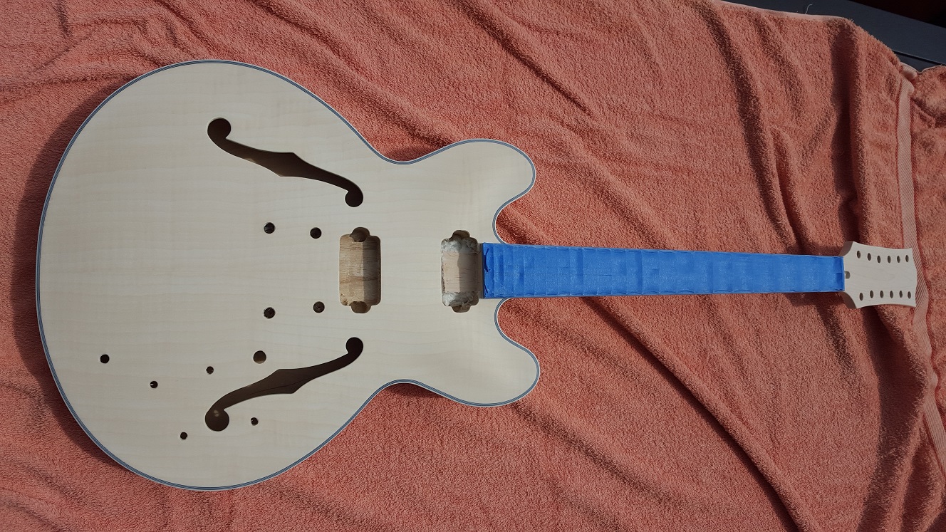

    And on the build side of things ... I set the neck today, clamps come off tomorrow and I'll have a reasonable idea if this thing will be loved or given to one of my grand-kids to play with

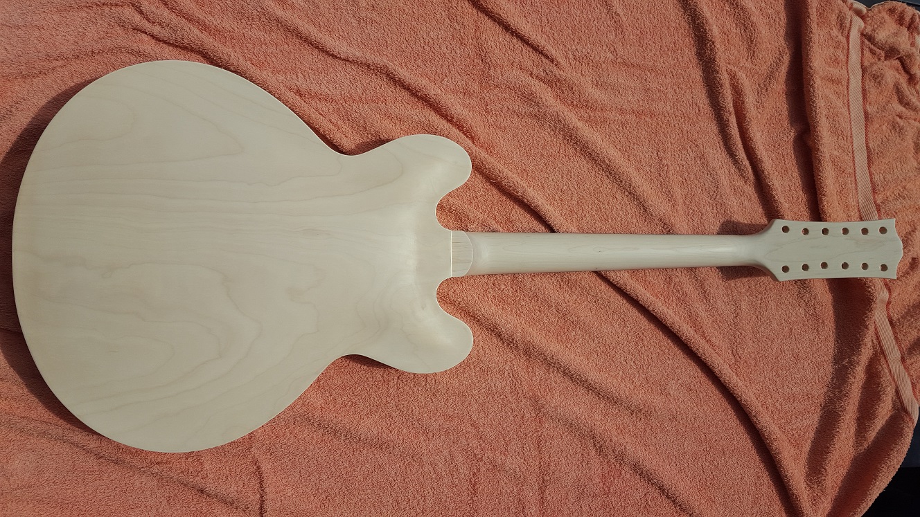

    Eight coats of clear, time to let it harden up a bit.
    This week I'll have a long hard look at the electrics.

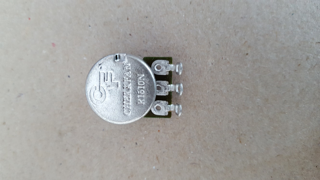

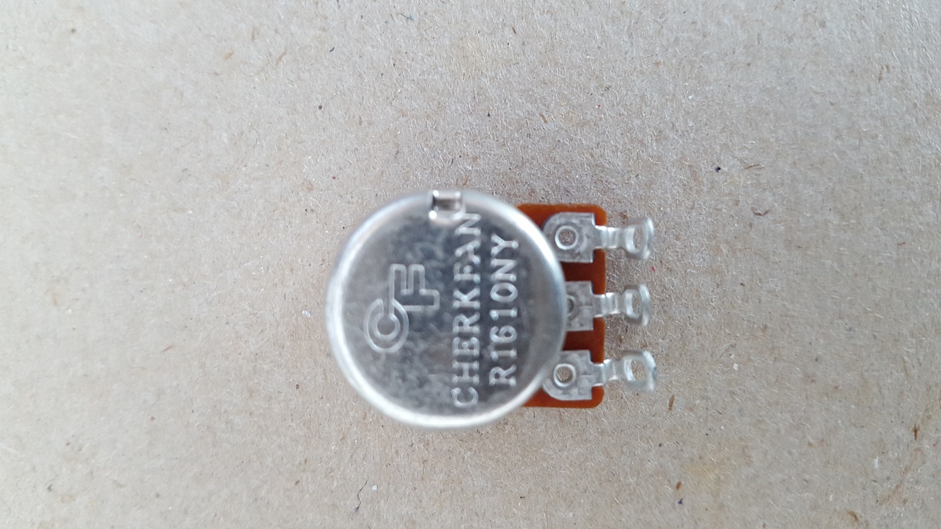

    Supplied in ES-12G kit are 4 pots.
    2 with R1610N stamped and a green colour on the backing.
    2 with R1610NY stamped and brown on the backing.
    How do I know volume from tone or ore they interchangeable?

    Hi Corky, check the other side of the pots to see if it has A250, B250, A500 or B500 printed on it. the number is the resistance and you generally use A pots for volume and B pots for tone, one is audio and the other linear taper
  7. #27
    Member cork sniffer's Avatar
    Dec 2015
    South Coast NSW
    348
    Thanks heaps!!!
    Yep 2 with A500K and 2 with B500K.
