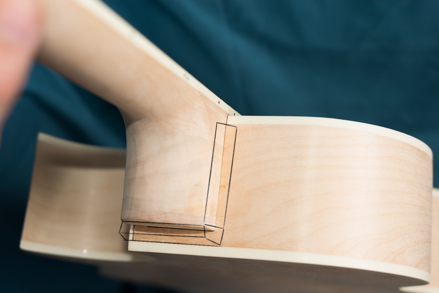

    I've been thinking on this neck joint issue, it's not just the clamping that is the problem...well if your kit is anything like mine.
    There is also the issue with unsightly gaps on mine where the binding and the body don't meet, both behind the neck heel, and on the low bout of the body...then there is the issue of the probable gap between the body and the neck once glued do to the inability to clamp it in that direction ...my body also suffered minor splintering of the top veneer while dry run fitting of the neck.[see photos below - click for better view]
    I have the same problem with the gap behind the rear of the necks heel on my ES-1 kit
    I think I have come up with a solution to all three problems, but I think this needs to be addressed before you start any finishing, as you'll see why in the photo below.
Name:	_DSC0342 paint.jpg
    Basically it would need a small block of wood glued to the necks heel to extend over both the side gaps on the left, and the gaps directly behind the neck....if feeling confident, you could also glue and shape a extension to the right side of the neck joint, covering any gaps between the neck and the body...plus in my case, unsightly veneer cracks.
    You'd need to create a flat surface on the latter side of the neck [only say 10-15mm ] to glue the extra wood to, as it is shaped at the moment.
    Once the extra blocks of wood are glued in place, just rough shape then with a rasp, then sand.
    I've looked at just how much hand extension one would lose by adding this extra piece of wood down the side...I think it is minimum, as the neck /body is so thick anyway, you tend to slip your thumb under the neck rather that trying to grasp the heel to get to the bottom frets.

    Nice work around, Tweaky.
    I have had to similar things with a Silver Falcon kit but what I did was install some shims to block out the heel and then slapped on some binding to match. Problem solved.

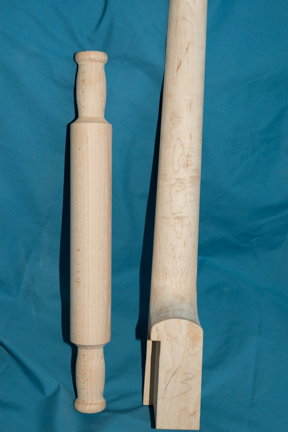

    I thought about the binding fix, and if it was solid wood I'd probably try that first, but since it's ply we are dealing with here, and there already is some fragility of the ply in the place I would have to route, I thought the ply might split even worse.
    Anyway, since I have had these kits several months, I had noticed these problems ages ago, and have taken my time to try and work out solutions for them, so this stuff isn't just coming off the top of my head.
    Try as I might, I haven't been able to source a small block of maple to do these mod's with.
    The nearest and best solution to date I've found has to been buy a rolling pin from Victoria's basement [nearly typed in secret LOL ]
    I think it's Palm wood, the density is about the same as Maple, and the colour is as well as you can see....the wood grain isn't quite as tight, but I figure that I could probably use some complementary wood filler to sort that, and as the pieces of wood needed to do these mods is so minimal, it shouldn't announce itself by clashing with the rest of the build

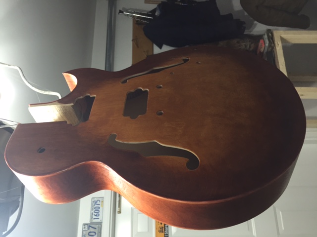

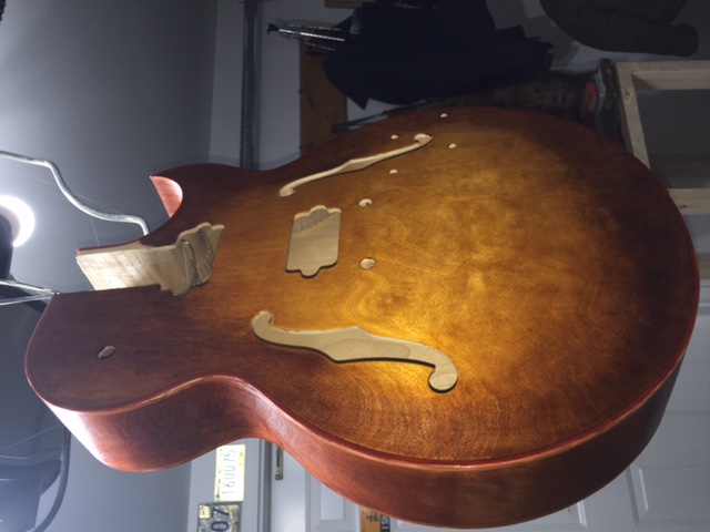

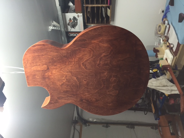

    es-3 Update 5
    coat number 3 done. doing coat 4 now. moving on to the base colour coat.

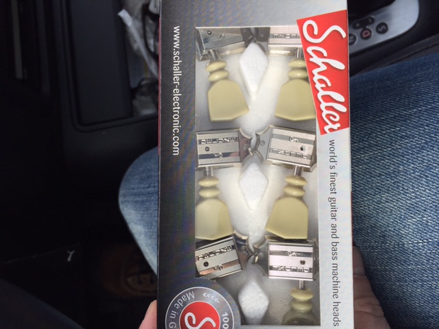

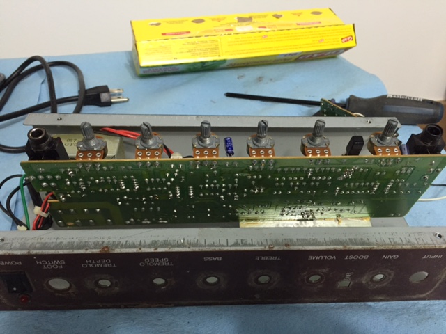

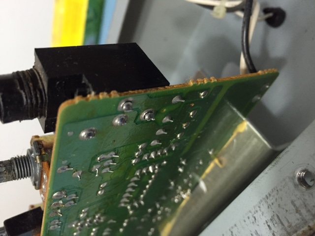

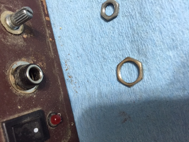

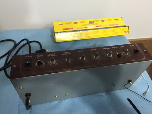

    es-3 Update 6 - side project
    Hey everyone,
    picked up this Vox pathfinder 15 amp for 40 bucks (canadian) off kijiji. great deal. however it was broke. got a new 1/4 inch jack off ebay for it that i will solder in, give it some elbow grease and it should be a great little amp for my new kit guitar in my basement.
    also got those gibson vintage style tuning machines. should look sharp on the headstock….
