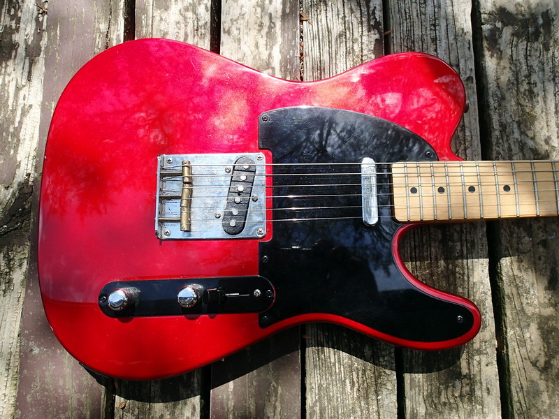

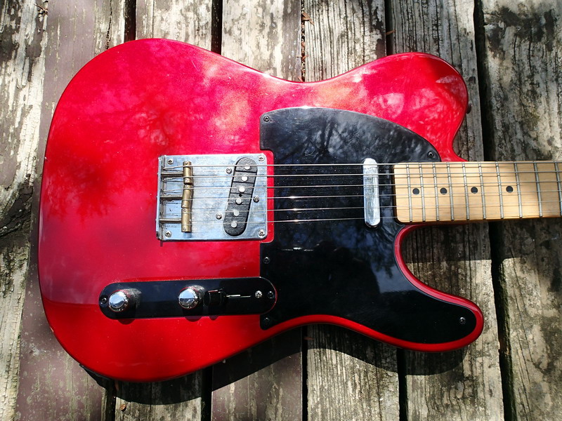

    @ Dave, Woah what a great tele! is that veneer on the headstock or stain (I cant tell from the photo). I was thinking of putting a veneer on mine but wasn't sure how it would come up with a natural colour maple neck. I think it looks awesome! You don't happen to have a build diary on that one?
    G'day Andy,
    It's an ash body with maple neck, the headstock is just a lot of coats of the same FW Mahogany stain as the body, it's rather nice to play but is quite heavy ( when the boss goes to the weekender next weekend I'll stick all my guitars on the scales and report back )
    I have a bit of a description in the non PB guitars forum but no diary because it's a foreigner, Wilkinson compensated bridge and 1970s Schaller humbuckers ( not tapped ) with the standard controls & tuners.
    I really should take the pots up to 500k one day

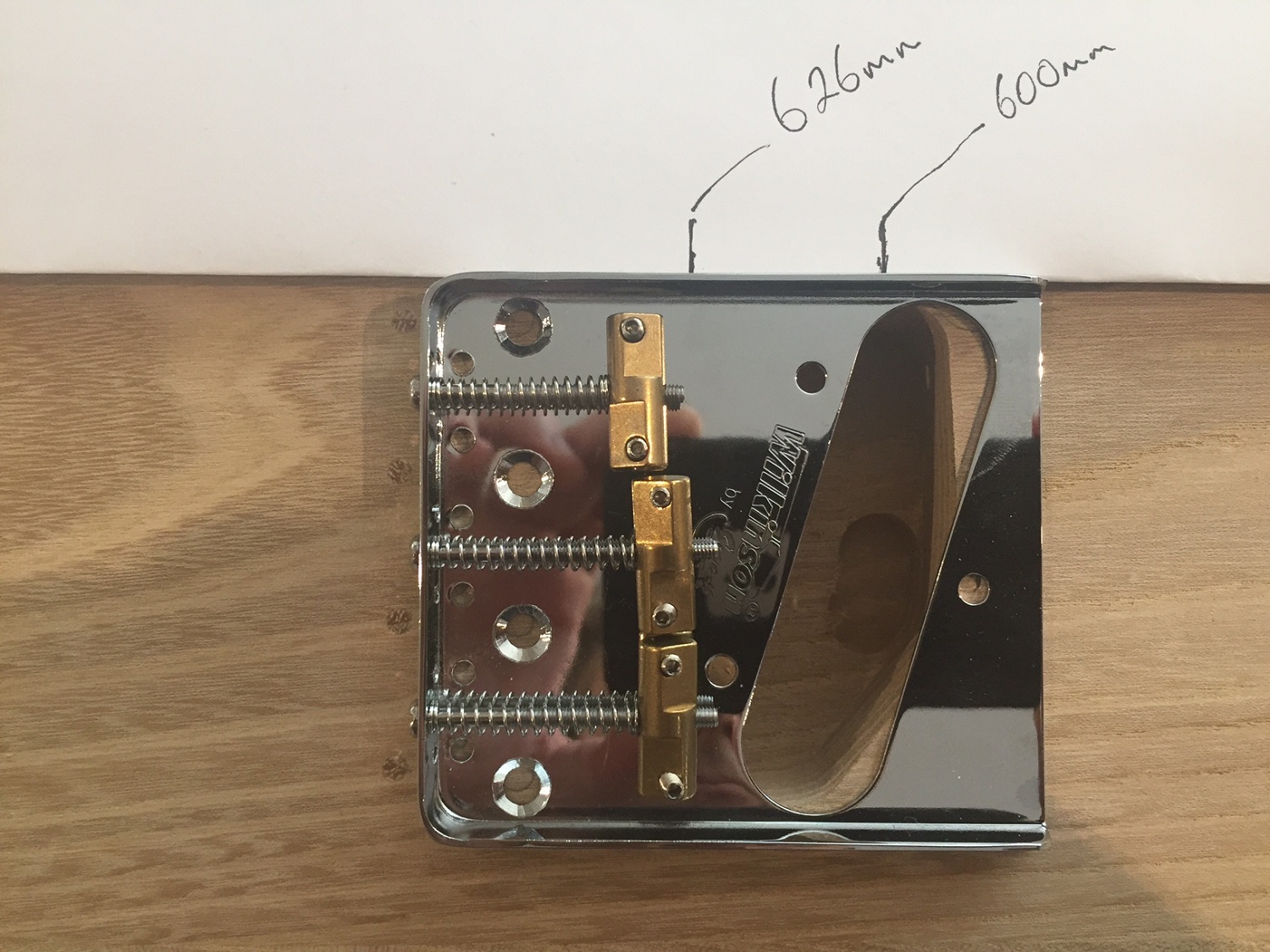

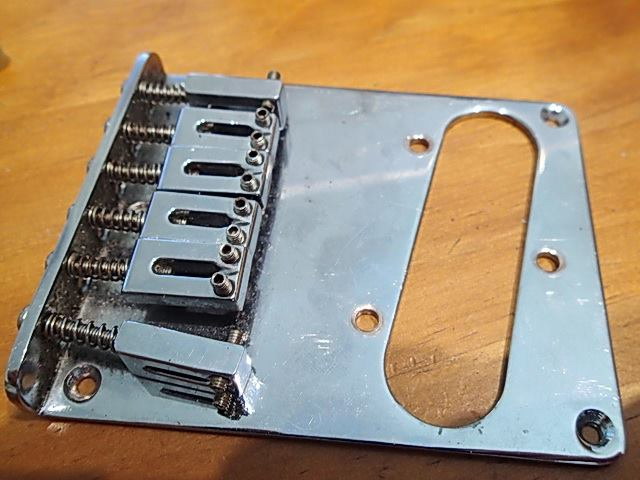

    OK I remeasured.
    The distance from the front of the nut to the middle of the 12th fret is 313mm, thereby a scale length of 626mm.
    The above photo shows that with the Wilkinson bridge covering the plugged holes, the end of the PBG adjustment screws do not make it to the scale length of 626mm.
    The below photo shows that if I move the Wilkinson bridge forward so that the end of the PBG adjustment screws are roughly in line with the scale length of 626mm, the plugged holes are quite visible. It would also require a small amount of routing.

    Thanks Tony,
    As it is preferable to sit the Wilkinson bridge back far enough to cover the plug holes, I guess my question is, the saddles being all the way forward sit at about 629mm - 630mm which is about 3 - 4 mm longer than the distance from the middle of the 12th fret to the nut, am I going to have problems with intonation? I will only be able to lengthen the strings during intonation at that measurement.

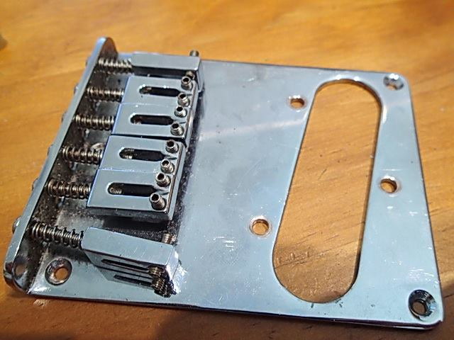

    Are you going to be able to bring the saddles in about 18mm .70 of an" so they measure at 648mm or 25.5" , mine on a squier affinity i did a bridge mod on, sit fully extended, as long as they intonate when you finger the 12th fret your in business, i have 1" of play between my saddles extended and the back of the bridge so you should do it easy if i am understanding what we are talking about haha
    Bubba mod is replacing the old saddles with new brass saddles on the affinity tele
    Out with the old
    In with the new
    Done

    Hi Andy, the low E string should be ok about 629/630mm from nut. The high E will have to be about 626-628mm.
    Worse comes to worse you should be able to get longer saddle adjusting screws.
    Place the bridge as close to the nut as possible to give you the best chance of getting good intonation

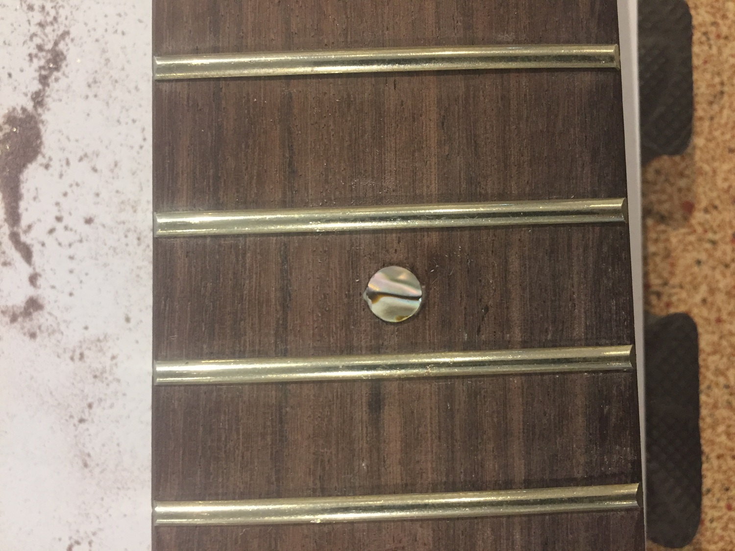

  10. #30

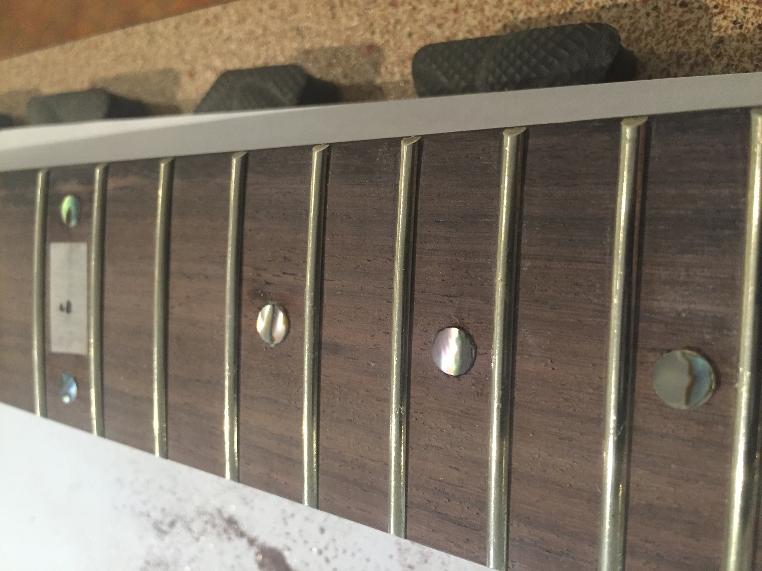

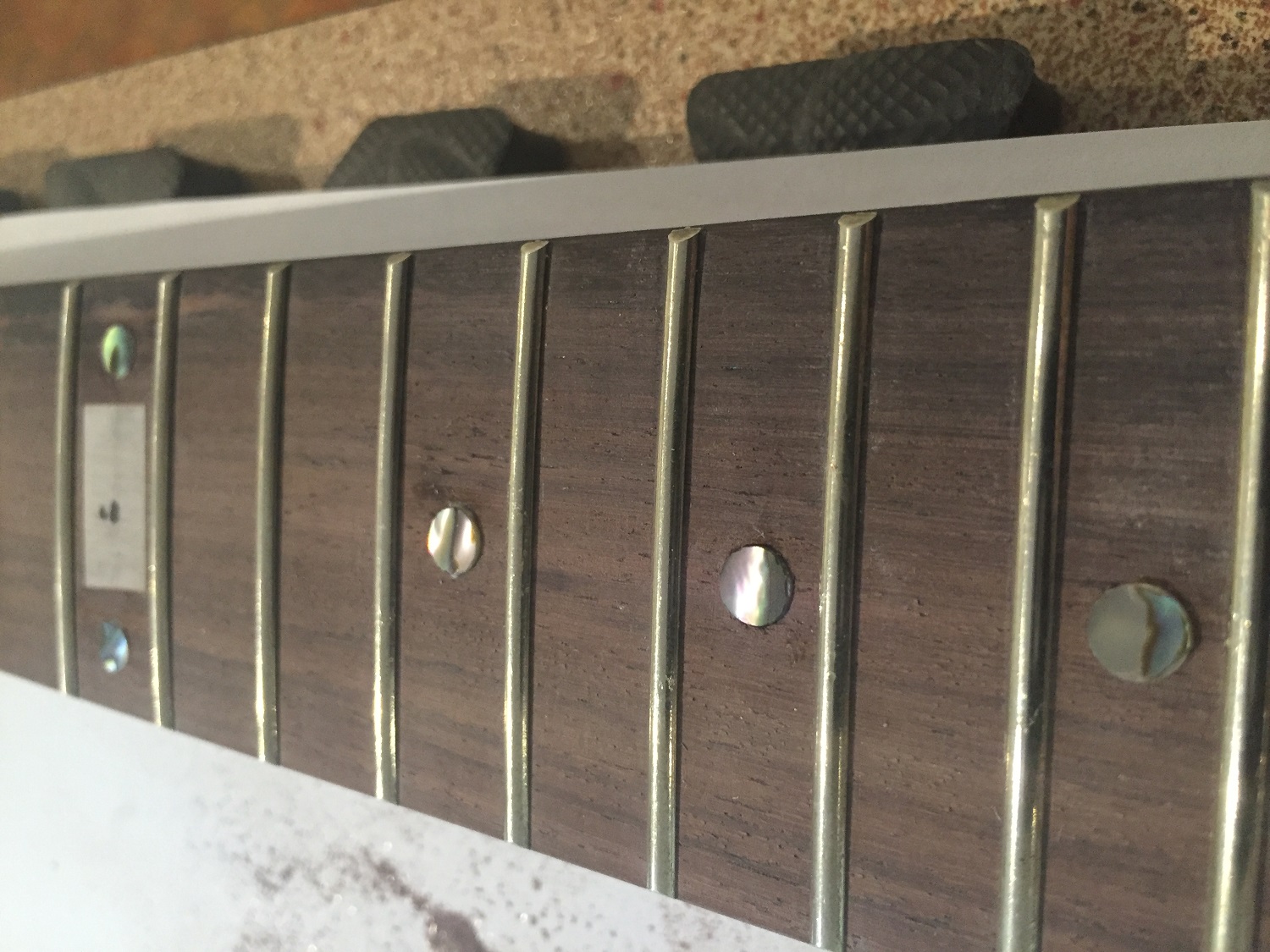

    Update
    MOP Inlays fitted and ready for sanding
    I saved the Eye of Sauron for the 15th fret

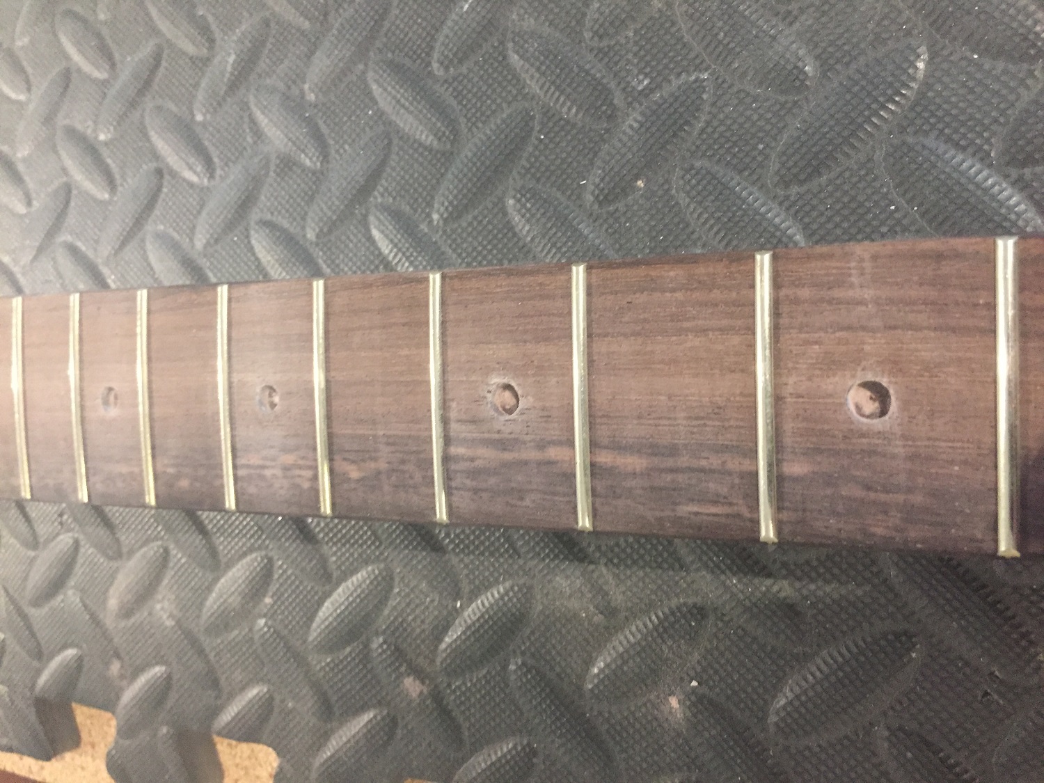

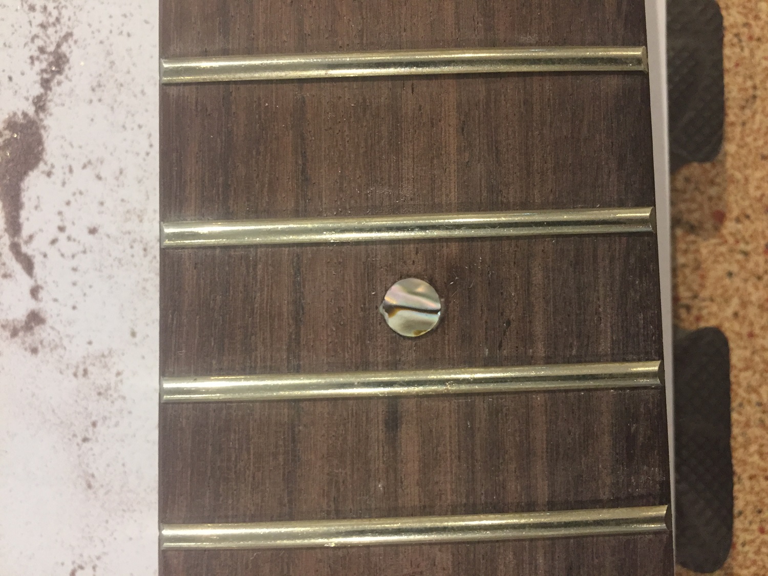

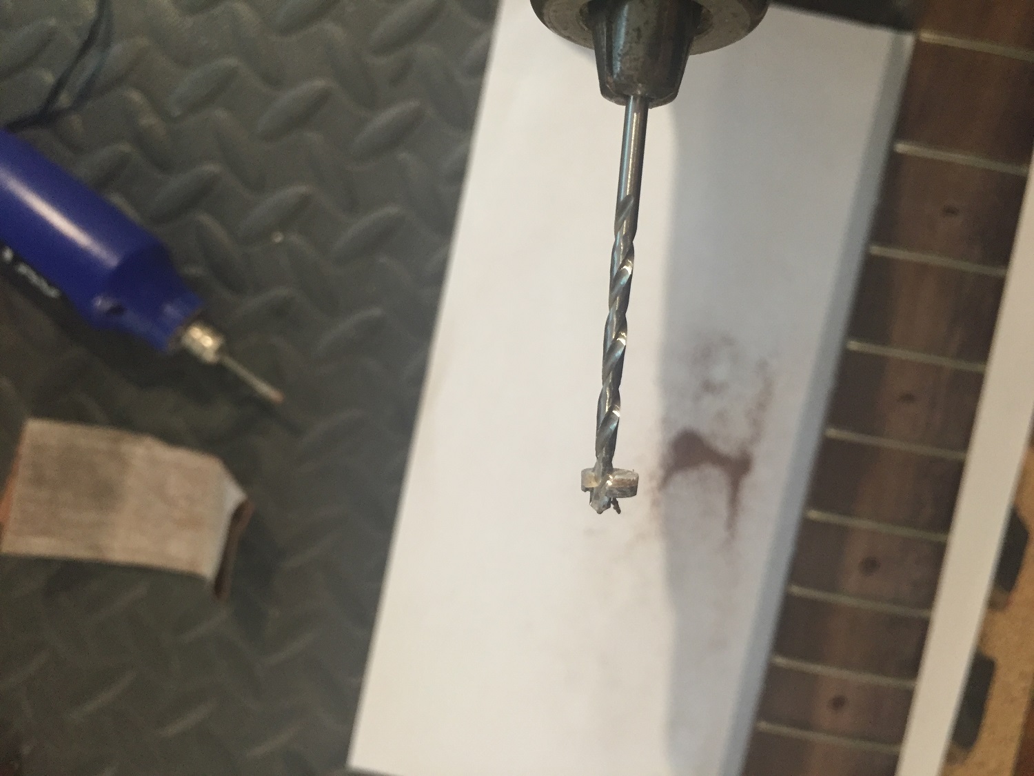

    I followed Brendans sticky, which was brilliant, however, here's a few things I learnt.
    1. In my brilliant foresight, I ordered one inlay more than I needed "just in case". High five past Andy.
    2. Brendan recommends drilling the middle of the plastic inlay with a 2-3mm drill bit then gently prying the plastic dot out. My inlays were absolutley caked in with glue, so it didn't matter how gentle I was I ended uplifting a small bit of the rosewood. grrrrr. for the rest I switched to drilling the middle of the plastic dot with the 2-3mm drill bit then gently on backward rotation, then upping the size of the drill bit (on backward rotation) until the plastic dot was gone - that only left the glue. I then used a dremel with the engraving bit (as brendan suggests) to rout out the glue and prep the hole for the MOP inlay.
    3. Dont, do not, never, push the MOP inlay into the hole to check your routing. It will N E V E R come out on its own, and all attempts to get it out only push it deeper. In the end, I had to drill it out, which did not bother me much because I had another one - hence the brilliant foresight I spoke of earlier.
