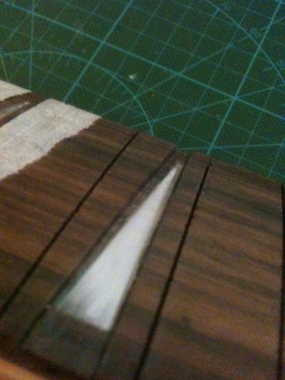

    Time to dremel out and 2mm CNC bit, taking care to not trespassing the lines marked with our previous saw cuts. I finally decided to put on a 1.5mm celuloid inlays (white, cream or MOP not decided yet)

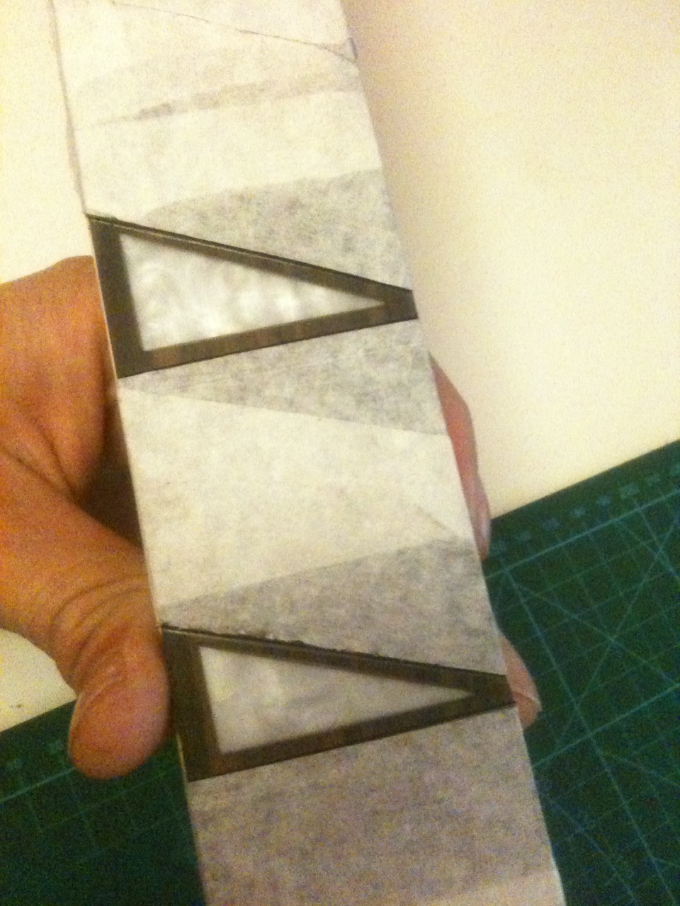

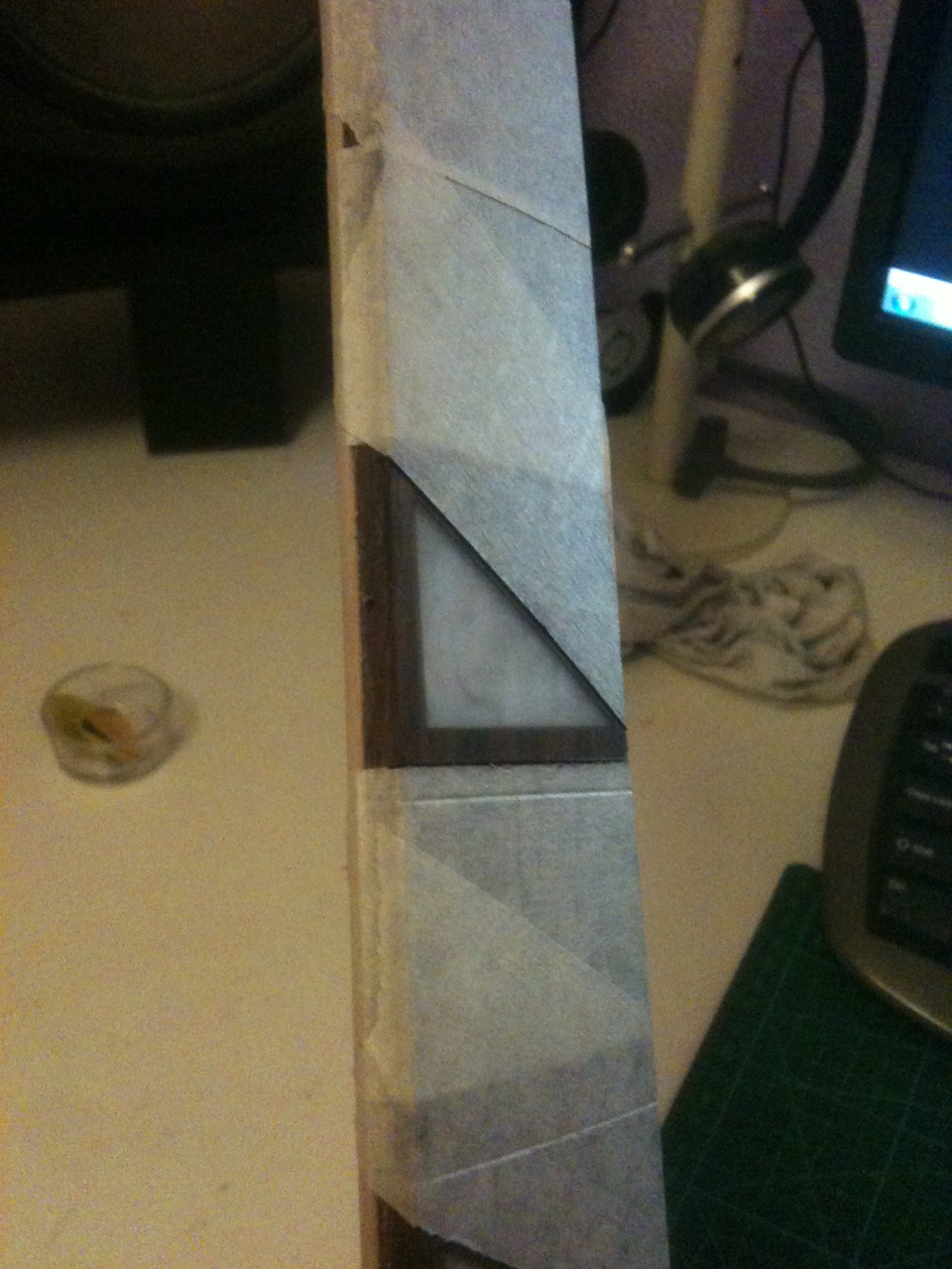

    Little advance on the fretboard. Got the pearl celluloid sheet (here named "nácar") and cut the triangles with a razorblade helping out with a ruler, 1, 2, 3 passes, and twist it a little bit up and down and....nice clean cuts...Sanding on a flat surface and we got it...
    Masking tape off...this is what we achieved with the saw, more clearly.

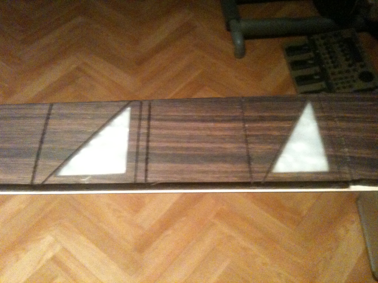

    A previous matching test...

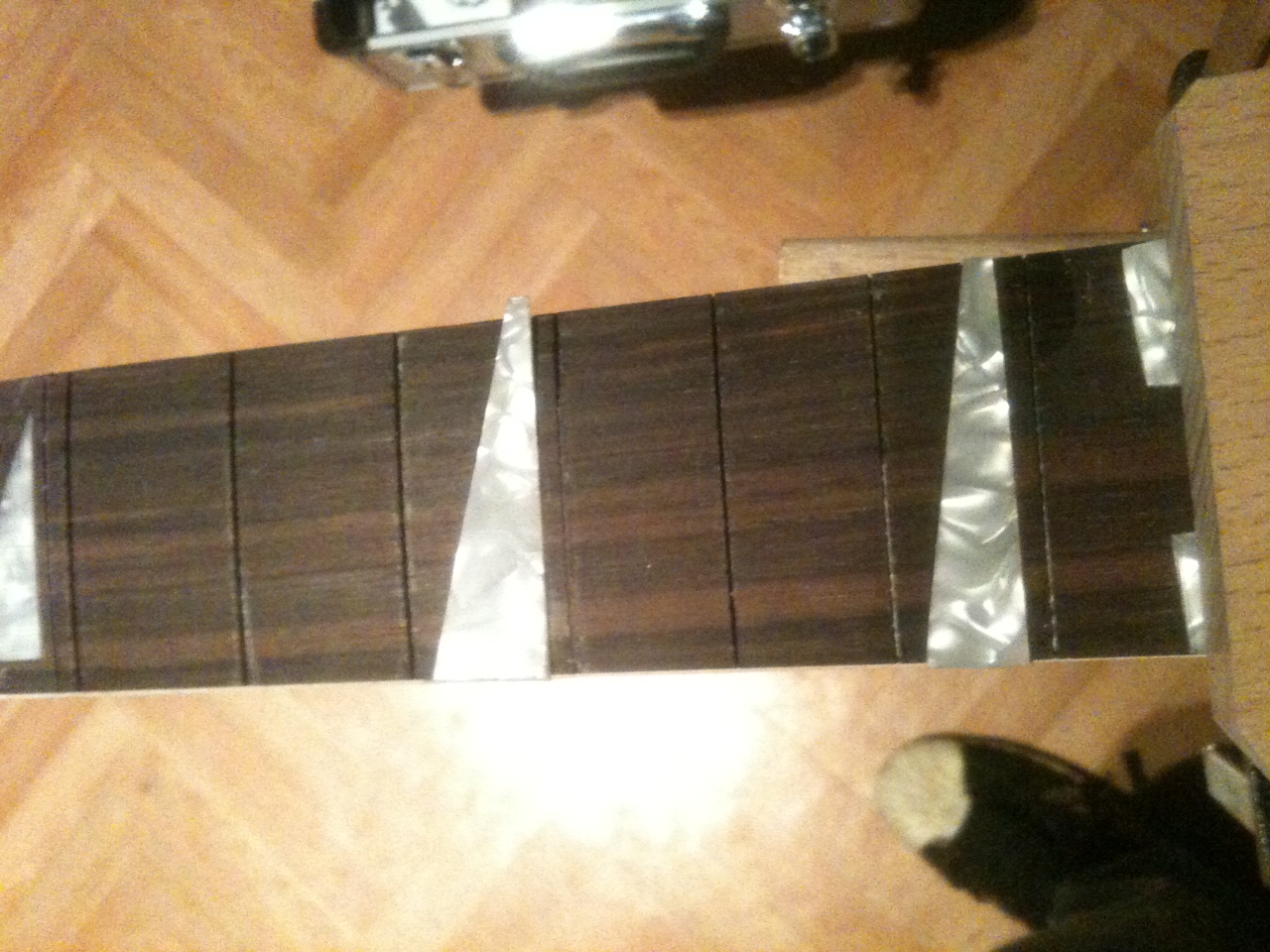

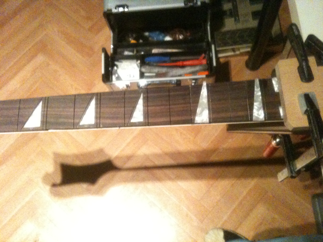

    As you know, sheet celluloid its so flexible, so you can dremel the holes directly over the radius fretboard. Then, better bend before gluing with the heat gun, specially more square ones. (3, 5, 7 ,9, 12 frets, not so much needed for 15, 17, 19)
    Fits perfect, so, epoxy bicomponent and clamps..

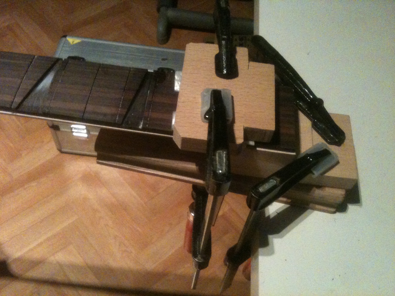

    Maybe not going to need any sides refill by how well it fits, but, we will see...
