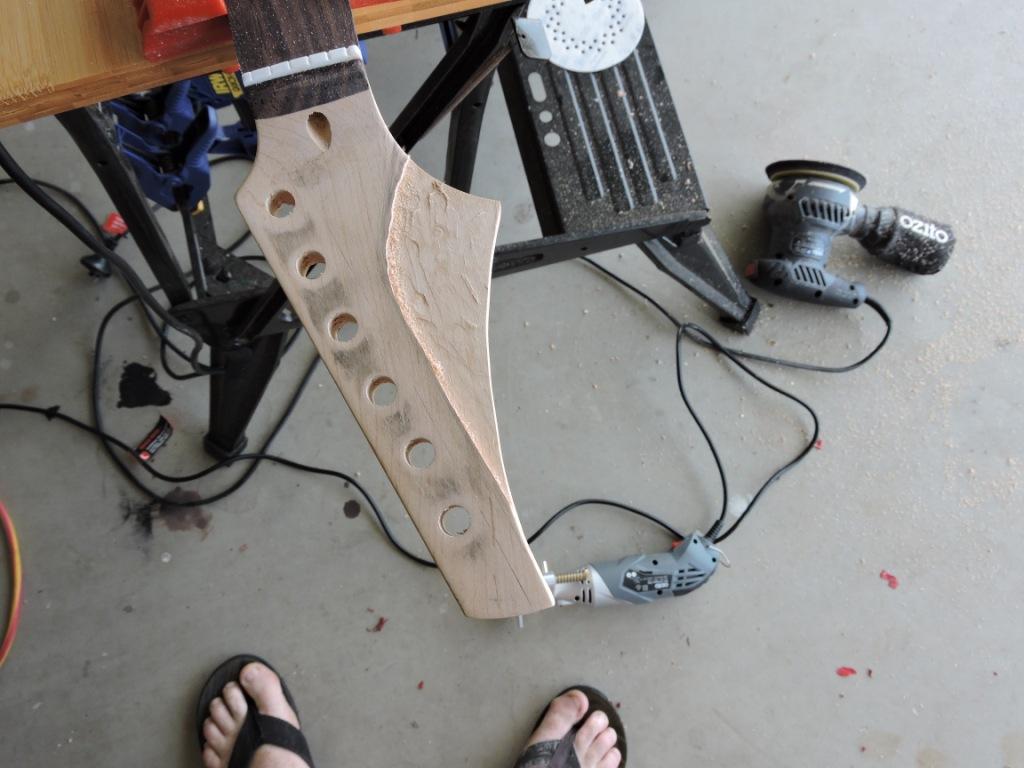

    So rough cut the outline and 85% shape of headstock before starting the routing of the step down with the trusty Ozito. Was a bit daunting and the depth is a little more than originally planned as the adjuster screws on the base come loose and the vibration altered the setting.
ID:	6374   Click image for larger version.
    Tony

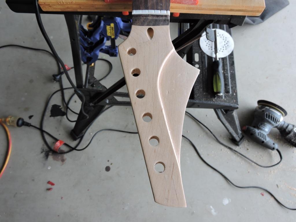

    So once had the majority of the freehand route done as close to the line as possible, used a sharp chisel as a scraper pulling the back flat edge to slowing bring to the curve I was chasing. Then sand , sand, sand smooth and with a slightly rolled top edge. Am actually glad that its deeper as will give a good near 2mm step above veneer.
    So now to try and cut some veneer to shape and then work out how to clamp. not sure whether to shape a clamp piece or try the iron method.
ID:	6376   Click image for larger version.
    Tony

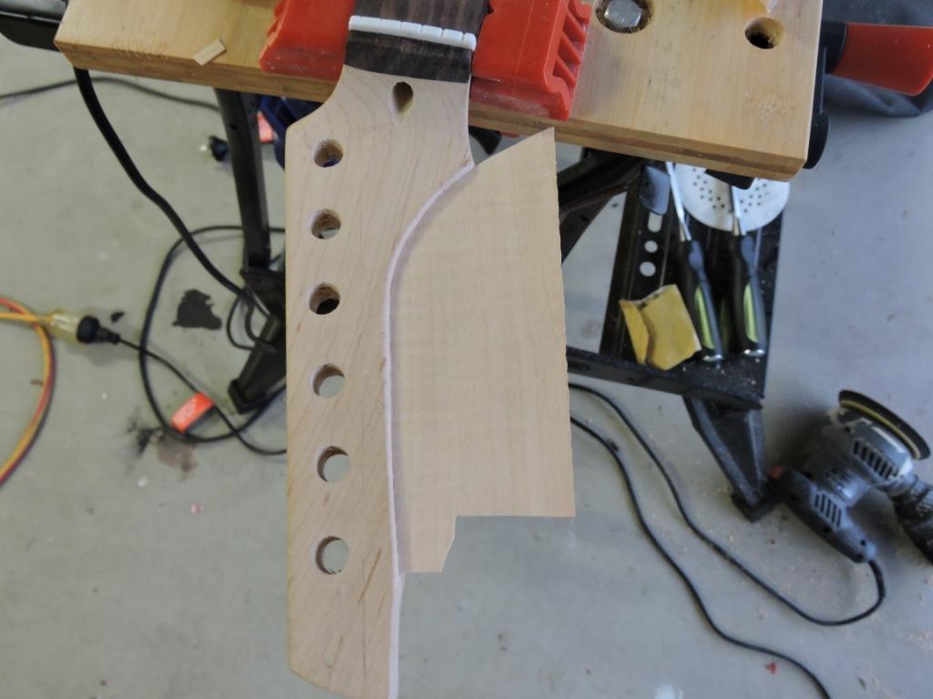

    Cut a piece of maple veneer to the shape and to make look a little more seamless, undercut the edge so the veneer slipped under the raised section of headstock. So now is glued and clamped.
ID:	6381   Click image for larger version.
