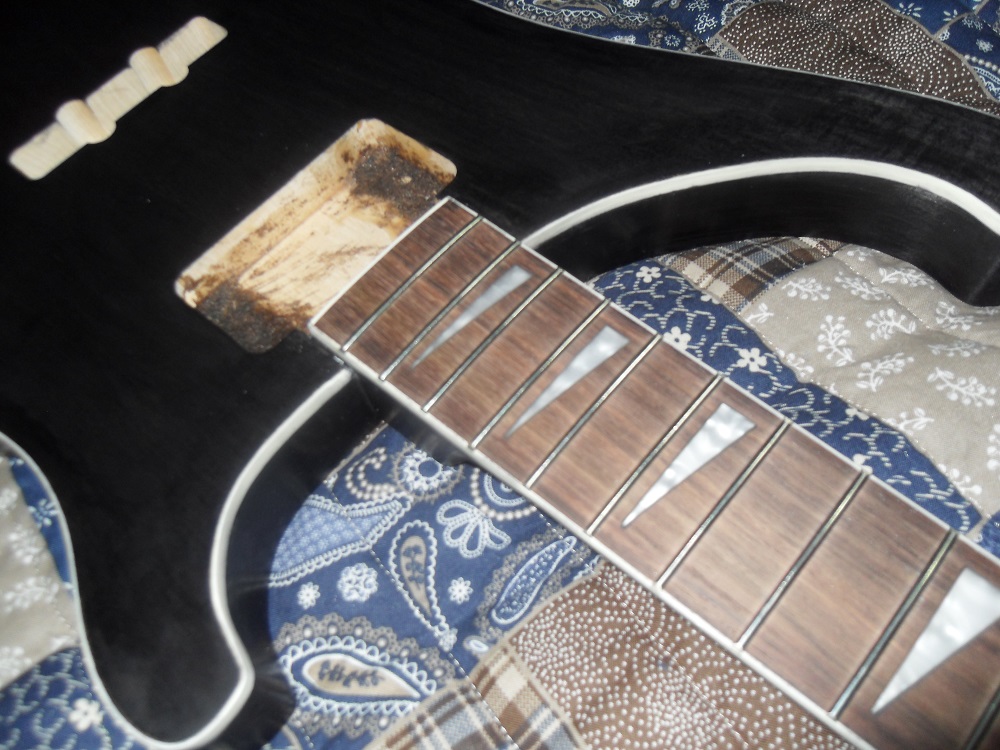

    Thanks for the comments, spent the evening giving it a rub down and another coat of Rustins Ebony, after it dried i took a Stanley blade and cleaned up some of the binding to body and neck.
Name:	SDC17981 - Copy.JPG
    Photographing the guitar is good for spotting stuff that won't show up under normal light but when the flash is used it helps highlight issues, Not happy with the neck splice on the head stock which shows a stark contrast in shades
    i will have to work on this to blend it a little better.

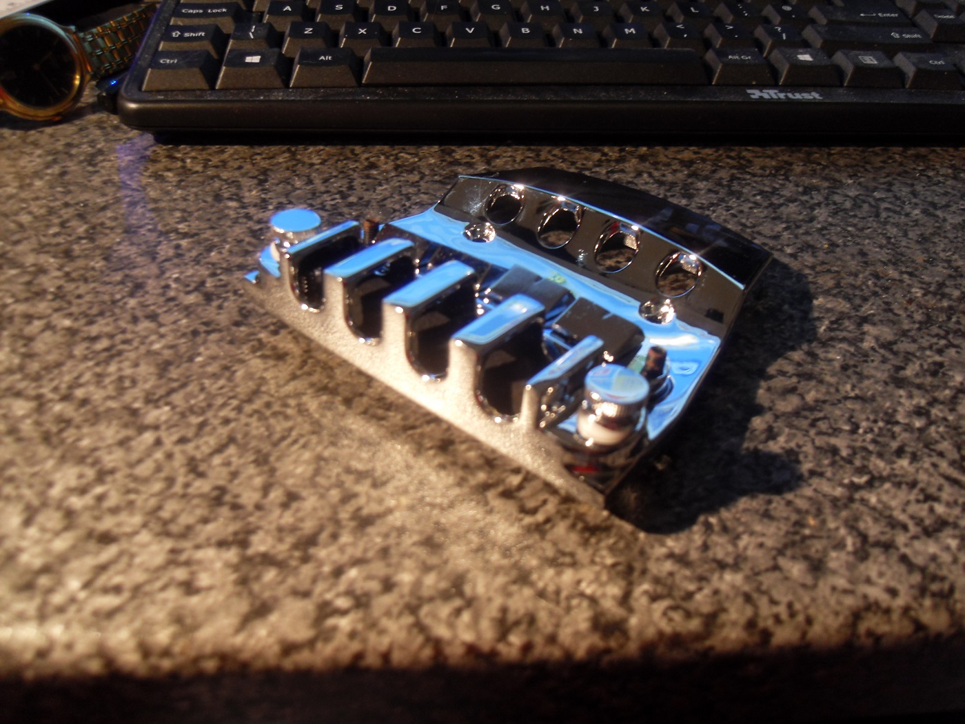

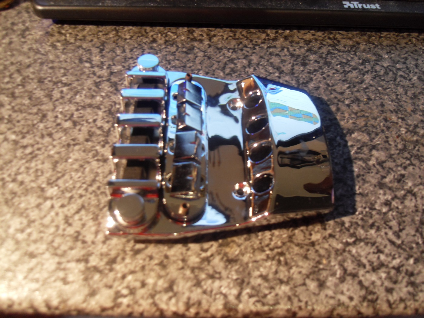

    Mail Call;
    Post arrived yesterday, Made in Japan, arrived via USA on eBay.
Name:	SDC17989 - Copy.JPG
Name:	SDC17990 - Copy.JPG
    Now that this has arrived i can mark out the body to rout out where needed to fit the tail.

    Nice bridge. I see you've already set the neck..... I hope your neck angle works out.
  11. #30
    Hey Paul, nice looking bridge, are these string through body or the string enters from the rear ?
    Before you do any routing to lower the bridge I'd clamp the bridge roughly in position and put your E and G strings on and check the string action to work out if you need to lower the bridge and roughly by how much.
    From memory Pablo's RC-4 build he had to shim the neck so the action wasn't too high ? He probably used a different bridge, can't remember
