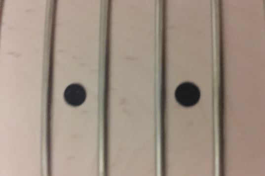

    I've added a (poor) picture of what the fret markers are looking like at the moment. They're basically just drawn/printed on so I am not too sure what to do about that since I want to put in the abalone ones I got.

    With the dot markers, you will find they are plastic so all you need to do is drill through the centre with a 4mm bit then they should pop out with a scribe or even the bit you used to drill.
    Then put a drop of super glue in the hole and press your Abalone dots in (assuming they are the same size as the existing ones)

    thanks for the help on the bone nut I'll look at those two options. Didn't get it from PBG found another site where I got the fret markers.
    The fret markers aren't plastic which is the issue they are just drawn directly on so i need to work out a way to create a hole to place in the fret markers that I bought but I'm not too sure how to do that without damaging the neck or if I should just not bother and just the leave the drawn on markers.
