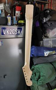

So the first steps:
Neck & Headstock
ID:	5945Click image for larger version.

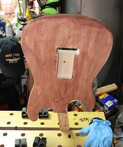

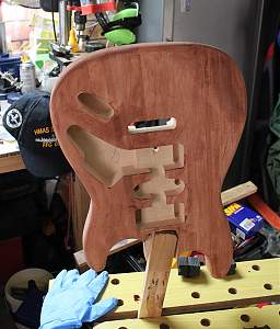

Body after staining with walnut stain diluted by 10 or 15% with water:
Name:	Front Stained 01.jpg
ID:	5947Click image for larger version.
Name:	Rear Stained 01.jpg
