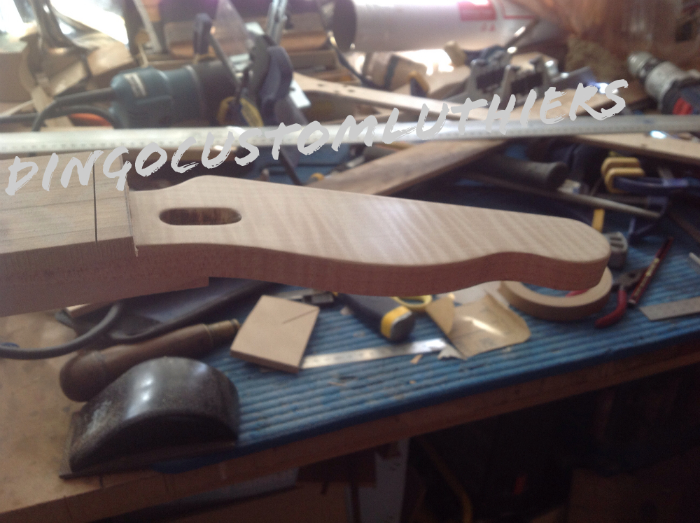

    OK, due to popular demand, here are a few progress pics of the Gavmiesters Bari neck.
ID:	5901   Click image for larger version.
  4. #24
    looks sweet as DB, has the headstock got some tiger maple veneer on it ? sure looks 'flaming' nice !
    so next step to trim the fingerboard ?
    you putting one of those cool truss rod covers on this DB to fit in the divot ?
    good to see at least 3 layers of tools on the workbench behind hahah
    plus your updates break up the thread jacks DB !
  5. #25
    Moderator dingobass's Avatar
    4,491
    Yep, it is getting one of my custom truss covers.
    Next up is trim and glue fretboard then radius, dot markers and install the speed humps.
    That is a peice of the flame veneer, happy with how it matches the flame in the headstock... Damn I am good
    Thats my workbench on a good day, you should see it when I am going fully sik!

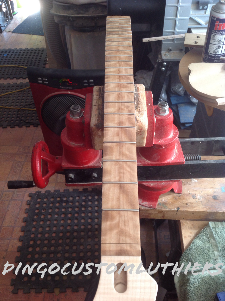

    Here she is with fretboard dressed, polished to 20,000 and speed humps installed..
    Now for fret level and dress, shaping and final touches.
ID:	5937   Click image for larger version.
    How good is this neck! Its going to look incredible with the body. Perfect match!

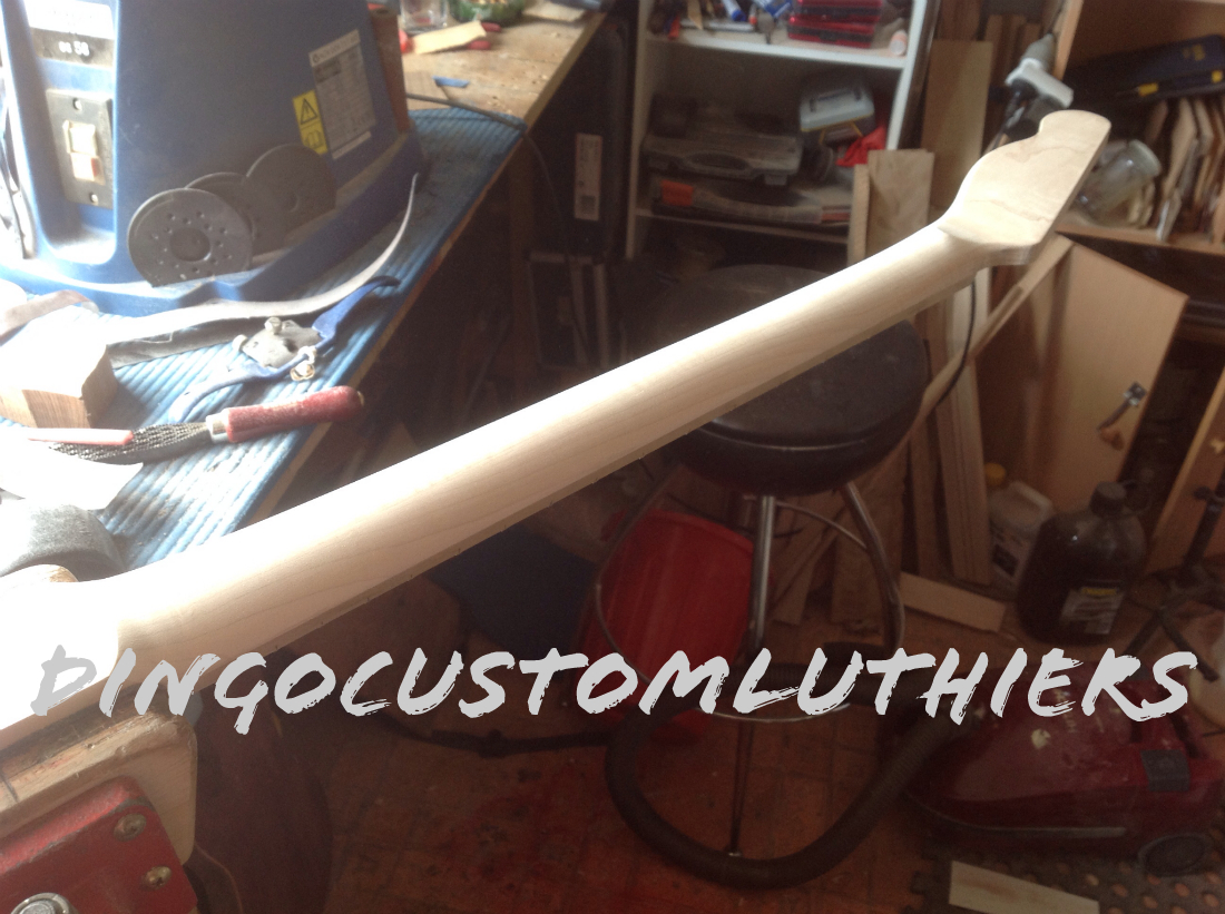

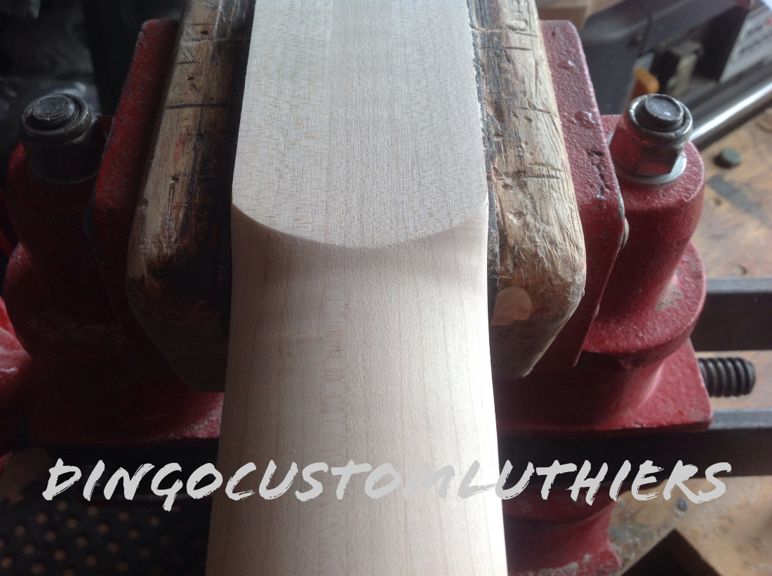

    Neck profile done!
ID:	5949   Click image for larger version.
ID:	5950   Click image for larger version.
