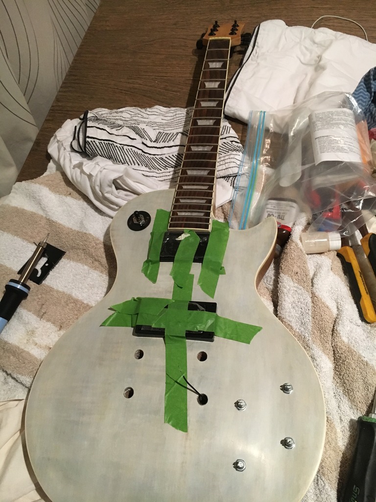

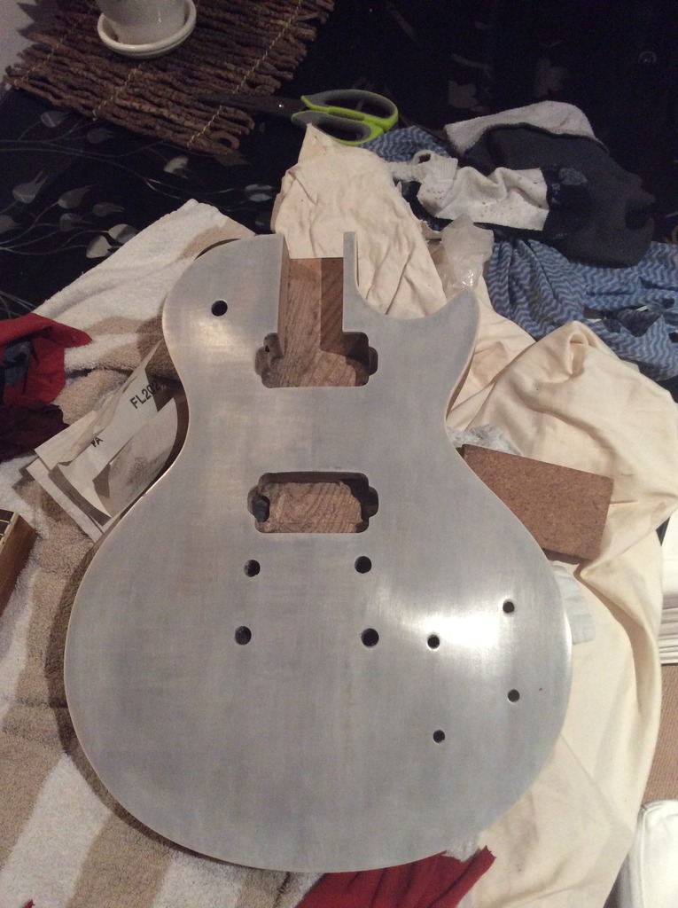

    Long time between posts. I've had a Barry Crocker with this, so have taken a breather.
    My thoughts on the top were to use Minwax pickling stain on the top, for a blonde\white look that you can see the black through.
    I applied the conditioner, then the stain. I just wasn't happy with the results at all.
    It just seemed too patchy. Maybe I was too impatient, maybe I made a bad decision, I'm not sure.
    This is how it came up. I was reluctant to keep going, as it was sitting like paint on the top, rather than soaking in.

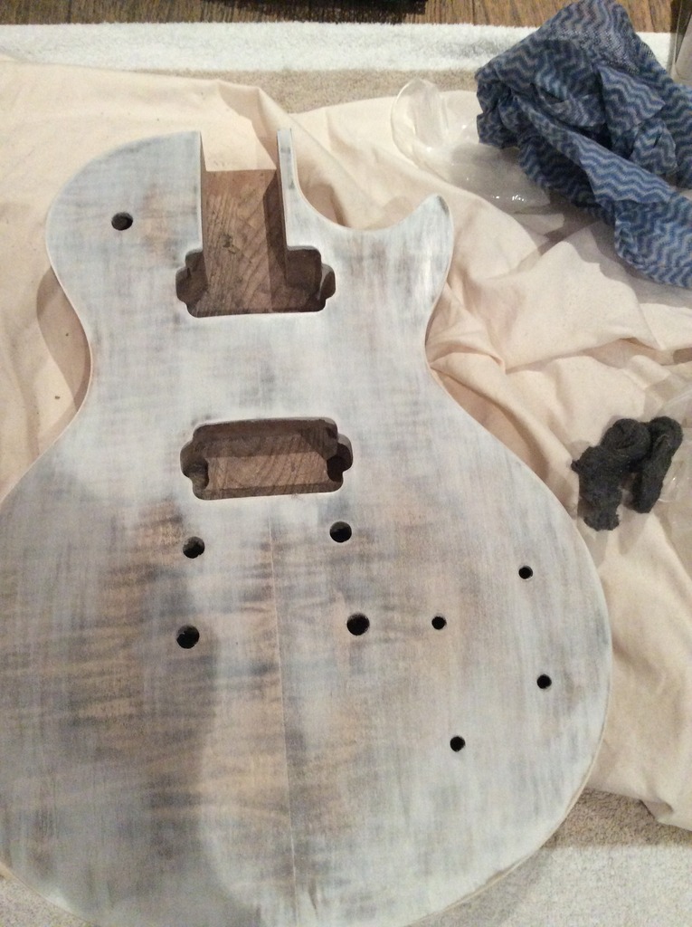

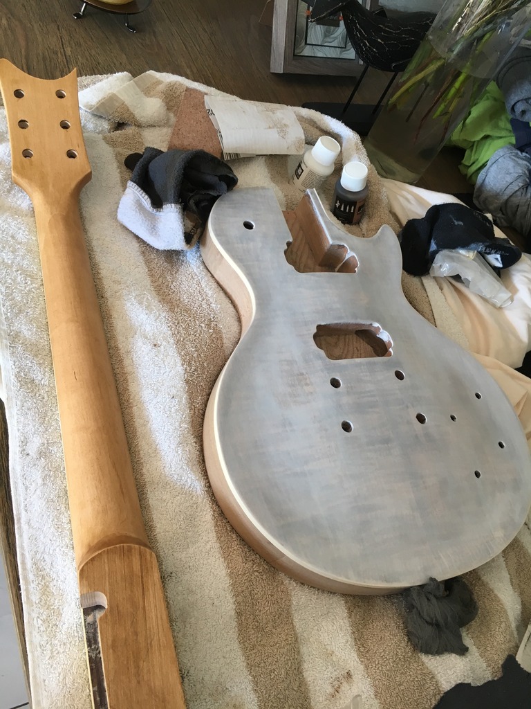

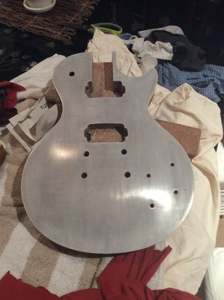

  4. #24
    So, after a lot of sanding to remove it all, I went again.
    There was some shreds of the white left (but not a lot).
    This time I hit it with the same ink as I had done the striping with, only white (because of the few bits of white left).
    Progress:
    It seems to have taken a little better, but still not 100% happy with it. I'm done with the sanding now, if I go again I'll be through the cap so I have to ride this out now.

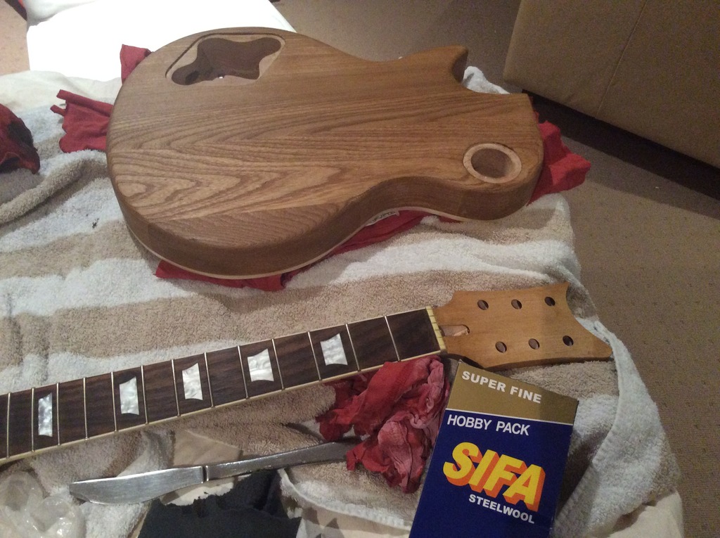

    Finished and with steel wool on the top:
    It's gone a bit more silver than white really, very surprising.

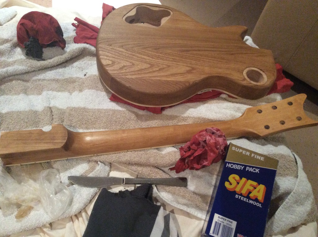

    Here's the back, I 've gone with a teak stain:
    I'm just going to have to run with it from here. The top looks to have tiny, tiny marks in there that look like they need something better than steel wool to smooth even more. Is there anything to almost buff it out with? It feels great, but the tiny marks are bothering me!
    After this I'm going to tru-oil (yep, a naughty word here I think!) for the finish.
    It came with the chrome\white kit default from PBG, but I think I'm going to go black accessories rather than what came with it. If I'd done a great job, I would have looked at some better gear, but I'm thinking the PBG black gear for 40-odd bucks looks a great deal.
  5. #25
    Sandman I really like that colour finish, its unique and I imagine it looks somewhat different in person. I agree with the Black hardware, you definitely need the contrast. But it looks a great job from this end of the internet! Good Save!
  6. #26
    I like it, I'd name it Casper.
  7. #27
    Only other colour option for the top would have been Teak all over but from memory it always looked a bit dark anyway.
    Good save and totally agree with black hardware accents.
    Don't worry too much about any slight imperfections in the surface levels as once you get several layers of TO down they should act as a filler and flatten things out. Also gives you something to wet sand smooth after about 8 or more coats.
