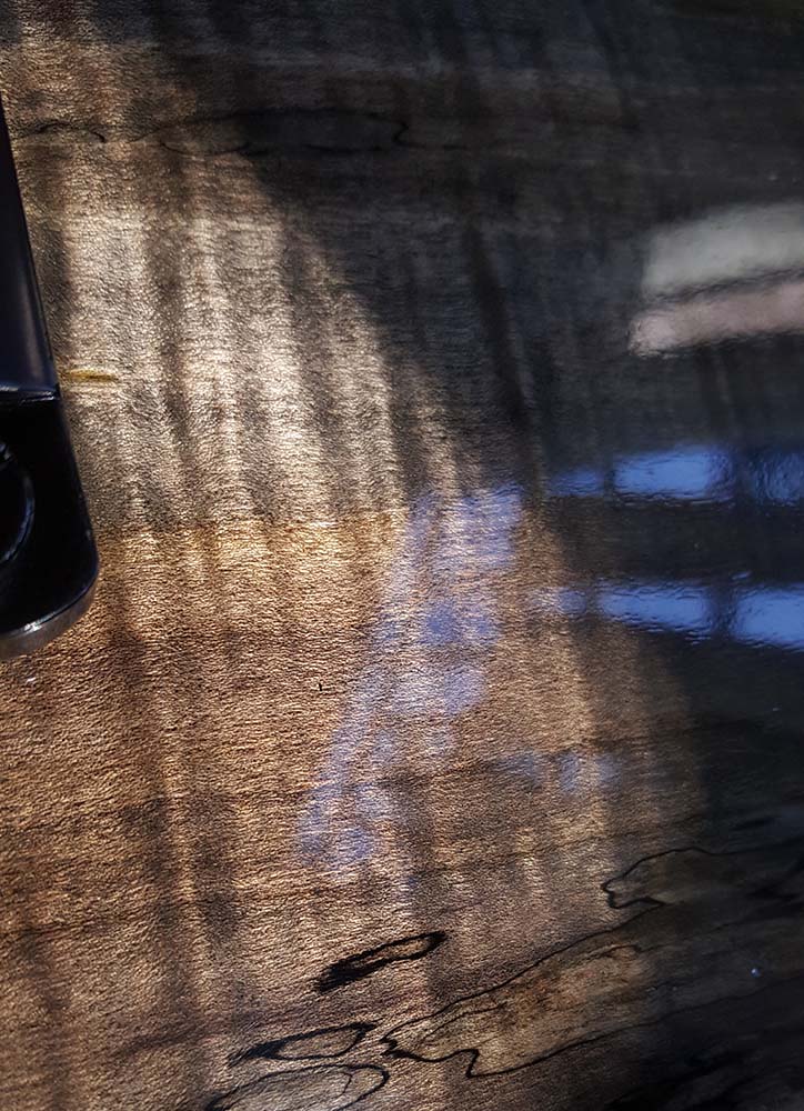

The wood is just plain awesome. Exactly what I was wanting. A little concerned about the tape marks on the top though. The veneer is super thin. Not sure how much sanding I can do to get rid of it... But, my plan is to use a chemical stain to age/grey the wood, and my fall back plan if everything goes wrong is to just go classic black lacquer anyway, not too bad. And I have been playing with different ways of doing designs in wood (other than just paint, like doing ammonia staining or wood burning and such...) so maybe I can just cover it if I can't sand it. There's always the microwave coil and baking-soda lightning...

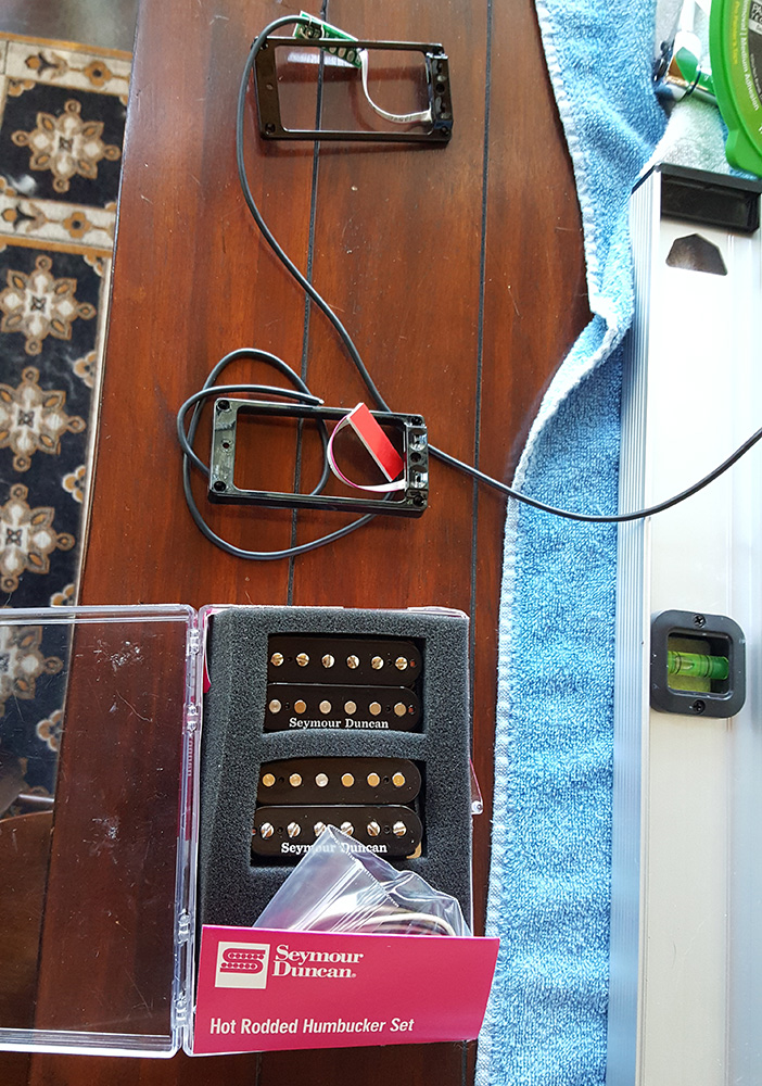

Did a dry fit of all the parts. Had a bit of a panic when the bridge humbucker sat waaaaay to high until I realized it wasn't the bridge pup but the neck pup... Duh. Have 2 concerns maybe you folks can help me out with.
