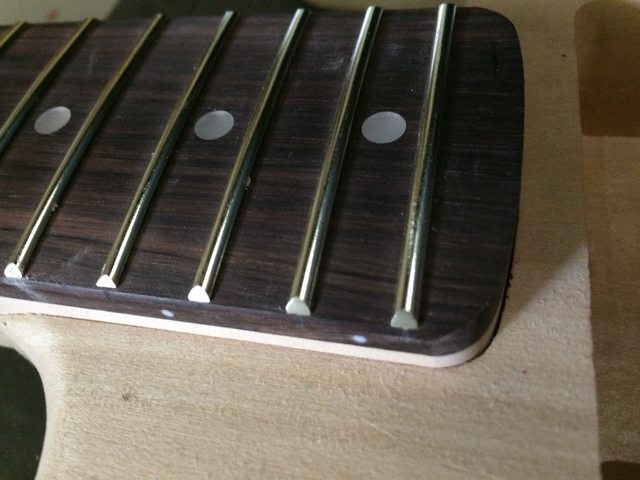

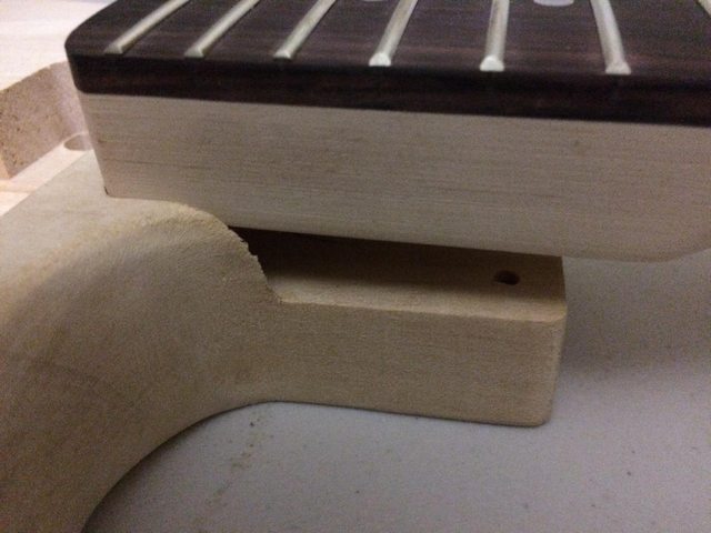

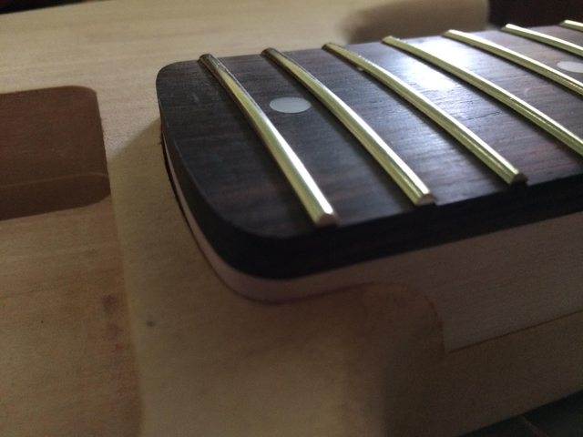

    So I got out the body and neck, check the fit and the scale, etc...
    Nup. That does not fit. No one has even checked that before.

    I don't mean it's tight. I mean it would take a hammer and then it would never come back out again - or break.

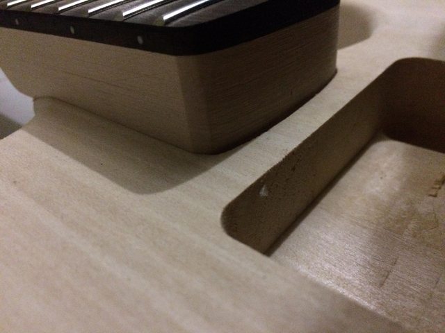

    Doesn't even really match the same shape curve at the end.

    The tele kit I got from elsewhere as my first build had an impossibly tight pocket so a bit of careful sanding on the sides of the heel of the neck got me a good firm fit, also gave it a bit of a touch around the end of the neck to sort the misfit there as well.
    The STA-1 was loose but not too bad so I lined the sides of the neck pocket with some copper shielding tape which tightened it up to the point I was happy with it.
    I'm wondering if the problem is actually the corners of the pocket. If the curve matched the heel better the whole unit would move in a mm or so and the sides may well fit properly.

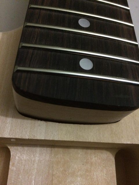

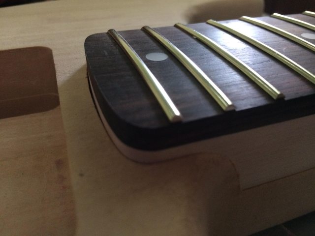

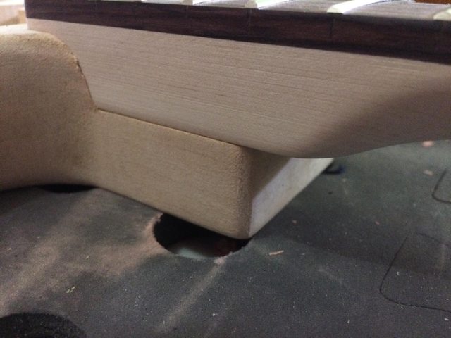

    So I couldn't check other things like scale length, tremelo position etc without making the neck fit.
    I sanded the corners of the heel carefully to make them as closely shaped to the round corners of the pocket as I could. When I started they were quite angular.

    Now it fits quite snugly into the pocket. I can move on.
