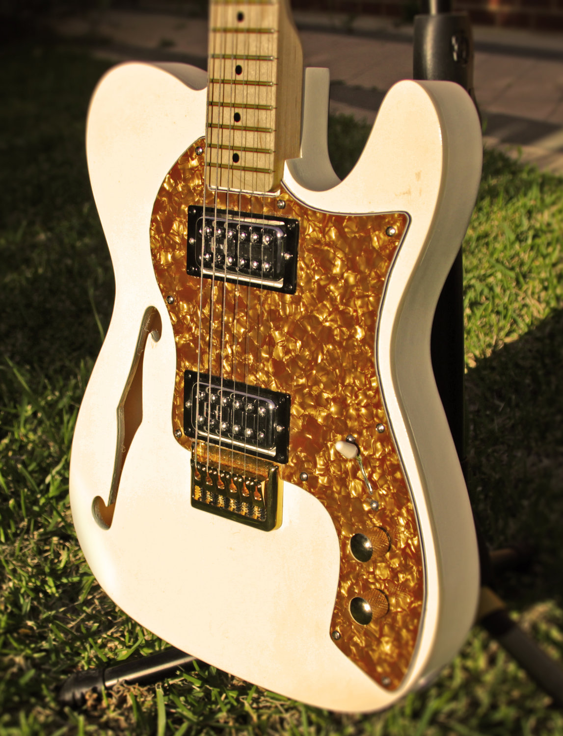

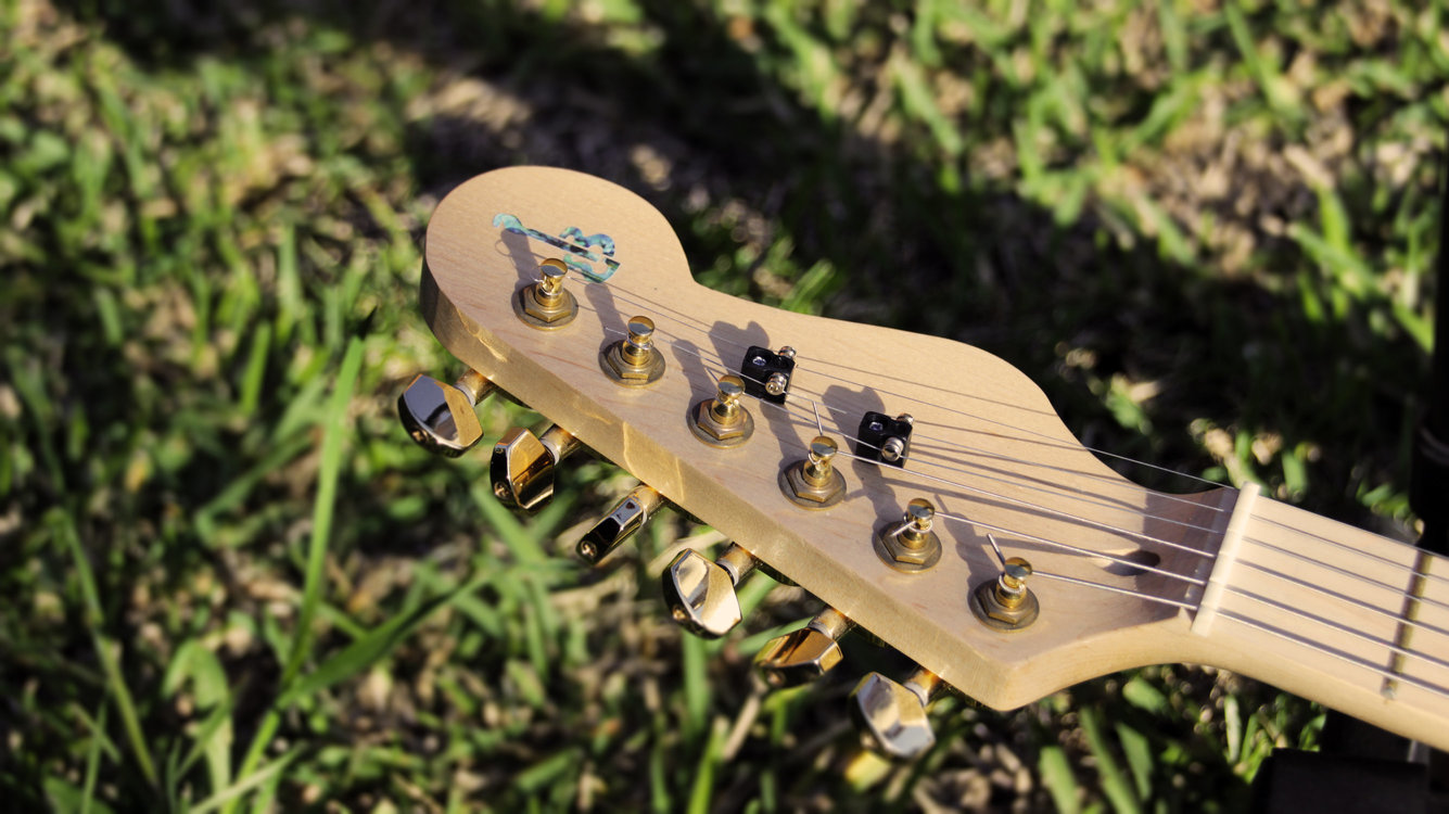

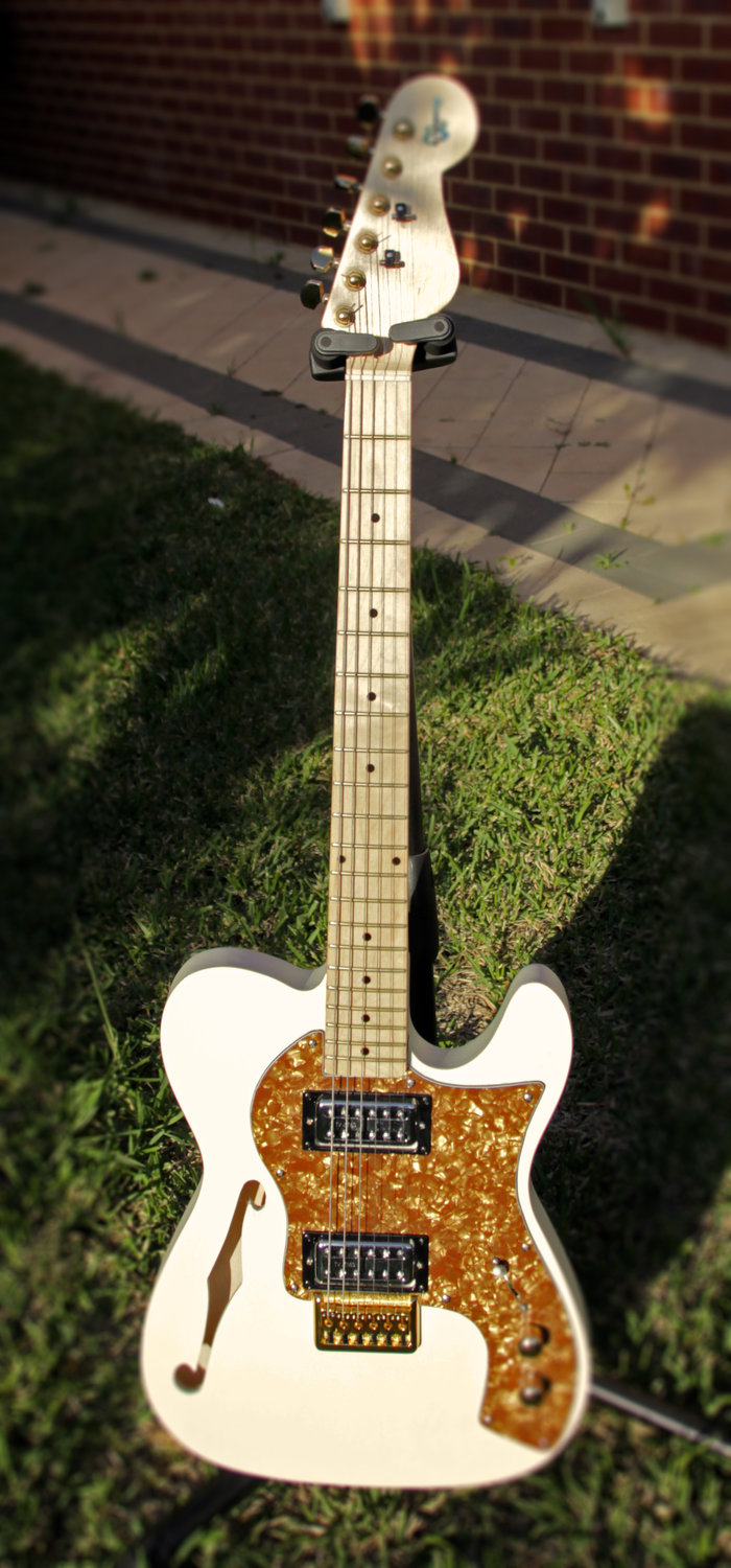

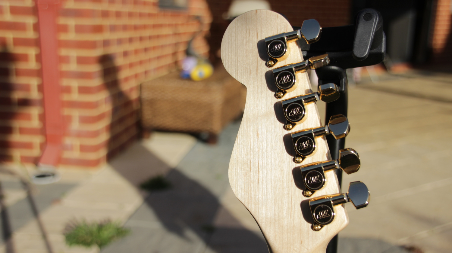

    Fender Thinline Entry because I know how much Adam loves a tele.
    There has been a fair amount of additional work go into this baby. Apart from the typical sanding and such I thickened the 'f' hole by adding a 3mm depth to the existing hole. This allows the body to look thicker and appear more like the real McCoy...err F-Style.
    I have upgraded the tuners and the bridge with gold bling, knobs and pickguard which was made from scratch using a template that i learned how to make from our forum!
    Have intonated this as you'd expect and positioned my logo on the headstock (logo courtesy of Andyport).
    I was determined to put TV Jones pickups in this guitar but was unable to source gold ones from my second favourite guitar shop on the planet. So chrome ones have been used as the sound was paramount.
    The tuners are Wilkinson and i have used two trees on the strings which I picked up at Realtone.
    To complete this baby the switch is a four way. So we have bridge, bridge and neck, neck and finally va-va-voom which is the neck and bridge in series.
