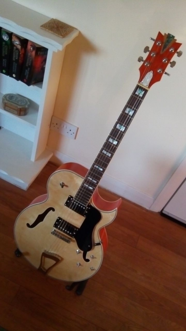

    After lots of time spent with spray cans and sandpaper, I've finally got a nice finish. I stuck with polyurethane varnish, and I'm quite happy with the gloss, and it should be pretty tough.
    I've glued the neck in. Quite scary in concept, but in practice it was really easy. Everything lined up perfectly straight out of the box! I used my ancient drill press to push the bridge inserts in, then I used fine cotton thread to make final checks of alignment. The kit was spot on, perfect, and just needed glue and clamping together. I've fitted all the fiddly bits, lined up and fitted the pickups, and all the pots and wiring. Putting the pots in is really awkward and caused several expletives to be expressed at a volume my amp can't reach! I've still got to string it, but I will wait another day until the glue is properly hard, and once strung, I'll post some photos.

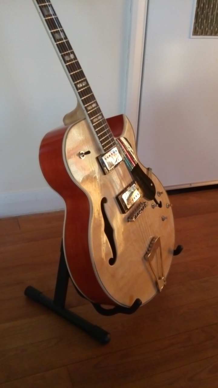

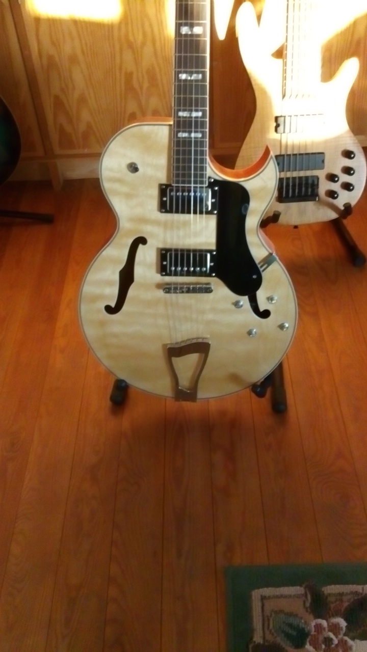

    So, here she is! Click image for larger version.

    Member Dave Easter's Avatar
    Jul 2015
    UK
    33
    Still a bit of fiddling to do, a bit of fret buzz to sort out, and intonation is close, but not quite right, but it all needs to settle overnight. Oh, and I forgot to put the knobs on! The jack socket sticks out too far, but a washer or two will fix that. The best surprise was the gorgeous flame effect in the wood. I just didn't see it while I was working on it, but once I had a good gloss, it jumped out at me. This is by far the best kit I have done, I love it and I would recommend it to anyone. At some point I will go back and put a real inlay on the headstock, to do the fretboard justice, but this will do for now.
