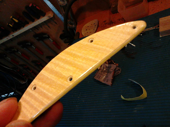

    Banned bargeloobs's Avatar
    Mar 2014
    1,700
    Quote Originally Posted by Ben1902 View Post
    okay I can get them to make it thicker if needed. the plastic idea may work i will buy enough to try a couple of ideas.
    It definitely works coz I've done it. From memory my veneer was 0.6 so not much difference really.

    might work Barge, I've never glued veneer onto a plastic pickguard.
    Ben you need the pickguard at least 3mm thick, its got to be strong enough to drill holes to support the neck pup and for the mounting screws on the outside
    Ben if you don't have alot of scroll saw experience I'd try and glue the 0.8mm thick veneer onto the plastic guard.
    Worth getting the timber company to cut some 3mm thick so you can have a crack at the pickguard all timber from scratch
