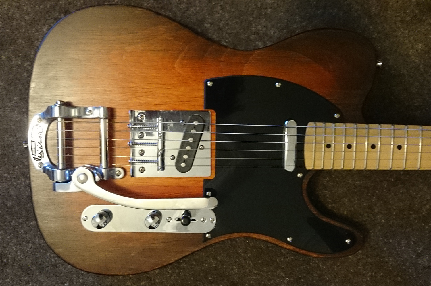

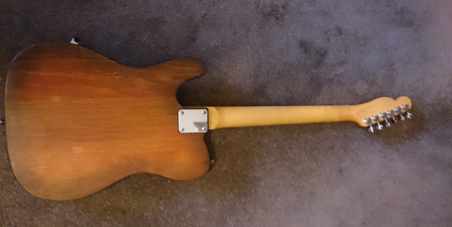

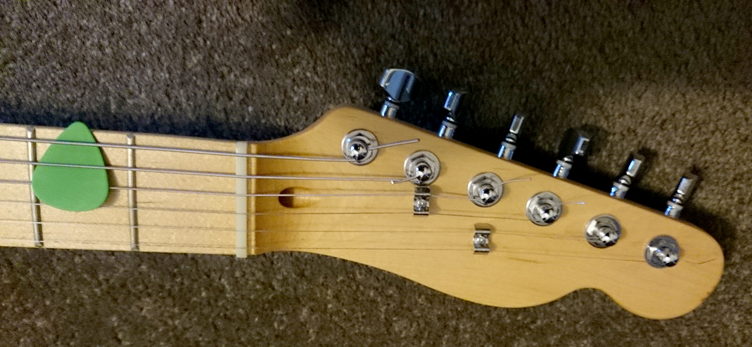

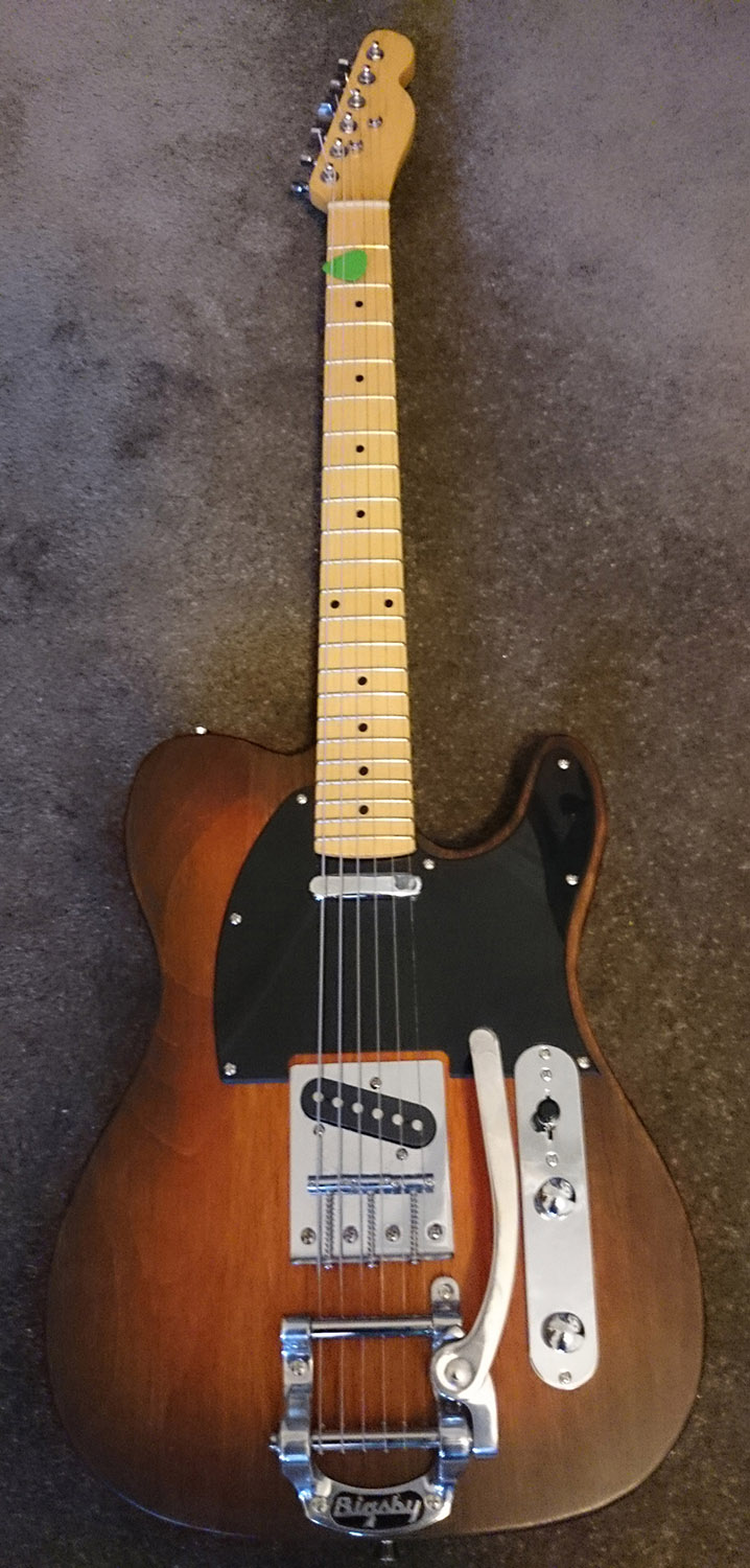

    Hi all,
    Here's my first entry for Guitar of the Month, its my second build, but I'm still tinkering on the first...
    It's a standard TL-1A kit, with a bone nut and the added Bigsby B5. First time trying a sunburst, which was a combination of the Dingotone Outback Sunset and Blackstump finishes. Went with a matte finish, which I'm super pleased with.
    Very happy with how it's turned out, and sounds great. Will eventually upgrade the pickups, but need to do a bit of saving first...
    Attachment 4660Attachment 4661Attachment 4662Attachment 4663
    Great Tele Tom, you've got to be happy with that. Love the burst

    Hey Tom,
    I reckon that's knocked me right out of the running - well done!

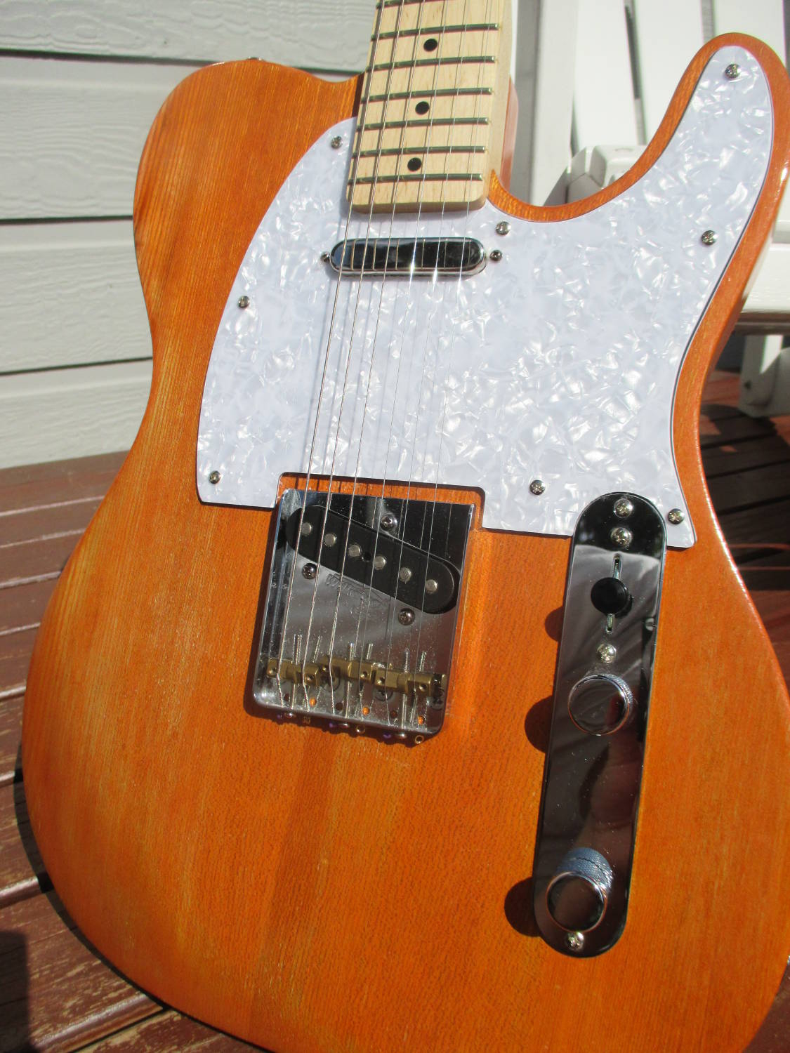

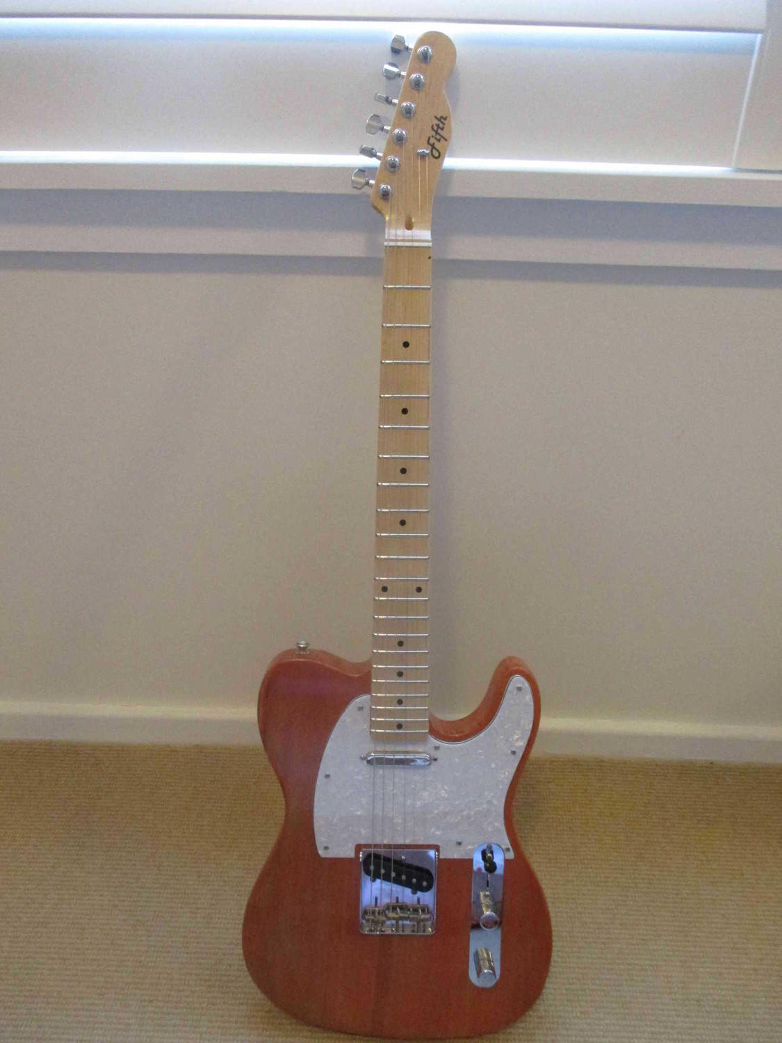

    Tla-1
    Finally got this one completed. TLA-1 kit neck, body & pickguard.

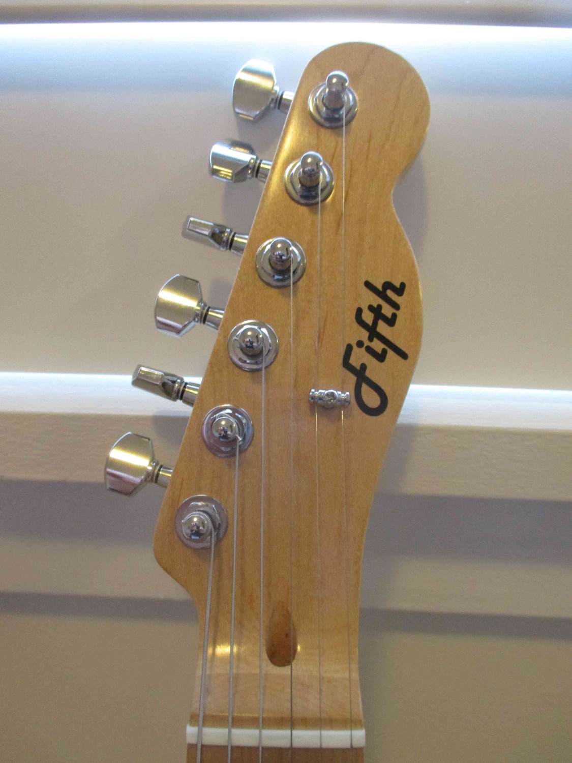

    From top to bottom: Gotoh SG381 tuners, Gotoh string tree, bone nut, frets levelled & crowned. 3x coats of TO on neck/fretboard. Neck has a very slim shim at at the head stock end of pocket (about 1/2 credit card depth). 'Fifth' logo - this was my 5th build....

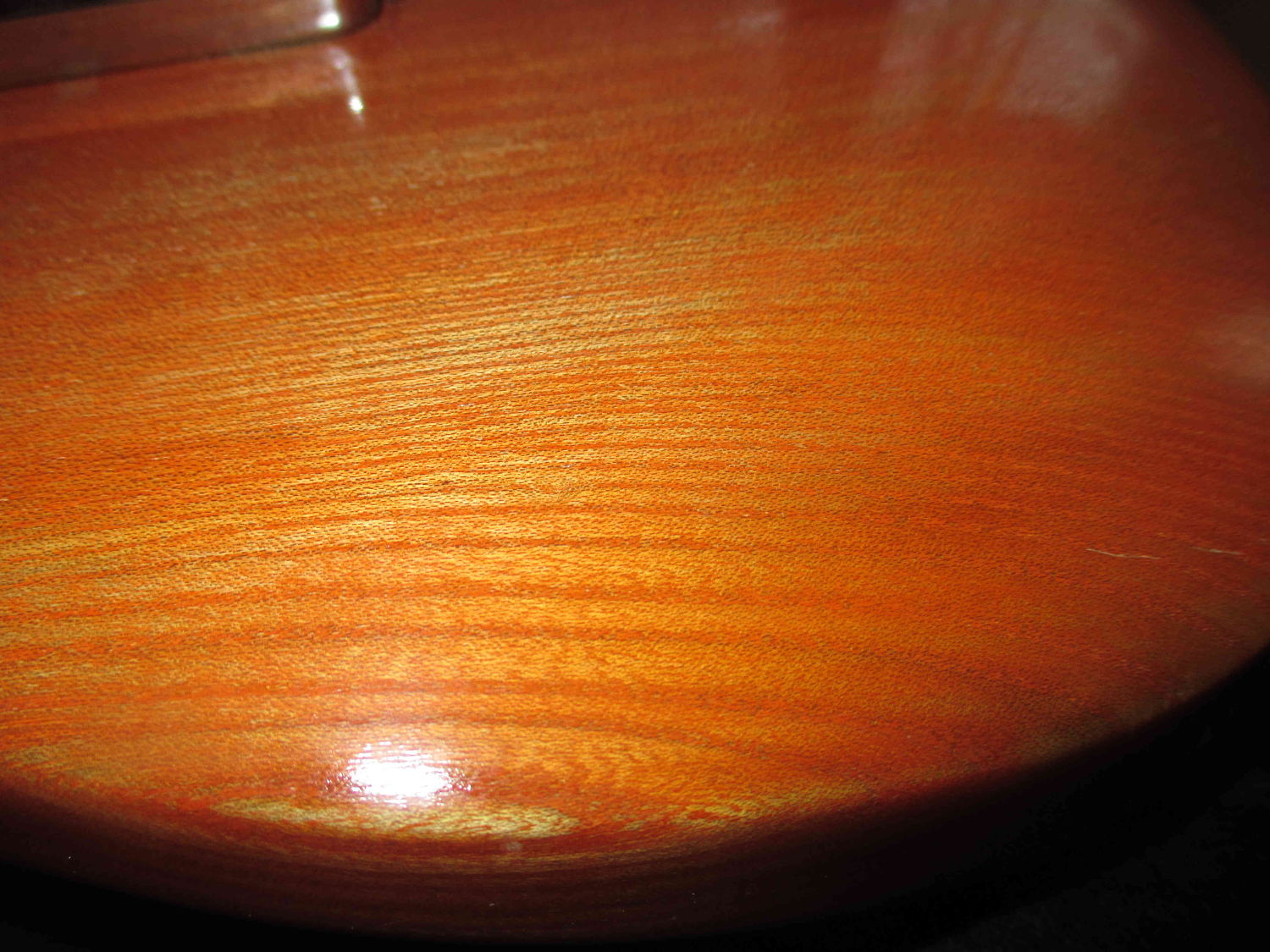

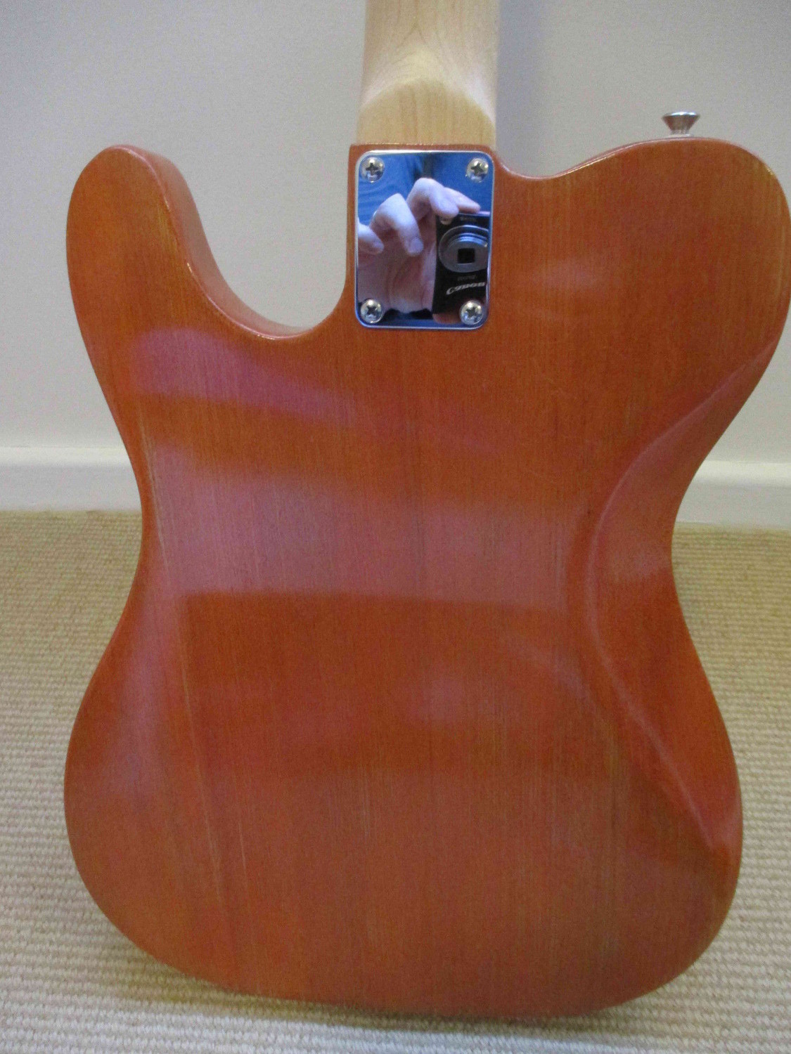

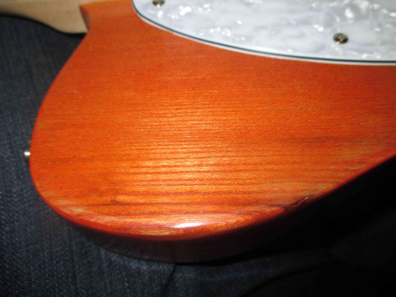

    Body: Dyed with Dylon 'Goldfish Orange'. Grainfilled with a light Timbermate (I think maple?) with 4 coats of TO. Pup bridge: Tonerider hotclassic. Bridge pup from a F*r standard Tele. Bridge: Wilkinson compensated. Input jack - modern US style. US Tele spec electrics with tone bleed mod. Neck plate from Realparts. Used good chrome quality screws.
    Body has a tummy and arm cut.
    Hard to capture this in a photo in light and with low-resolution upload. There are a lot of gold highlights that do not show up face on.

    And some sunny/close-ups of the body.
