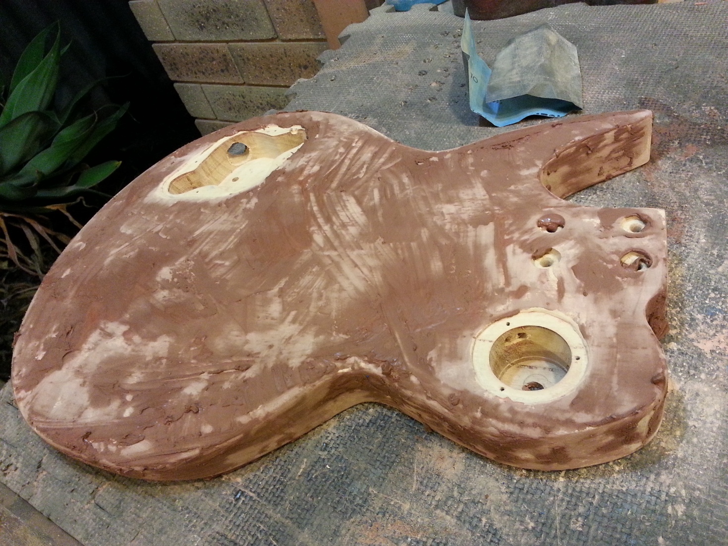

    got all the holes drilled between cavities on the weekend and did a bit more shaping. Applied walnut timbermate, looks like a mess in the pic. Will sand it off tonight and see how it looks.
    The marri grain is very coarse and the dark line grain are like a little channel. I wanted ebony timbermate but the green shed had run out !

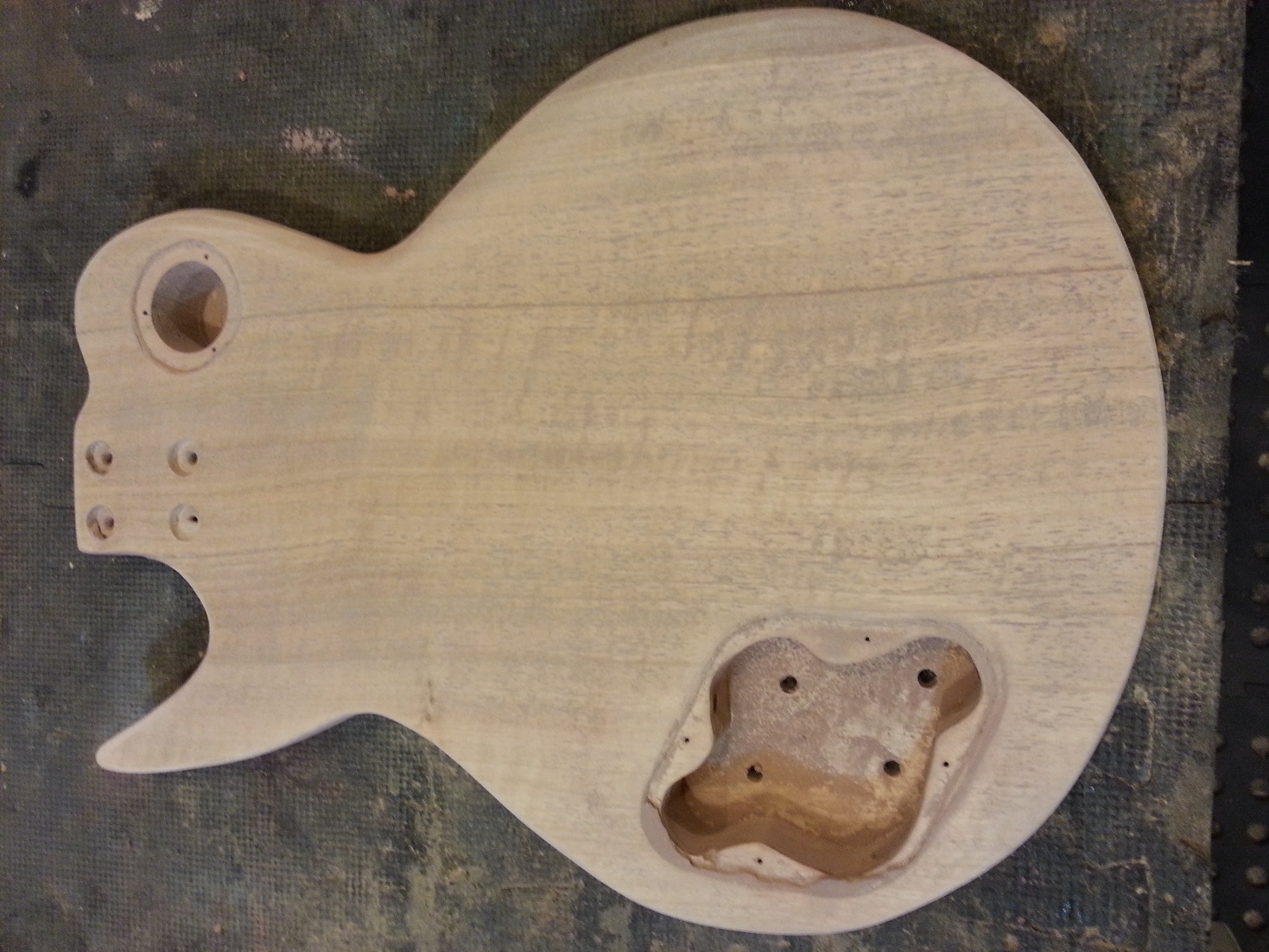

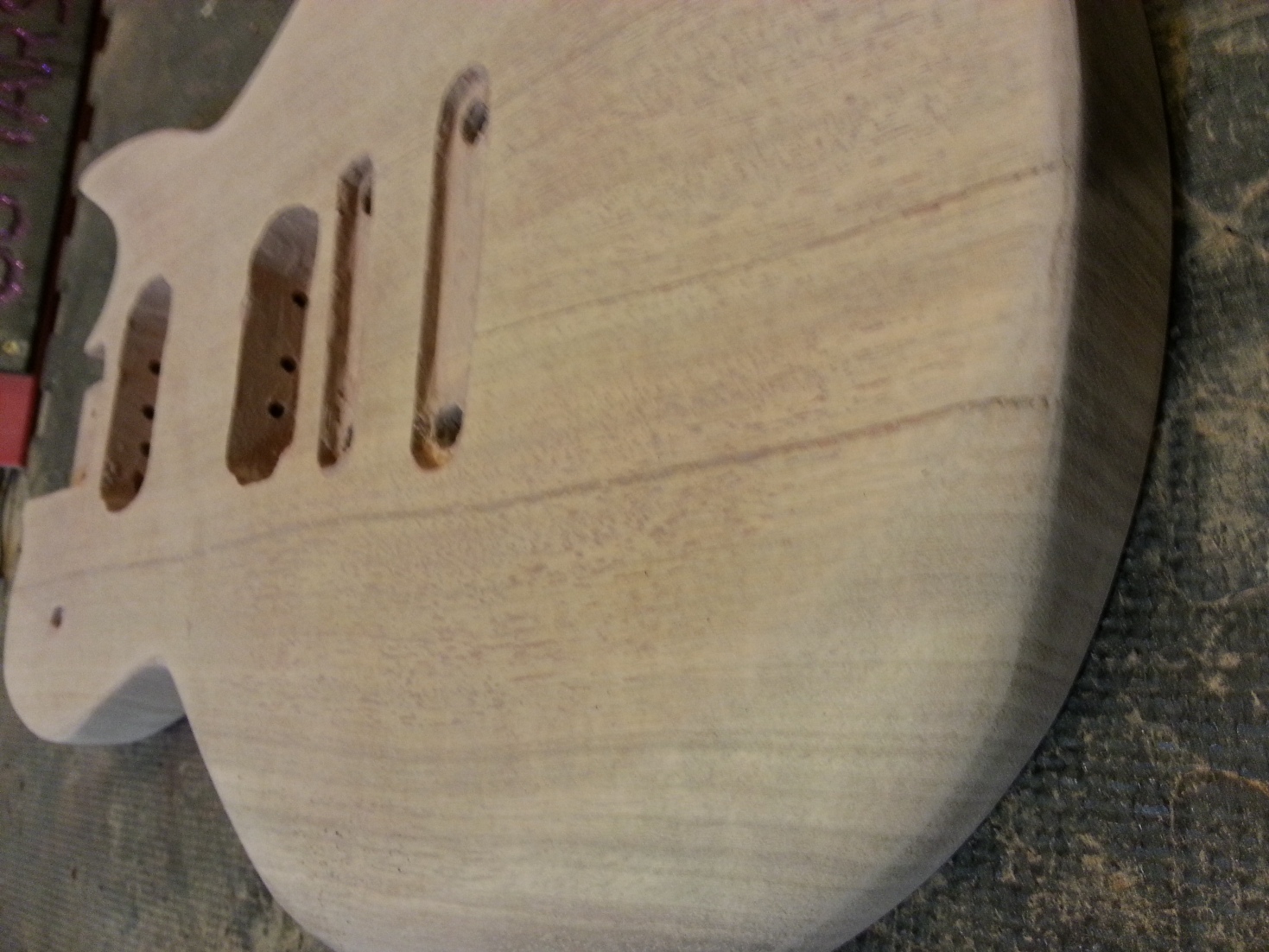

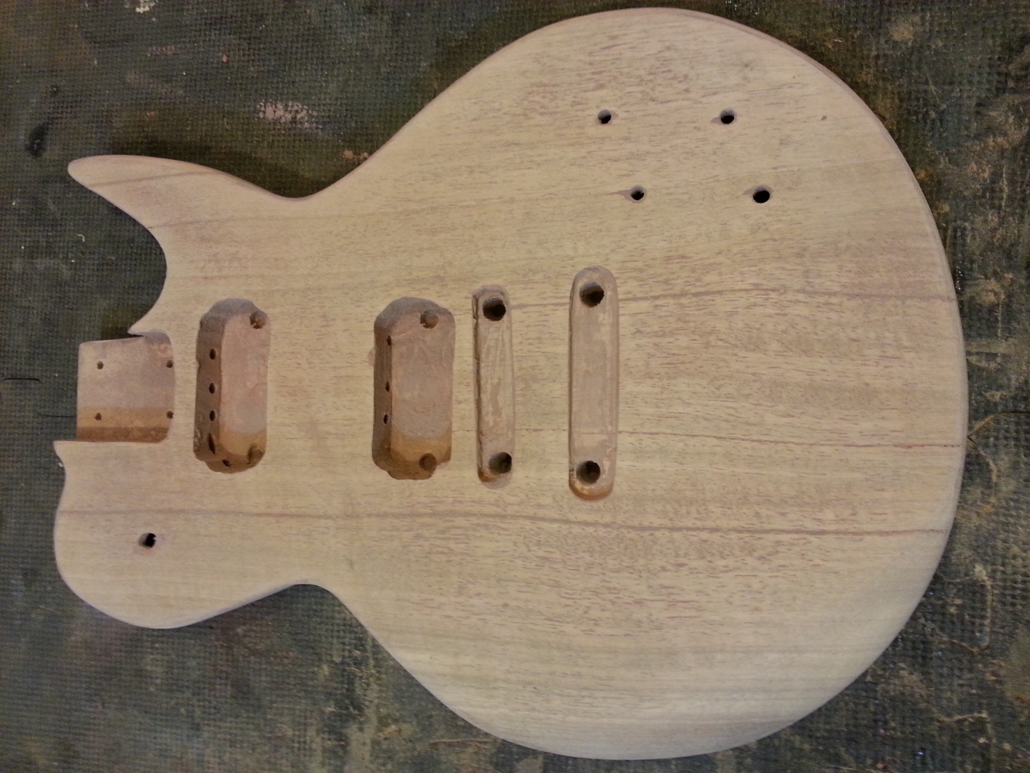

    got the timbermate sanded off lastnight and it went to plan. Used 120 grit orbital to get the bulk off and then a 180 grit orbital paper to get the rest of the timbermate off.
    Here's how its looking.
    Will run a 240 grit orbital over it then hand sand to get nice even curves on all the edges.
    Then its ready for staining. Thinking using wudtone amber, I don't want a stain too dark. I want the marri grain to be seen clearly
