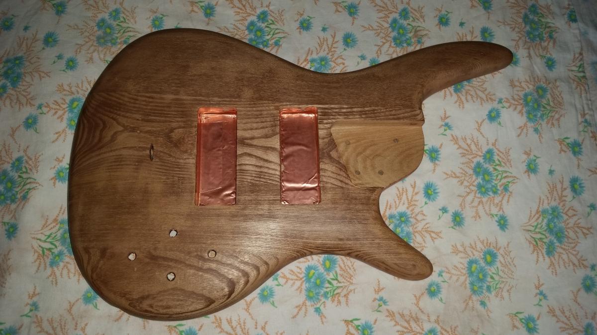

    Well, after quite some time I have finally got a little bit of time to work on this.
    I decided to do it a bit different. After sanding I used some brown filler and sanded some more. I quite enjoyed the sanding.
    Today I have waxed the body. I hope it works. I just need to remember to keep the wax up to it.
    Next is fitting the tuners.
    Any tips on getting them all lined up. I think I would like to have them angled back a bit like the Warwicks. It just feels right when tuning lol.
