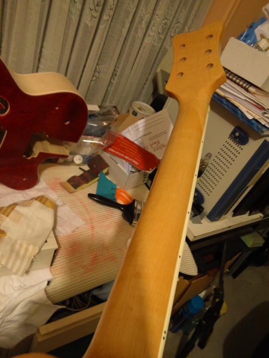

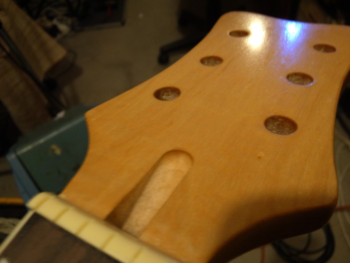

    Hello everyone, ok so the neck is kinda ready, I've bath it today and it's looking more to I wanted, only it's a bit sticky but I was told that will go away as I keep bathing it (Dingotone paste) and I'll add some picks to what it looks like Click image for larger version.
ID:	4629 Click image for larger version.

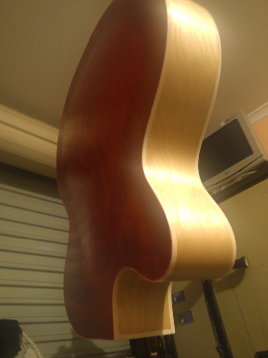

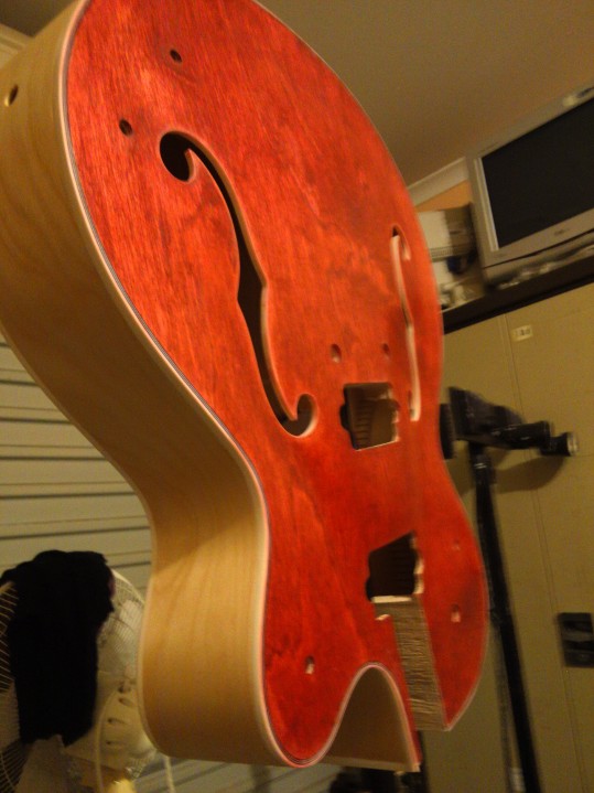

    Now I started the sides and this is what it looks like,Click image for larger version.
ID:	4631 Click image for larger version.

    Question: Should I put the neck deco now before the strings adjusters and bathing?
    Can anyone spot something I'm not doing wright (Gatto clean the edges after I put the neck).. Thanks in advance and glad to show this project process...
