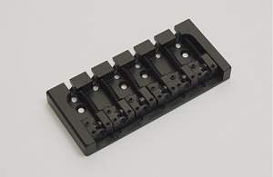

    Turns out the bridge has a pretty horrible paint job on it.
    Considering swapping in one of the Hipshot A style bridges. Then doing through body stringing with ferrules on the back.

    If I'm figuring this right...
    The provided bridge string spacing is 75mm across, 15mm between strings. I actually think it's fractionally less.
    That puts it smaller than any of the hipshot bridges. Their smallest 6 string bridge being 83mm.
    The fretboard at the heel is 81.5mm across, so a 83mm spacing is not going to work.
    (Allparts quick release 6 string bridge is 80mm, Gotoh 6 string is 90mm, Schaller gets down to 78mm.)
    Guess I'll stick with the provided bridge.

    The hipshots have adjustable spacing, should be able to fit it. I have two five stringers with the "A" style bridges on them.....

    81 mm fretboard means 3 mm from centre of string to edge using a 75mm bridge if placed equidistant (which it probably wouldn't be but I don't think it matters for the example).
    The hipshot 6 string bridge is 83 mm. The outside saddles would both have to move 4 mm to reach 75 mm spacing. Seems unlikely.
    On a different note. I wonder if anyone has any experience cleaning up the paint job on a bridge. Either re spraying it or sanding out the bubbly paint?

    If you've got access to a sandblaster or know someone who does, that would strip that rough paint in no time. Otherwise, you could just do it by hand until it's smooth and respray it, no need to get it all off. Make sure you get some metal appropriate paint though.
    I thought of a sandblaster too but I reckon paint stripper might be a less invasive way to go. That will get everything off and give you a nice clean canvas to respray.
