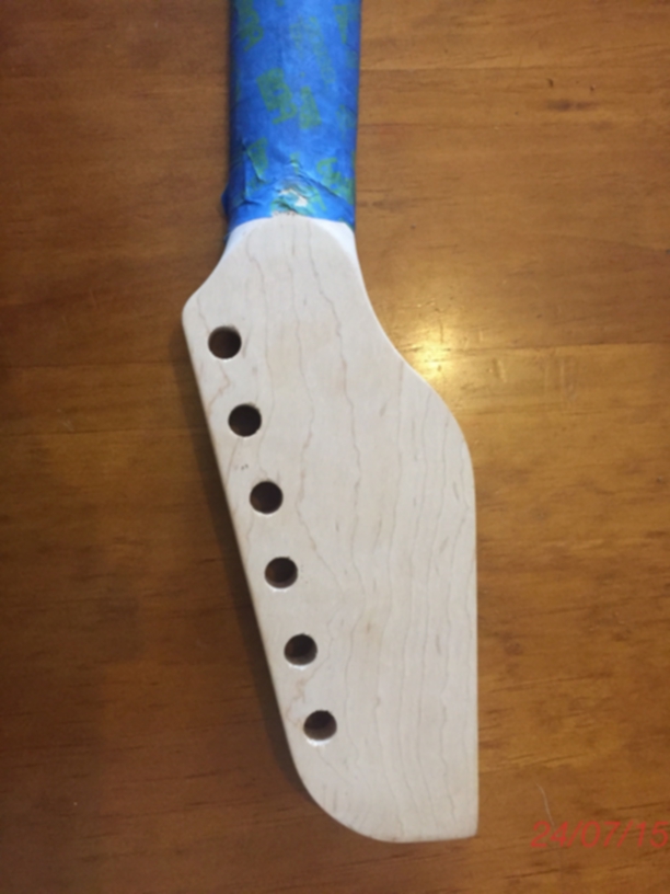

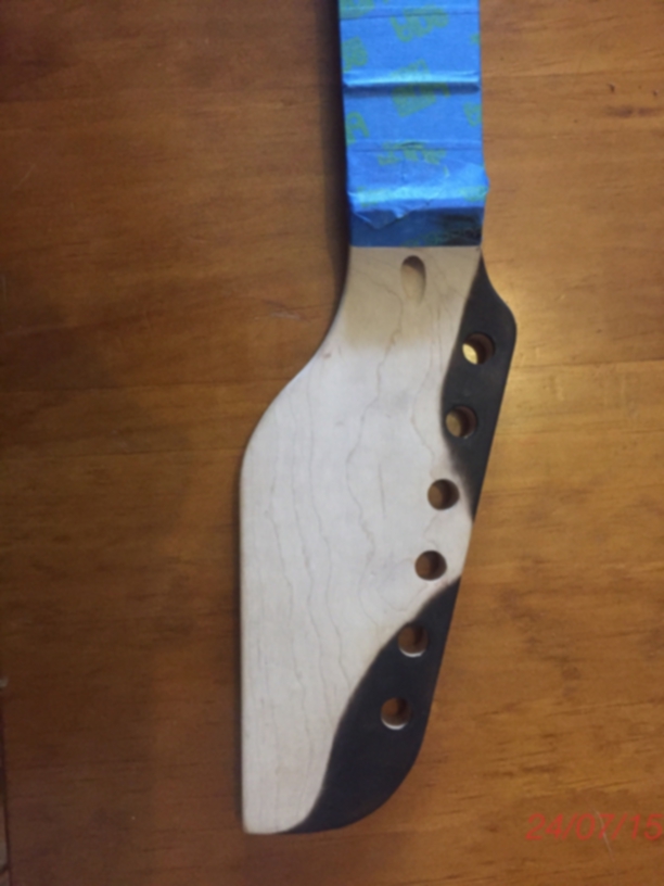

ID:	4257 Here's the end of my late nights researching the best way to burn a maple headstock with some degree of accuracy. What I ended up doing was transferring the design onto baking paper (next best thing to tracing paper) with a Sharpie and then transferred that onto a sheet of flattened corrugated iron. I then used tin snips to cut around it, filed away sharp pointy bits and I was done. All I then did was use the lowest setting on a creme brulee burner (mmm...creme brulee) to blacken the headstock. Here's something I did learn whilst practicing on pine before moving to the maple - pine burns much faster. Next up, rubbing Dingo's stuff all over it.
    nDR01d
  5. #24
    looks good Andrew, so the iron protected the rest of the headstock while you burned the swan shape ? clever idea!

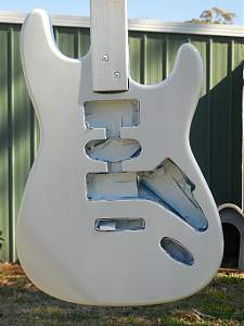

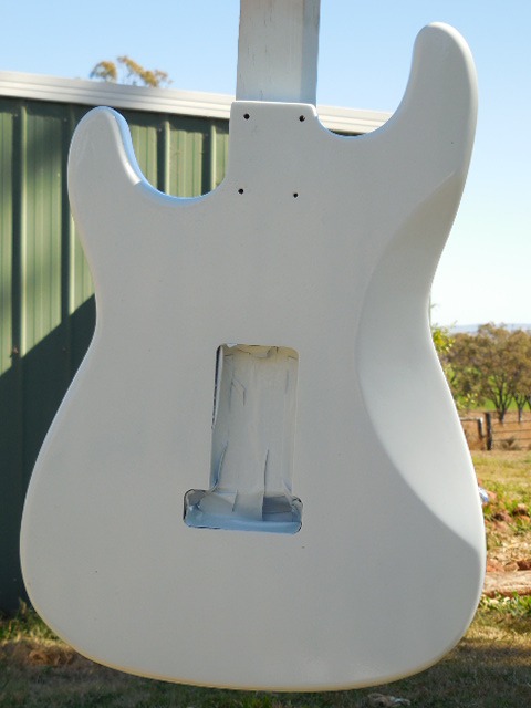

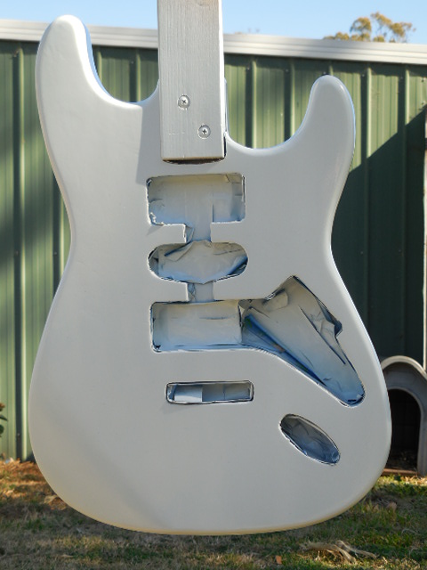

ID:	4365 Here are the last two photos of my guitar until September. I've sprayed on two cans of acrylic lacquer and now I just wait till it cures. In the mean time I'm deciding between saving for a left handed Strat, a JK-1, or the Rick 330 that's on sale. Decisions, decisions.
    nDR01d
  9. #28
    looking nice and white Andrew, how come the wait till September, you away or funds ?
  10. #29
    Member nDR01d's Avatar
    May 2015
    Near Warwick/Toowoomba, Qld.
    131
    No, I just thought acrylic lacquers took that long to cure. What's the general consensus on curing times?
    nDR01d
  11. #30
    3-4 weeks dude. I've been told to go by smell. As soon as all traces of smell have gone, you're good.
