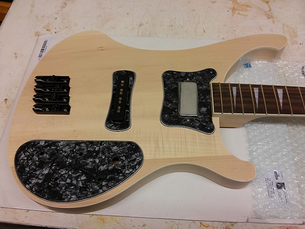

    Got my family to Savonlinna a couple of days back and tomorrow is the Midnight summerīs fest here in Finland when the night is at itīs shortest and the sun almost doesnīt go down at all at night. Tomorrow itīs time to take it easy and get wasted with family and good friends at our summer cottage (have the kids taken care of by grandparents somewhere else - donīt bring them along until the next day) but before that an update on this project.
    Got a little time to carve the scratchplates out of the sheet and try them on. I did this because I still have enough material to make a copy of the original. If I wanted to show the flaming, I had to shape these so that they are not exactly in line with each other regarding the shape, hight etc.
    So tell me what you think of these - are they usable in your opinion or would the original be more appropriate?
    Got the holes for the screws on the bridge drilled also. Used fishing line and small weights in the end of the line to align the bridge while the neck clamped in place. Used the same 60mm E-G space as in the bridge that came with the kit. If the individual bridges donīt work for some reason, the holes are covered by the MM-style kit bridge.
    Arzi

    Finland sounds like such a great place, very nice.
    That design looks very good, classy and different
    Jan 2013
    3,162
    I like the custom plates Arzi!
    I like the design, It may depend on what the final finish looks like and how it matches to the black pearloid (good colour by the way, I have the same on a black Pbass).
    Mentor
    Jan 2013
    Talawa, Tasmania
    1,173
    Looking terrific! That black pearloid will look sensational with your black/red colour choice!
