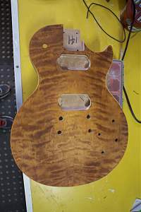

    Just took delivery of a LP-1Q kit this week and trying to decide what to do with the Back.....it has a lovely grain so may just run FW Jarrah like you have......just cannot decide what to do with the top...
    One question if you do not mind....how much sanding can i get away with.....fearful of rubbing through the quilted top.....
  8. #27
    Hey Bluesy, going on other quilted maple kits the veneers are very thin, so I would do very minimal sanding and with at least 320 grit or higher. Not worth risking sanding through the veneer.
    If you are going to pop the grain with a darker colour then certainly no pre-sanding before the dark coat.
    Might be safer to do a very light sand of the veneer and go straight down with the stain colour of your choice
  9. #28

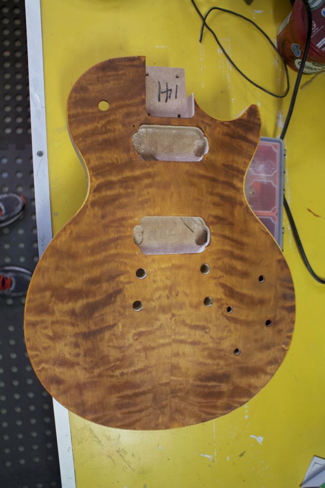

    I took your advice.....
    very light sand with 320 grit and voila after 1 coat of my special mix of F&W Golden teak with a splash of jarrah mixed in ....
    I am one happy bunny.......thing is do i now leave this or rub it back......before Tru Oil....Click image for larger version.

    awesome Bluesy love the colour. I'd leave the top to cure for 2-3 days then start your TO coats. Not worth doing any more sanding on the veneer
