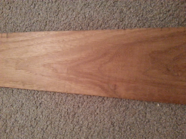

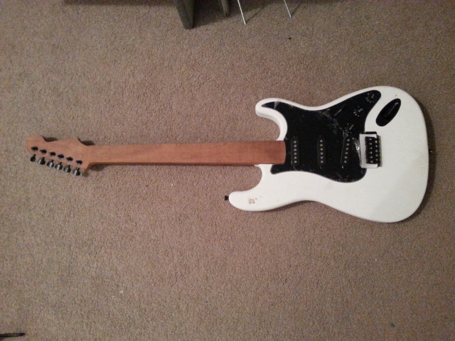

    Big day today. Parts arrived and trial fitted. Found out I didn't route the pup cavities deep enough and the jack cavity needed some widening. Of course when I fitted the template to re route the pup cavities, some tape lifted some of the paint near the top horn.
    My fault for not waiting until I had all the parts before I finished the primer. Won't happen again. I fixed the template and now know when the instructions say pup cavities at 19mm, it is for a reason. Apart from that all fitted ok.
    Looks like my template had all the cavities in the perfect spot. Bonus... The small gap at the neck joint doesn't even look too bad and should close up with some coats of clear on the neck.
    Neck fitted also. Lined up dead centre with a piece of cotton as a guide. Still waiting for delivery of fret wire and nut so the neck is not finished.

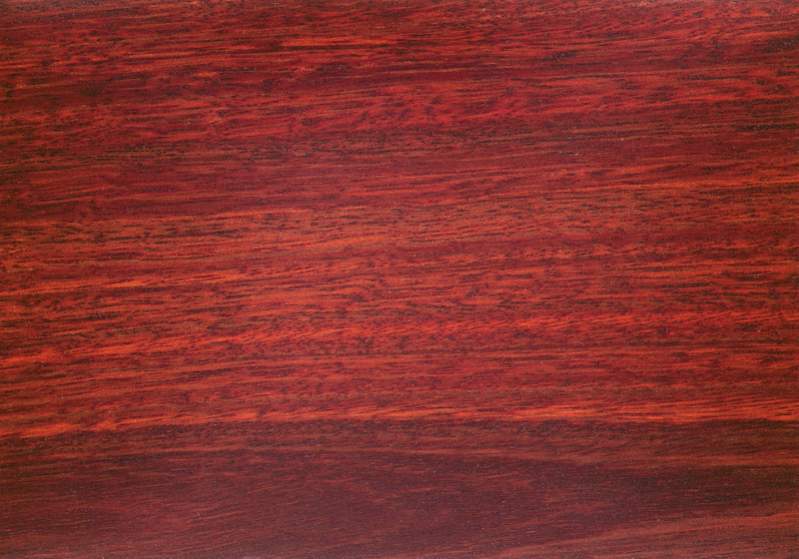

    Also found a source of nice woods for the next build. Picked up some rosewood.
    They told me they can get many types of wood so might use Jarah for the fret board. Sample pic taken off the net but the piece I saw today looked pretty close to that.
    Also read Make Your Own Electric Guitar by Melvin Hiscock. Interesting stuff.

    Looks great Greg!

    A nice chunk of quater sawn Jarrah does make for a nice finger board..
    Try to avoid flat sawn timber as it isnt as stable as quarter sawn, this is important with Jarrah especially as flat sawn Jarrah has been known to split when cut into thin slabs.
