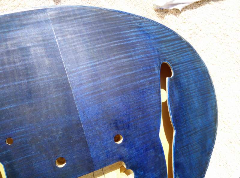

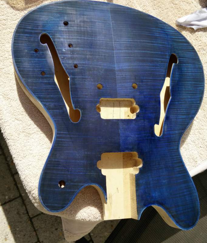

    First pass. Grain pop is so-so. Not bad for first try, I guess. Still wet

  6. #26
    That looks great. This is going to be a very unique starcaster.
  7. #27
    What did you use for the blue color? Is it Colortone? Looks awesome!
  8. #28
    It's good Mario!
    The grain will pop a lot more when the gloss goes on
  9. #29
    Nice work, enjoy the flame popping before your very eyes when top gloss is applied!
  10. #30

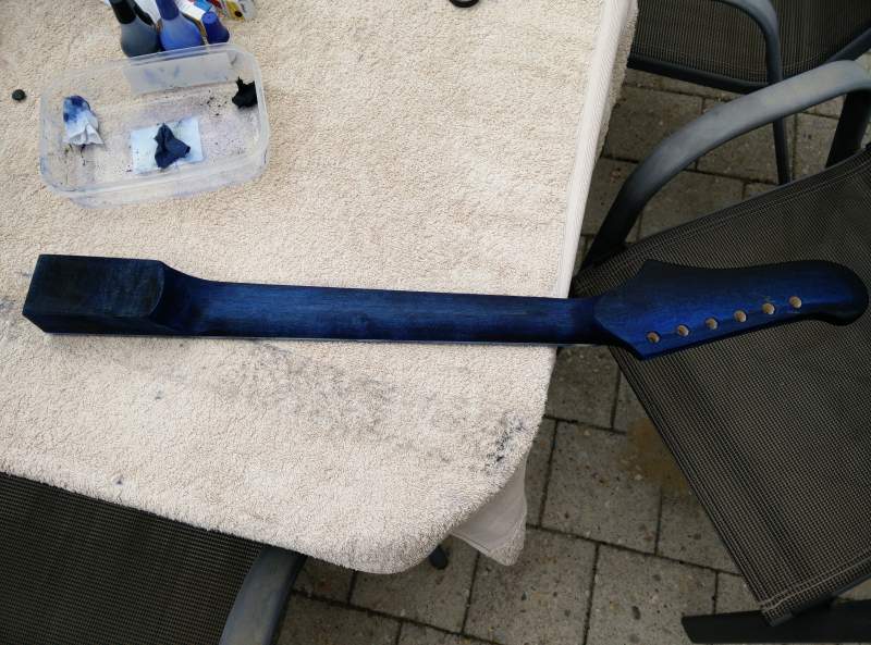

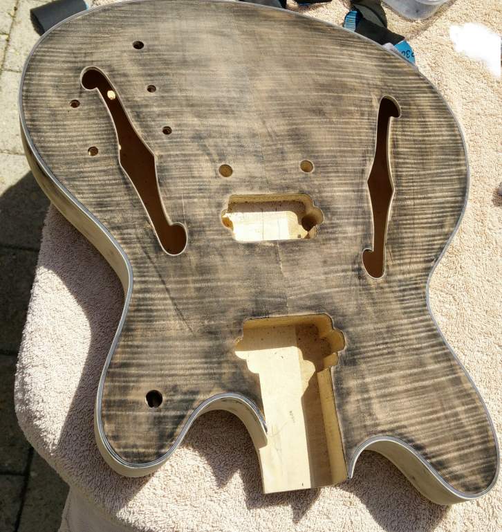

    Gav, I used ink.
    I used the incorrect type of ink for the black, and it's biting me now. IMHO the body is very dark. And I am not sure I am game enough to take more of the veneer off to lighten it. I think staining black first was a mistake for my skill level.
    Here's the front of the guitar as it looks now and the back of the neck. I blackenned the fretboard and stained the headstock. I will need to darken the front headstock if I can't lighten the body.
    Now that it is more, but not completely dry the body looks boring IMHO. I'll try take some off and add some more blue when it's dry. I can't really remember if colours get less vibrant when they dry, but it's not a very lively looking top right now.
    The question now is - Chrome or black hardware?
