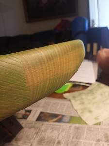

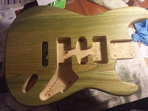

    I used up half of the bottle last night and the rest this morning. If any spots come up I'm okay with getting another bottle if I have to.
    Either way, new photos! There's a couple spots that simply wouldn't accept any stain at all, sadly

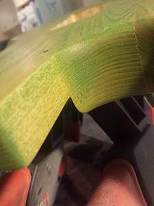

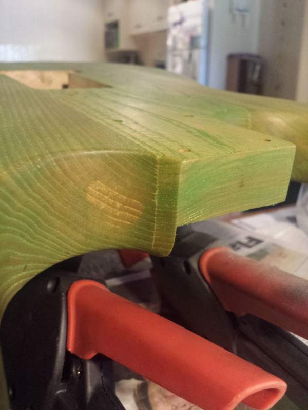

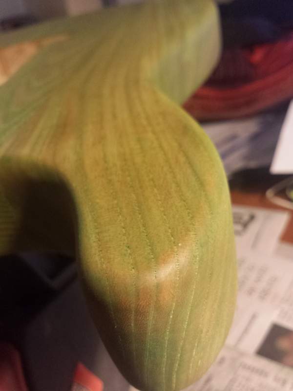

    Now for the areas that wouldn't take the stain

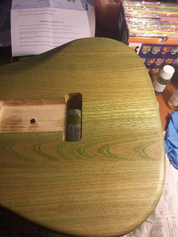

    More coming
  5. #25

    I had the same trouble with my STA some areas wouldn't take the stain. What grit paper did you sand to ? If it was 400 or more you may need to sand with a rougher grit to give the surface some tooth.
    The cutaway/horn area is glue and will take too much effort now to remove.
    I keep using the stain coat till the bottle has finished, sounds like 3 coats maximum for you anyway. The first coat usually takes about half a bottle it really soaks in. It should darken a bit as the oils in the stain cures.
    Go onto intensifying coat once the stain coat has finished. If you apply it fairly thin I think you can get away with 4 days curing if its warm/hot weather

    You might be able to get a wire brush on to those glue spots to try and get them to accept some stain. Do you have more pics. Interested to see how the colour is developing!
