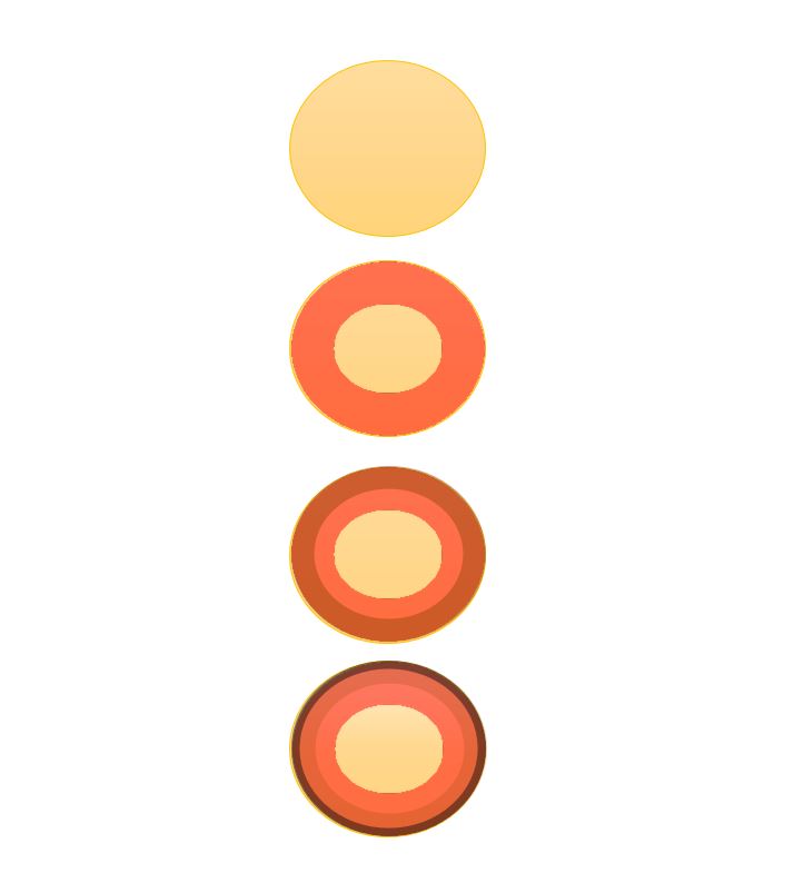

    cheers wokka, yes first burst but not sure if I could ever recreate the technique! I basically worked from the centre to binding with yellow, red, mahogany and black, blending each new edge as I went (does that make sense?). That way some of the blending happened through layering. I also wiped a wet cloth over the top before commencing.

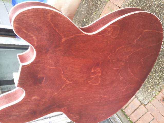

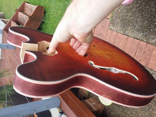

    Cheers everyone. Gav, from memory you mentioned in your ash lp that colortone and tru oil made a good combo.. you were right there!
    Some more progress, have started dyeing the side and backs. One coat red, 2x red mahogany, 1x black. I'll give this one more black then naughty oil it off. Same treatment for neck.
ID:	1933   Click image for larger version.
