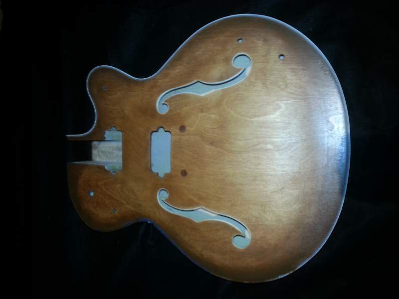

    I've taken the horn area right back to about 30-40 mm from the edge. It's looking like a real relick, might just call it the Relick from now on. lol
    It is developing that very worn vintage look. Still got a bit more work to do on the fade.

    Gav, I am torn over the Clear.
    I could go with what I know and that's clear Schellac, or
    I could go with Clear Varnish(not a real fan of this though), or
    I could go with Kryllic(totally unskilled with this and could Farc it up).
    I suppose I could visit the gun shop and ge something more Tru...

    PK this is coming along nicely and like the recent change to the burst. For the clear I'm thinking naughty oil but maybe a more satin finish would suite the vintage look?
  6. #26
    with that vintage look, shellac would be fine, would make it look a bit like an old violin

    Just thought I should add this, this deck is being layerd with small rags. No brushing, no spraying.
    the only time a brush has been used is in applying the brown tinted timber-mate.
    Cutting back is being done with 0000 super fine steel wool
    The back of this thing is smooth like a babies bum. the front will get there too, but there is a lot of layering going on around the edges to build that brown burst effect. I say brown as it is abit darker than a tobacco burst being Walnut stain
