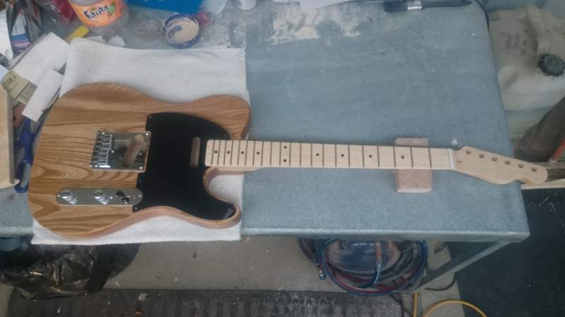

    It's been a nice warm week here, the finish is curing nicely, I will probably start fitting up the neck and bridge on Monday (got to love a public holiday!), but couldn't resist a sneak peek
Name:	2015-01-23 19.03.56.jpg

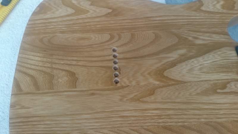

    With a quiet long weekend, I managed to get it finished over a couple of days.

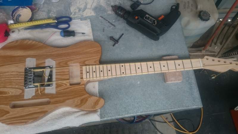

    Aligning the bridge
Name:	2015-01-25 16.11.31.jpg

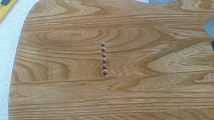

    Drilling string-thru holes
Name:	2015-01-25 16.41.02.jpg

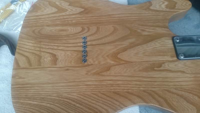

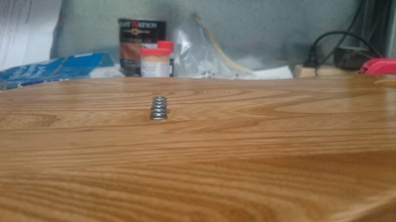

    Fitting ferrules...
Name:	2015-01-25 16.42.52.jpg
    ...and they are almost straight!
Name:	2015-01-25 16.43.02.jpg

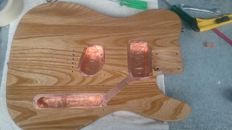

    Shielding cavities with copper tape
Name:	2015-01-26 15.26.39.jpg

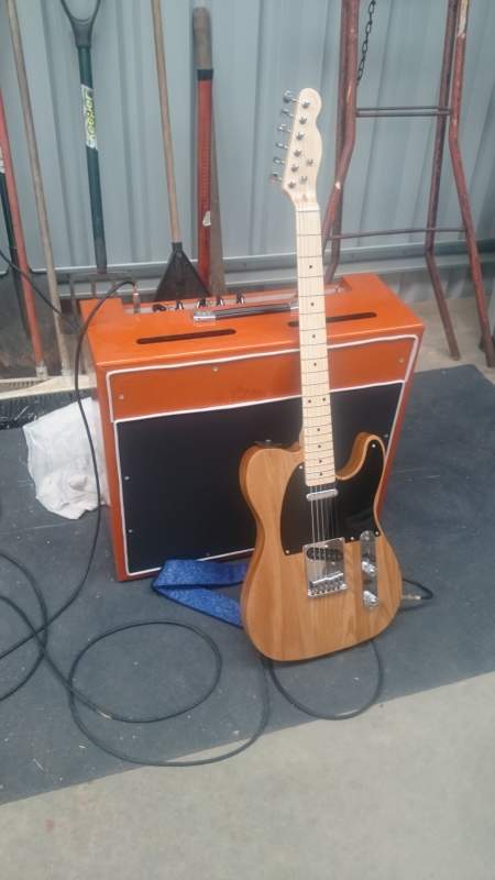

  8. #28
    And the result!
Name:	2015-01-26 16.44.44.jpg
    The good- plays great, nice and light, good tone and level of output
    The bad- the nut seems too far away from the first fret, so open strings are quite flat in relation to fretted notes. I imagine I will need to either offset the nut or file the slot closer to the bridge. There is still a bit of hum even with the cavities shielded, but its the same on my strat, so is probably a normal level for single coils. I slipped with the screwdriver when fitting the string trees and put a tiny dent in the headstock
    Overall pretty happy with it as a first attempt, I have learned a lot that I can apply to my next build, that's for sure
  9. #29
    Looks great Ian - that is some lovely grain! A great job. You must be very pleased with the outcome. A sweet, sweet Tele you have there!
  10. #30
    Banned bargeloobs's Avatar
    Mar 2014
    1,700
    You gotta be happy with that result, she looks unreal mate. Bit odd about that nut position, might be a good opportunity to throw the plastic one away if you're making alterations.
