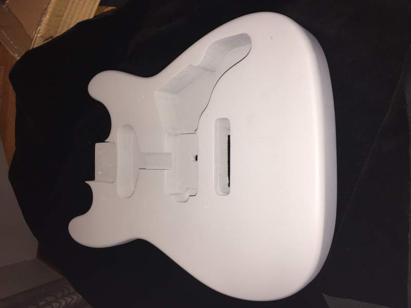

    Just a spray can of acrylic primer. Ive done 5 coats. It got a bit windy yesterday and blew the body off the hook. No wood damage. Just paint work. I'm off to get 1200 grit paper now and a couple of hot dogs. I'll rub it back and give it another 2 coats. Then a rub down and I hope it will be ready for some colour.

    Just a little food for thought, I notice you're going pretty heavy with the primer, obviously you're after that perfect smooth finish which is great. Maybe an option in the future could be to grain fill the timber before painting, that way you'll only need one coat of primer, you'll cut your curing times right down and obviously have less paint on the body so the natural resonance of the timber won't be as stifled.
    There's heaps of options as far as grain filler goes but a good inexpensive way is just with super glue, spread it all over, let it cure completely then sand back for an ultra smooth finish.
