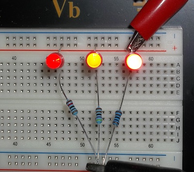

    I've edited my previous post to add an extra diagram that overlays the layout's wiring colours onto the schematic, so you can see which wires form which links.
    Also, I just did a quick resistor test with some red LEDs and the 10K was actually much brighter than I expected, should easily be bright enough for most pedals. The camera has distorted the actual colours a bit in this image, but it gives a good indication of the relative brightness/intensity. Left to right the resistor values are: 10K, 4.7K and 1K (on a 9V supply). There's room to go even brighter with these LEDs, but this was enough for the demo. So, I was wrong, your schematic's 10K values should work nicely for low intensity indicators.
    Attachment 936
    You could even try upping the value of the 10k resistors to something in the range of, say, 12k to 22k if you're using ultra bright Leds with clear encapsulations on them, I've found with some super bright Blue Leds you need a resistor value of something like 33k or so, or even 47k.
