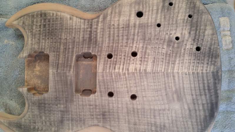

    Here's another pic of the cap now sanded back. There's a lot going on in the flame, definitely no pick guard on this one!

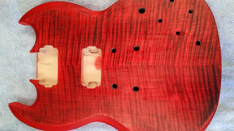

    And here we go, with first pass of red dye

  5. #25
    wow Andrew, that looks fantastic, got to be happy with that. Are you planning more red coats to get a deeper red ?
  6. #26
    Yes, more coats to follow.. scored well with the flame cap, it's hectic! I seem to recall someone else in the forum mentioned these kits on particular had nice caps.

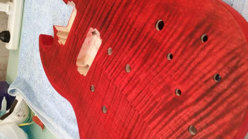

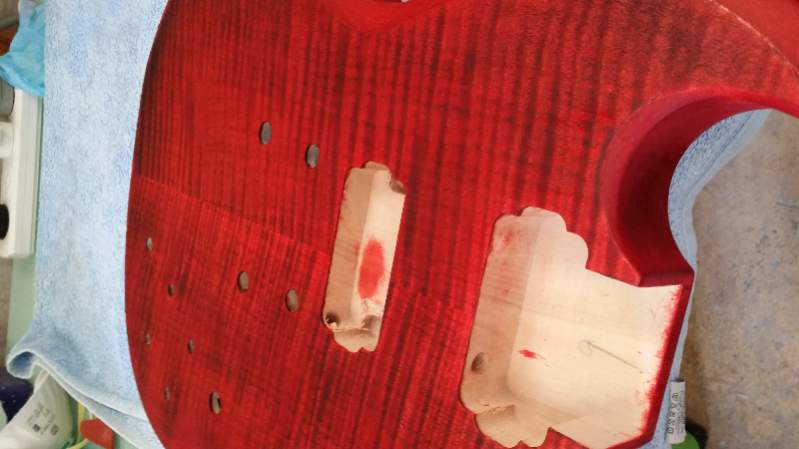

    Whipped out the naughty oil this morning, first soak coat on.. Ta da up pops the flame!
