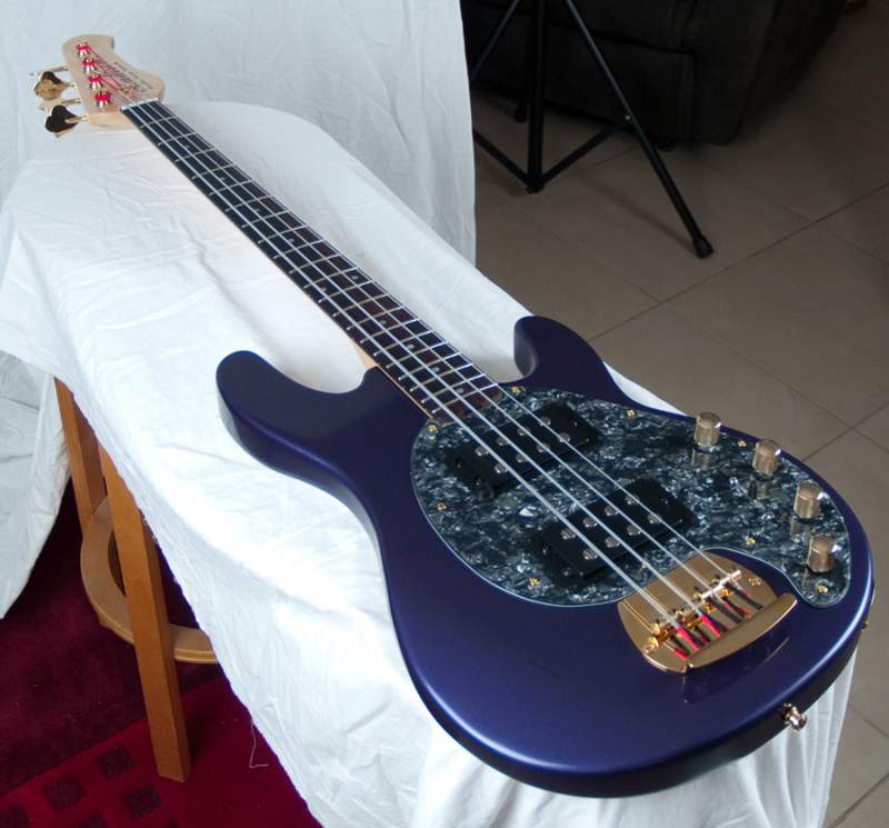

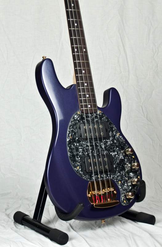

    Bass Build Finished
    I’ve finial finished my bass. I’m very happy how it turn out for a first build plus it sounds awesome especially through my Ampeg. I’ve already order my next build which is the IB5.

  10. #30
    wow Peter that is stunning, very well done. There's still time to enter into February GOTM, would love to see more pics of this beast and tell us about all the hardware upgrades.
    You will love the IB5 kit, are you planning a stain or solid paint for it ? Would be a shame to hide the nice ash grain
