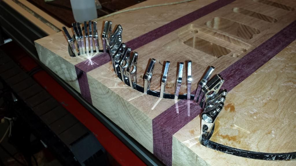

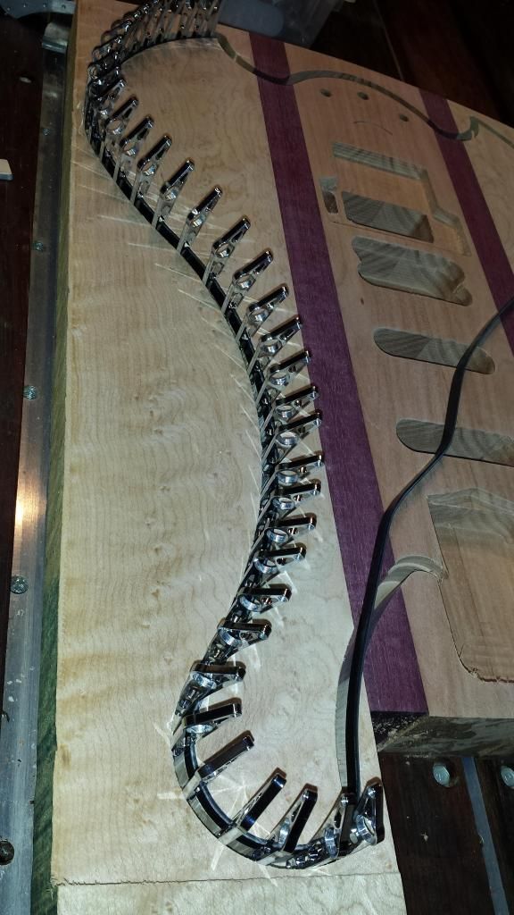

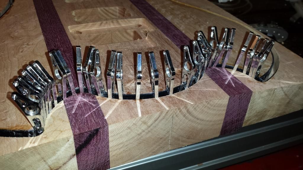

    will chop a few wooden wedgies up tommorra and get as many in as possible...best part is they will be reusable!.. i think even if the geet gets released from its stock the stock can still be used as a wedge backplate so will think twice before i trash them and recoop what woods left over..like the qld maple that was from the last build sliced those off the sides and made the centres for this one...

    one for the cnc haters...you gonna love this!
    stuffall talent skills or artistry was used here the computer designed eveything on its own,
    worked out the angle's,
    the curves,
    the depths,
    the speeds,
    where the wood is on the table
    ,how fast to cut it
    when to start and when to stop
    , all on it own hey its own by it self ,
    one of those inteligent computers called ...wait for it
    .......A HUMAN!!!
    gotta love machines especially when they do what they told! like in the good old days !
    and the binding getting done pronto..that took forever to work out!
    [embed]https://www.youtube.com/watch?v=lpsWQ2cxdoM&feature=youtu.be[/embed]

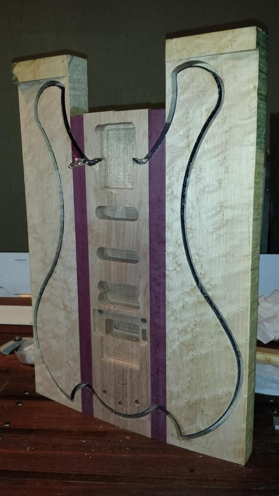

    binding done in the blank

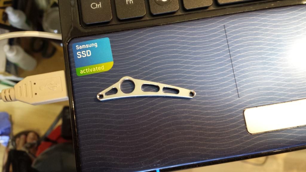

    Lovin your new shiny wedgy thingys, can you post a pic of one?

    sure here ya go

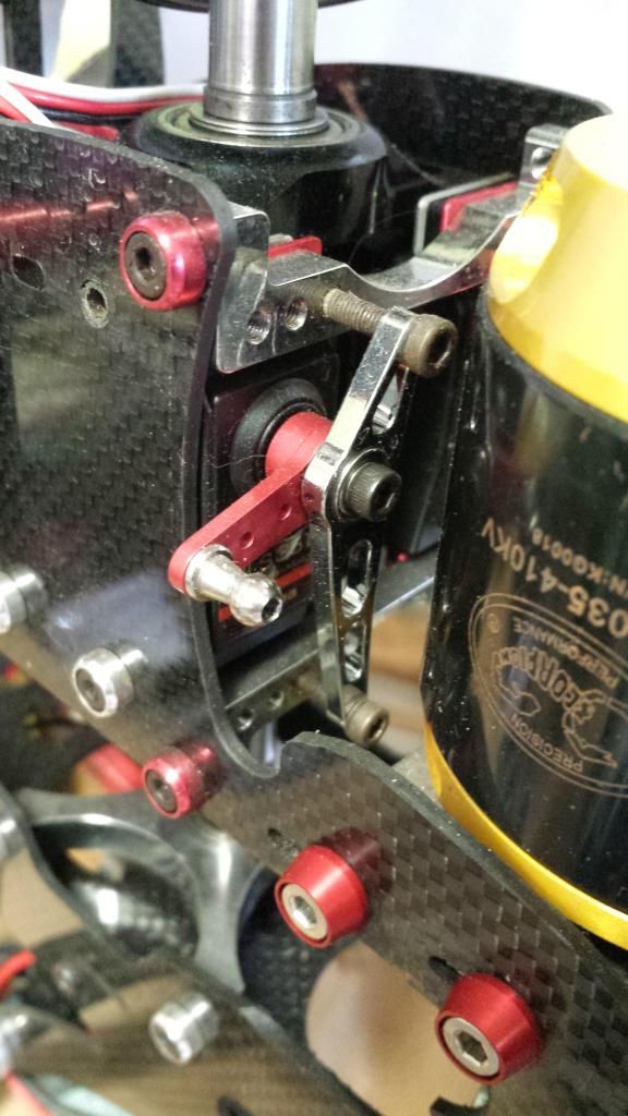

    designed it for my helicopters as a servo arm support for high stress high voltage collective servos,holds the outside of the servo arm steady so it doesnt rely on the bearing in the servo housing only..a bearing goes in the big hole..
    and now to be used to build bindings!

    Very clever
    I should have realised thats what they were..... They are much stronger looking than the stamped out mystery metal servo arms on my Chopper....

    like this
