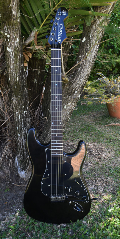

    It's black because that's what I do
    Black Goto bridge, Black Grover tuners, Tonerider City Limits pick ups push pull pot on tone 1 "adds all" on on positions 2 and 4

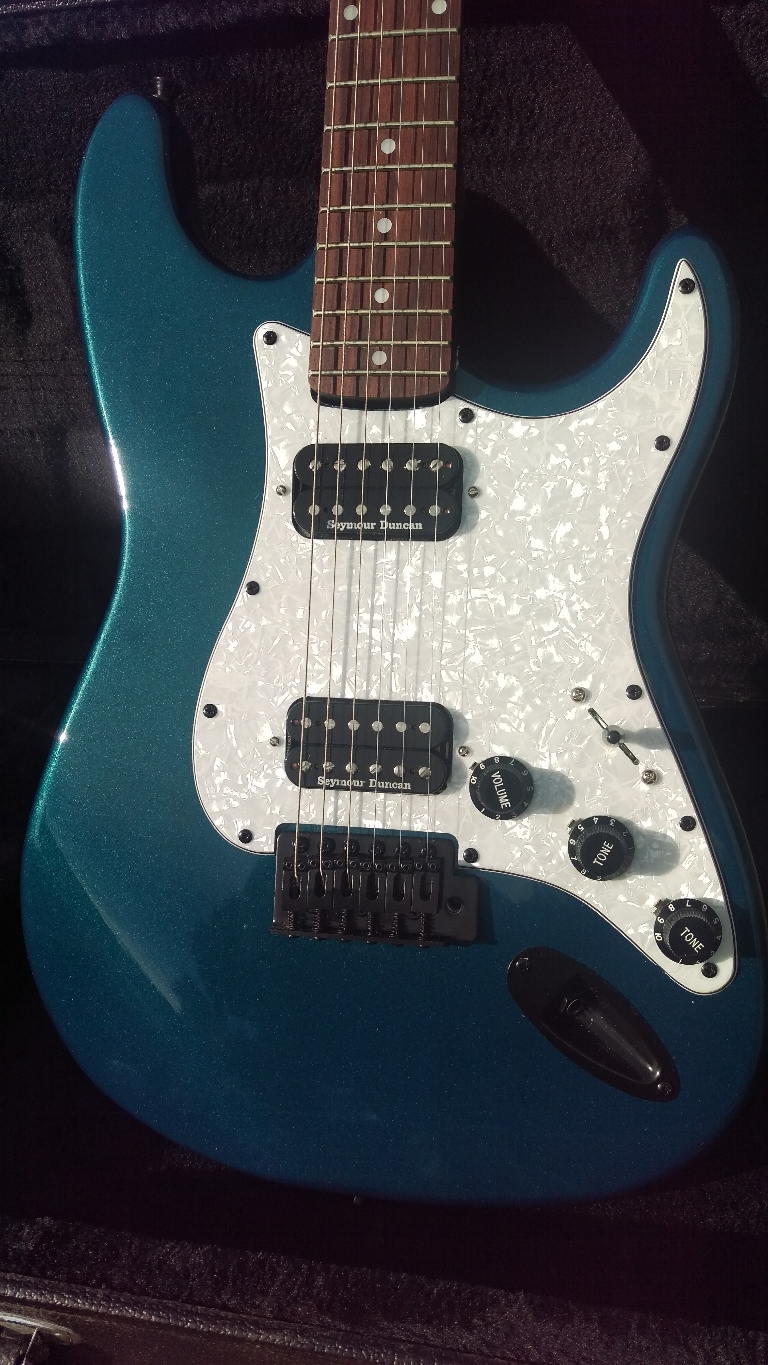

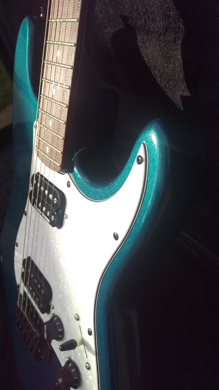

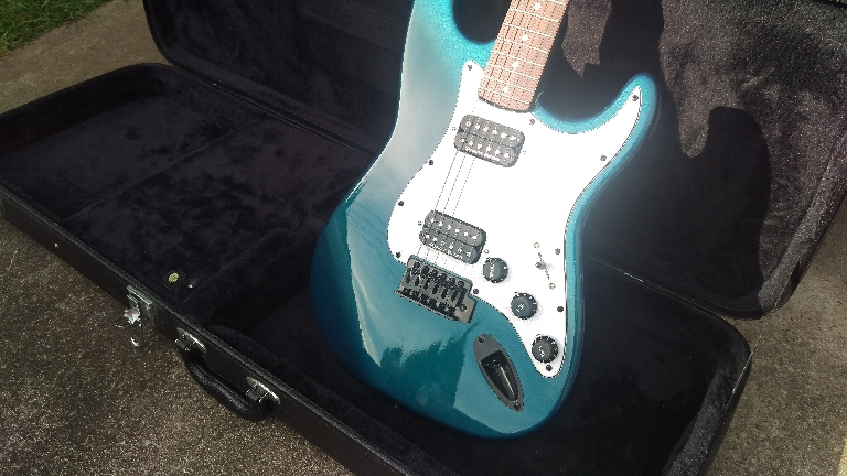

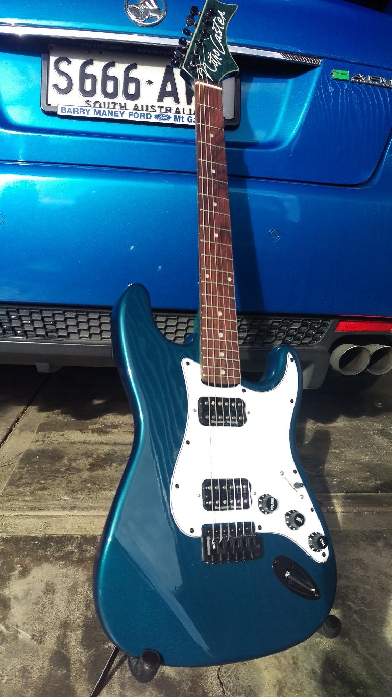

    Thought id post my Strat i did back in August
    ST-1 By NitroBurner1000
    Hi guys, this is my first build and with plenty of help from the guys here its finally finished.
    Quick rundown..........
    Aftermarket Pickguard to fit twin humbuckers, white pearloid
    Seymour Duncan JB and Jazz HotRodded Humbuckers
    Upgraded to Grover Tuners
    Black hardware
    Copper shielding to humbucker bays
    3 aftermarket push pull pots to ...1) split the pups 2) series parallel options, 3) in and out of phase.
    Vintage cloth wiring
    Treble Bleed mod
    Plastic nut replaced with a bone one
    Replaced stock 5 way switch with 3 way.
    PAINT FOR BODY....
    6 coats sealer/primer,
    6 coats of black basecoat,
    4 coats of metallic undercoat and
    6 topcoats of clear 1k acrylic full gloss.
    Sanded between coats, bodyfilled and finally buffed and polished
    NECK AND HEADSTOCK
    Stained and finished off with wipe on poly.

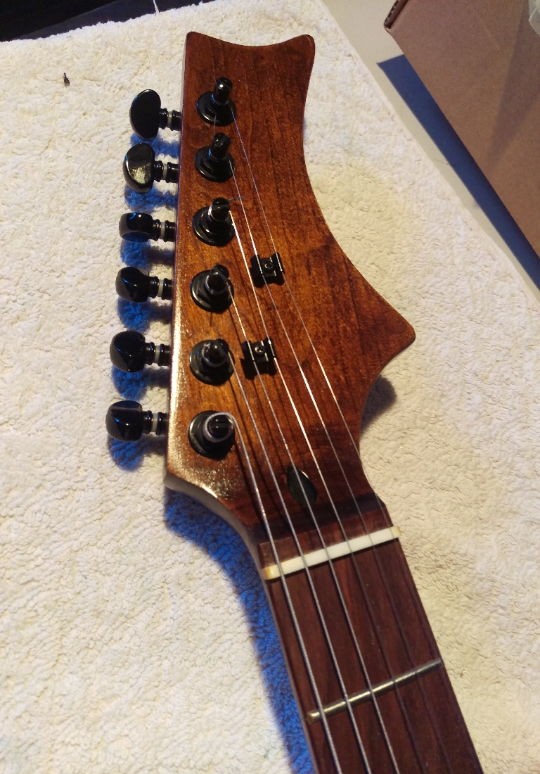

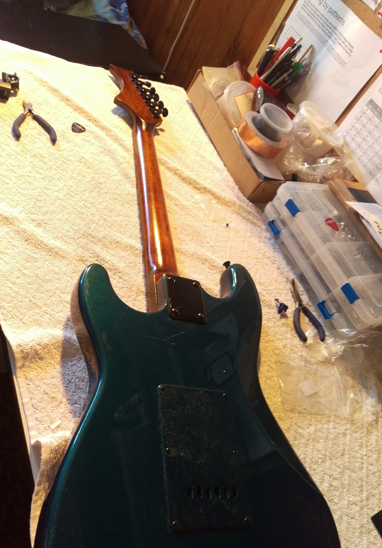

  3. #23
    Jun 2016
    Mount Gambier Australia
    1,171
    Update.... neck resanded and restained with a different stain. Logo removed, redo at a later date.

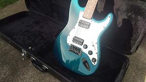

  4. #24
    My second build st-1 with tone rider pickups and Grover tuners
    Finished with black stain and Cromax 2 pack clear

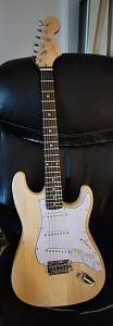

  5. #25
    The Count
    All standard kit parts, acrylic yellow from Supercheap, FW maple stain ( from somewhere that must never be mentioned ) on the neck.
    I'm about to take the neck off to get a better finish and do a full setup.
    Hi Dave on the off chance you are still on this forum what paint did you use from supercheap?
    Cheers
    Mike

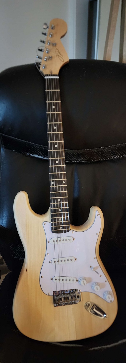

    ST-1 by me, in Feast Watson Wipe on poly satin
  11. #30
    Love that finish, black scratch guard and chrome screws really set it off.
