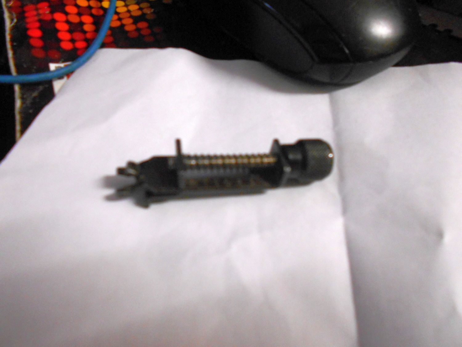

    For those of you who have built, or are building, PBG kits that feature a Floyd Rose style Trem, here is a special tool that makes setting the intonation on each string a lot easier, this little device is called The Key, and you can order them online from Stewmac.com.
    Here's what it looks like:
Name:	The Key_resized.jpg
    Normally, when you go to set the intonation on a Floyd-equipped guitar, you usually have to keep pulling on the string anchor-bolt to prevent the string-saddle from sliding forward towards the neck when you loosen the saddle retainer screw, this makes it very hard to set the intonation accurately, with The Key tool, you no longer have to keep the saddle from sliding forwards, it does the job for you, and you are then able to set the intonation more accurately by turning the knurled knob positioned at the end of the tool.
