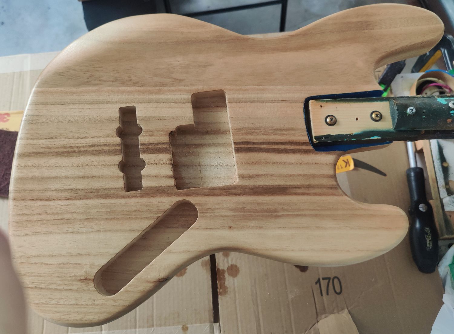

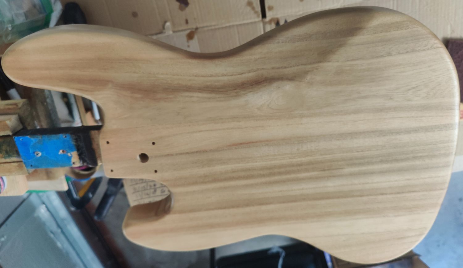

    This is 11 coats of PC Petrifier, to which I have been adding a little, very fine paulownia sawdust.
ID:	45295Click image for larger version.
    I am not really using this product as it was designed. What it was designed for is hardening rotting wood. The paulownia I am using is obviously not rotting, but it is very soft. Also, they recommend using 2-3 coats, so I am using a lot more coats than they recommend.
    It's one of the few water based wood hardeners that I have found, so that is one reason to use it. According to it's SDS it's mostly water, a very mild solvent (glycol ether TPM) and a proprietary hard urethane. Very low VOCs and toxicity. But my off-book use goes beyond that.
    When I first used it I noticed that it dries relatively quickly and hard. It seals the wood well and is about the consistency of normal water, although it is milky white. Since paulownia has huge open grain, I thought it might be interesting use a sanding pad with it, and add some sawdust. From there the idea was to just keep adding a little sawdust and building it up until the grain was pretty well filled. So I have been putting a coat on once a day for almost two weeks. It's now fairly hard, the grain is mostly filled. It dries completely clear with no yellowing. Coats are super thin, and it's only $10 for 8 oz.
    Stain won't penetrate, but I have tried it in swatches with colored shellac, with which it seems to work pretty well...although I am still gaining experience with that.

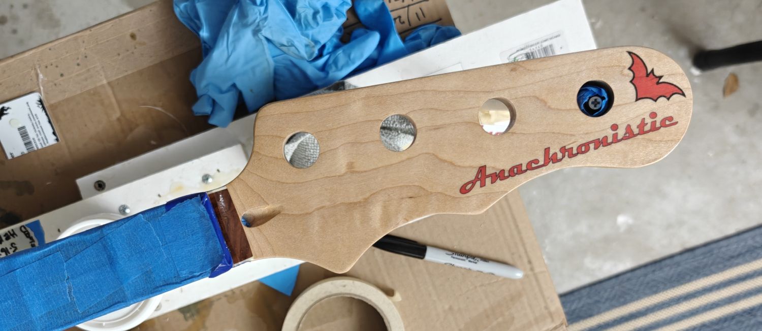

    This project has been on hold for a while while I worked on the Tele build...also incredibly slow. As I have stated elsewhere, I have been having trouble with General Finishes High Performance top coat on necks... I thought the Tele neck was done, until I noticed some problems in a couple of other maple necks and decided to refinish the back and sides of the Tele neck. While it is curing, I decided to start work on the Jazz Bass neck.
    I taped off the rosewood fingerboard, and put blonde shellac on the rest of the neck to give it a little color. This will be the first neck that I have finished completely with Crystalac Brite Tone Instrument finish. No finish on the fingerboard, except some block oil when I am completely done with the rest of the finish. The back will be Brite Tone satin. I am using Brite Tone gloss on the front of the headstock.
    So far I have just started with the front of the headstock. Four coats under the decal, and four coats over. Not sure how many coats I'll have total. I use at least 6-10 over the decal with GF top coat, but with the BT, I may need more since it goes on thinner.
    It takes some practice and patience to get the Brite Tone on well with the brush, but my technique is improving. I am having less drips and runs, and a LOT less brush marks than I got with the GF. It may require a few more coats, but hopefully it will sand out easier.

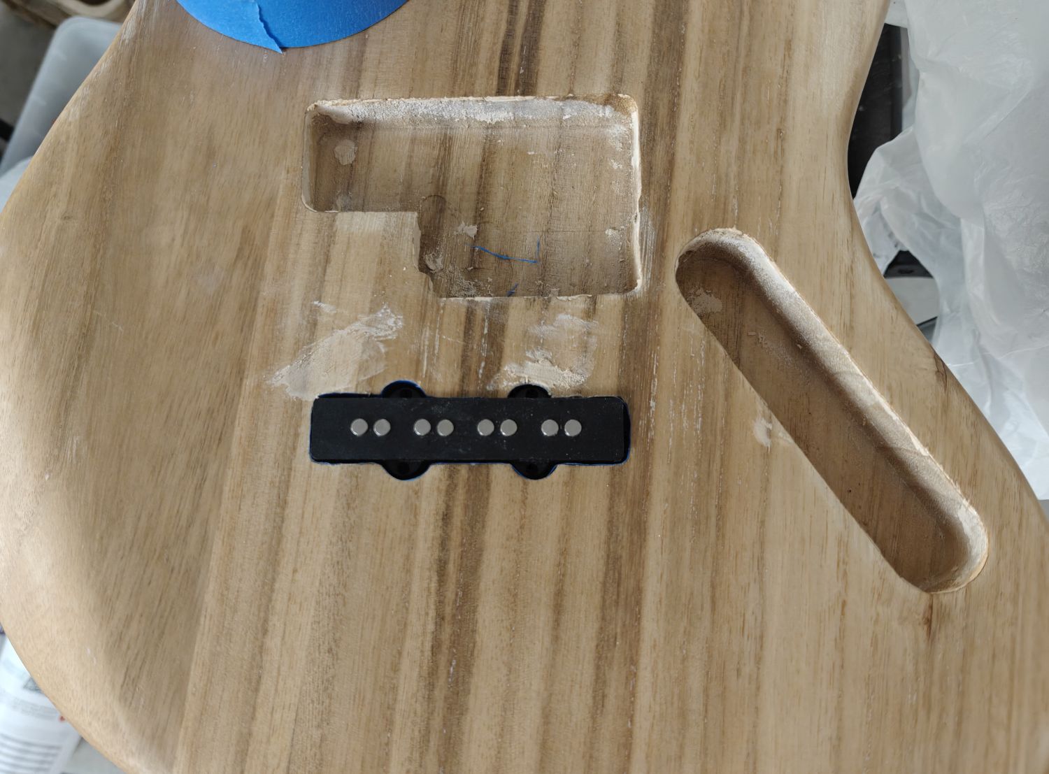

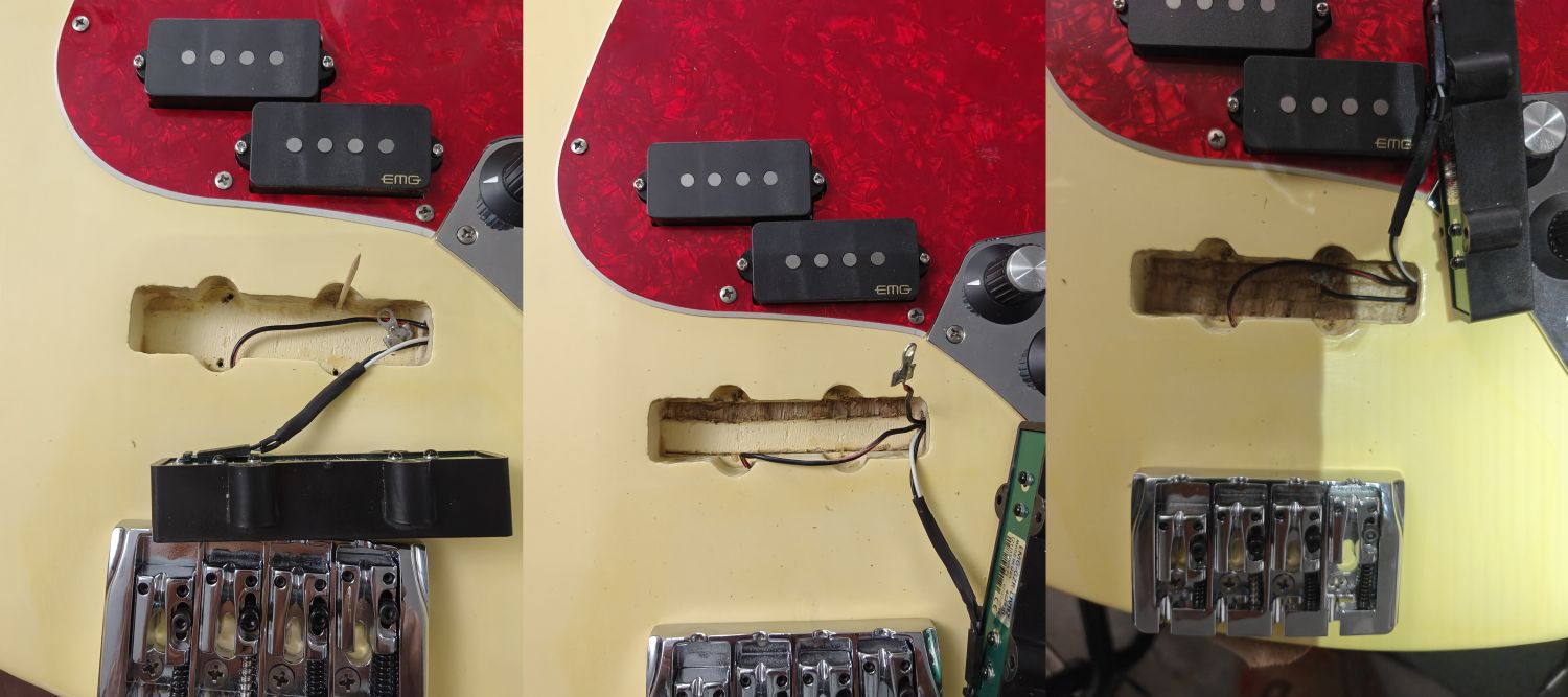

    I was toying with the idea of putting some paint on the body, when I had the bright idea to see if the bridge pickup was going to fit in it's cavity. I thought I might have to clean out a bit of the grainfiller...but discovered that there was a bigger problem. The cavity was just too small, and needed to be a bit wider. I have now widened it a bit with a rotary tool.
    I used an old pickup to do the fitting. The finished bass will have an EMG Geezer Butler PJ set, but I'd rather keep them out of the sawdust. The PJ set is also the reason for the enlarged neck pickup cavity. There are also a couple of small places in the pic where I put a little more filler because, of course, my Dremeling is no more accurate than my playing...and I nicked a couple of places. Lucky for me that paint and pickguards can cover a multitude of sins ;-)
    Speaking of sins... I sanded through the sealer in a few places. I can definitely feel where I did that, but when I look under magnification it looks like there is filler in the spaces. I have been debating whether to put one more coat of filler just over the sanded through spots. But I probably won't. If it looks like it needs more pore filling after one coat of paint, I can fill with AquaCoat, which dries clear. If have done that before and it has worked reasonably well.

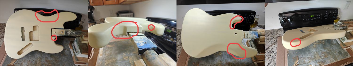

    I put one coat of paint on...just enough to see where there were some spots that were not quite filled. They are obvious whe you see them, but also easy to miss if the light doesn't catch them. So I took some picks and marked them to show me where I need to sand back and add a bit more filler.
    Waited 24 hours to begin sanding. That's not long enough, so I'll give it a few more days and try again...

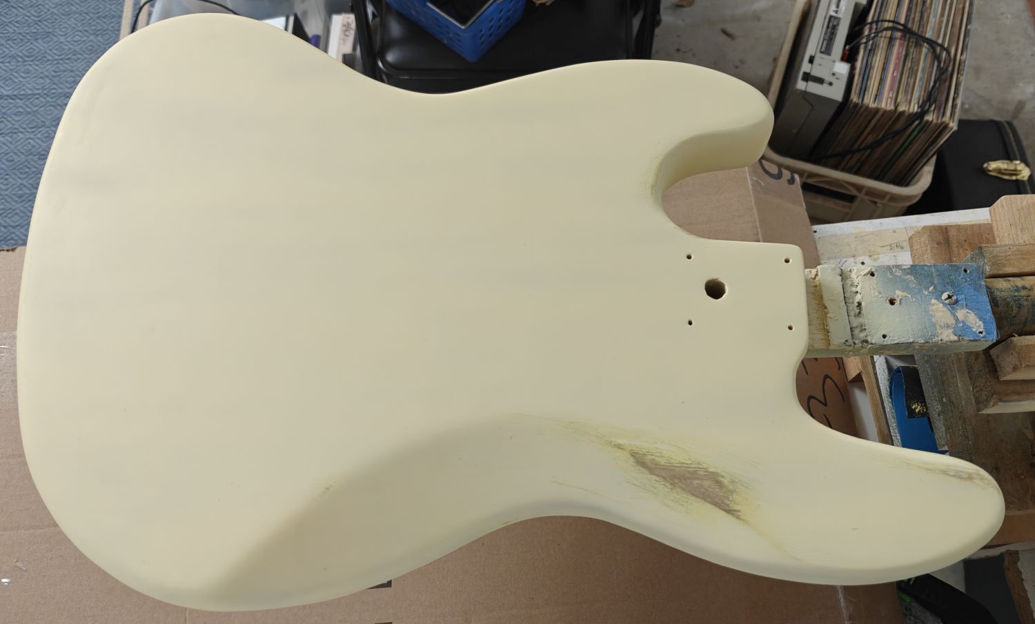

    It turns out that just wanting the paint to be hard enough to sand does not make it cure faster.
