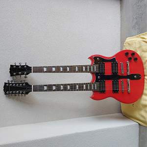

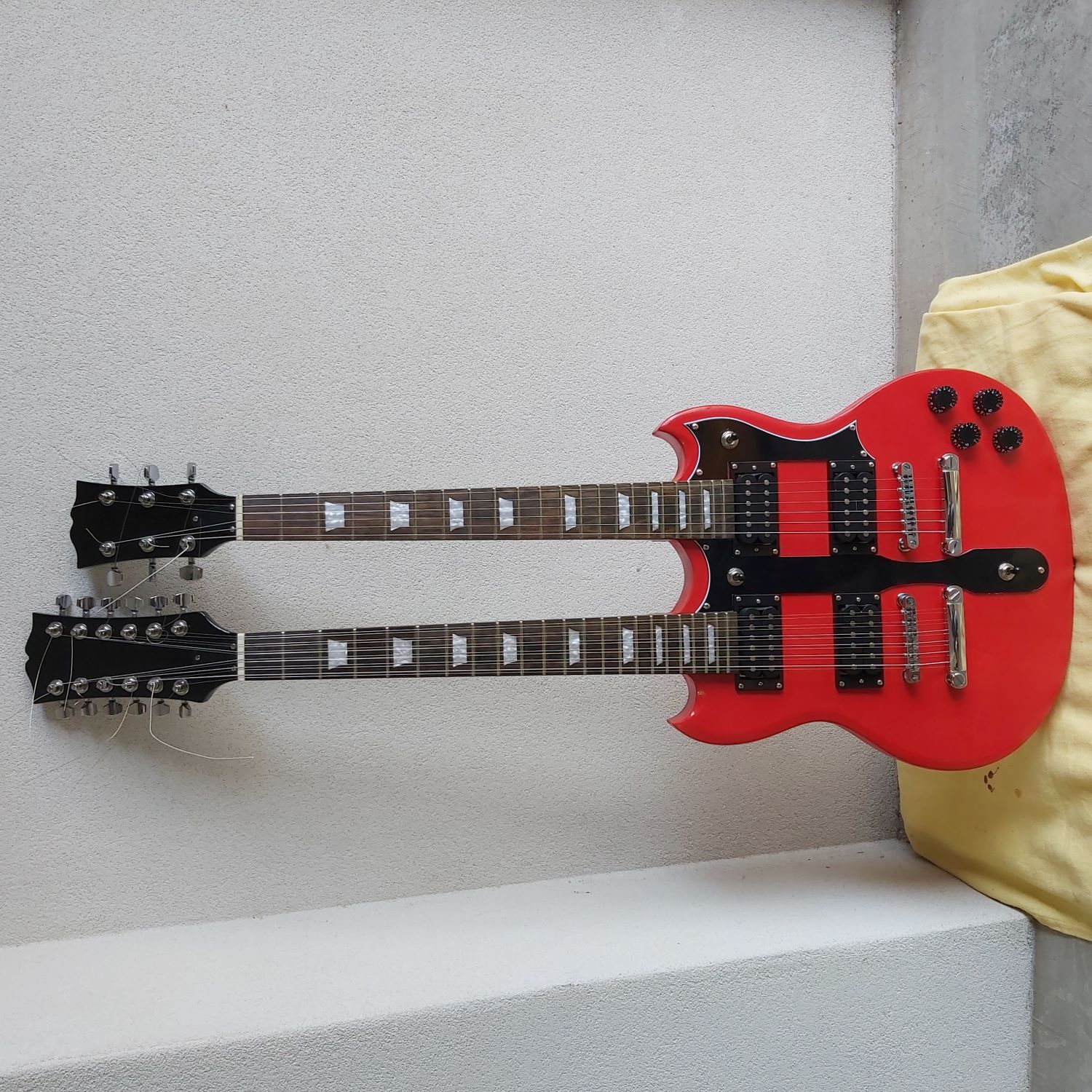

    I always apply clear too but whether or not I left them long enough soaking maybe my problem (seller disputed any batch problems). Got one on anyhow. Sort of happy with the sound. But I can't seem to get the first fret to sound properly even though all my measurements for string height at 17th fret and pickup clearances are spot on. Frustrating.

    Open strings all OK. All strings (I'm talking only the 6-string neck by the way - 12-string fine??!!) give only a 'thuk' when played both at the first and second frets; third fret and we're back to a normal sound. Never had to do any work with frets in the past so levelling and profiling would be a new experience (13 kits and counting). May have been lucky all these years?Click image for larger version.

    It could be high frets but is sounds more like there's a bit of a back-bow in the neck. Hold a string at the 1st and last frets (use a capo if easier) and see if you've got a gap between the string and fret around the 7th fret. If it's touching or almost touching, you might find that turning the truss rod anti-clockwise will give you enough neck relief to get those frets playing properly (you may then need to lower the bridge a bit).
    The truss rods are double-action so can bend the neck both ways. You may find that there's a lack of resistance to start with (or you come across it when turning the rod), but this just means that the rod's in the central position between adding more bow (anti-clockwise when looking from the headstock down the neck) and flattening the neck/adding back-bow (turning clockwise), and should start to bite within a few turns.
    Unless you know you have a lot of bow to take, out or add, the general advice given is to never turn more than 1/4 turn before checking the result.
    So I'd try the truss rod adjustment first before deciding to have a go at fret levelling. With a few tools, fret levelling is actually pretty easy, but time consuming, but you may find it's not necessary.

    Checked at 7th and string touching. Will look at loosening strings to get at truss rod cover and try the anticlockwise turn to bow neck and see if it makes a difference. Thanks.

    Success! First time adjusting a truss rod. Eighth of a turn anti-clockwise relieved the neck and an imperceptible gap at 7th, retuned and hey presto, plays well at all frets. Now to see whether I can lift the guitar!! My poor back (you were right Trevor!).
