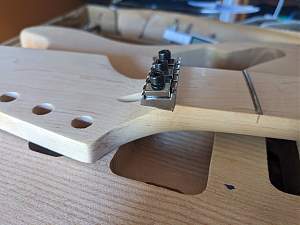

  12. #30
    I have at least pulled off the kit nut, filed down the wood and installed the locking nut. Might need to go down a bit more but will leave it as is for now and worry about it later when I can measure it correctly.
