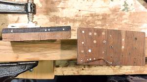

    ok, after many, many tests, and fun.
    In the photo below, on the right a piece of hardwood I have used for testing and learning. There's white timber filler there, black filler, sawdust with PVA glue, toothpicks, cotton buds, optical fibre ....
    The piece of timber on the left as a selection of the ones I think look best: white timber filler (3 dots on the left), and toothpick (last dot on the right)
Name:	2021-09-13 22.28.32-1.jpg
    For a combination of look and simplicity of installation, at the moment I am incline towards the toothpick option. The white filler as a nice contrast, but it looks/feels like white paint.
    The neck and fretboard have been stained black, I am ok with the side dots not having too much contrast. The fretboard is fretless unlined, I want the dots to recede a little bit, and use my ears more!
