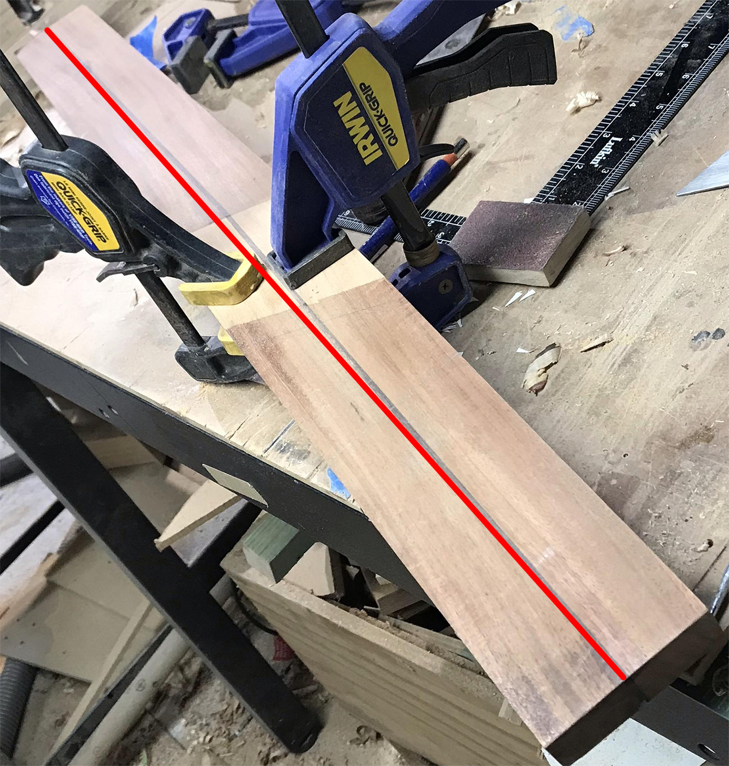

    I hope it's just the camera, and I'm positive you've got it straight, but this has been killing me..

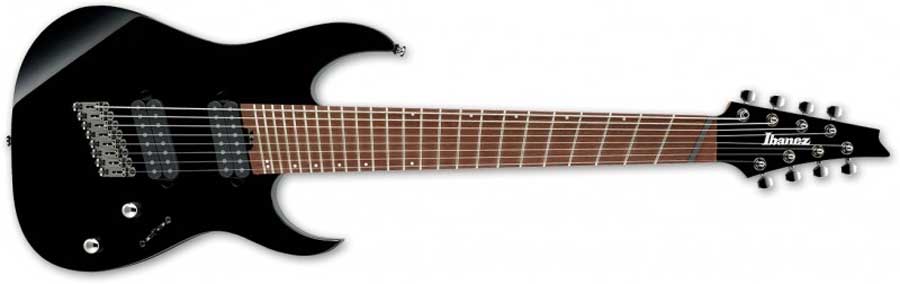

    As opposed to this type with the straight fretboard end which almost everyone thinks looks awful:

  4. #24
    The Pit Bull multi-scale kit neck had a fretboard like that Ibanez. It had a few other issues as well. They were trying to get it improved from the factory so the fretboard end was angled (and the pickups fitted properly). Was supposed to be back in stock mid-July but is obviously running late.

    Quote Originally Posted by ross.pearson View Post
    Yeah that’s one of the side effects of the angled cut and scarf. The head stock sides are also now out of the square plane of the blank sides.
    The line down the rear matches at the join, but once the shaping is done it may be minutely out of line. I could have avoided this by using a thicker blank and creating a HS angle by cutting away more material, or by using the F style stepped down headstock.
    My personal preference is Ibby style scarfed necks, though I have made both I and F style necks in the past.
  6. #26
    Rightyo. I knew it was multiscale, didn't realise the center line would be out of square as a result, but I guess that makes sense. I agree, that second example is god awful.
    Yes, that was what I wanted to avoid, that or the “straight scarf, angled board end” mismatch.
