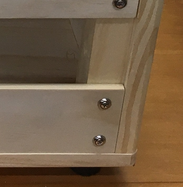

    My motivation for this is to cut down some weight from my existing 1 x 12 that's made out of chipboard and MDF. That weighs in at 14kg. I know it's not that heavy, but I ain't gettin' any younger...
    Based on weighing my parts & pieces and whacky calculations, I estimate the whole thing should come in around 9.29kg (loaded). I'm including that very specific number here so I can reference it when I'm done and see how close I was!
    So here's a pic of my rough unassembled pieces, and I will elaborate on my scheme below:
Name:	Pine n parts.jpg
    The 4 panels that will form the main speaker box are actually a unassembled beehive "super" (or brood box?). They come pre-cut with dovetail joints and two ends rebated (which will be the front). I wish I could take credit for the idea, but I pinched it from a guy on YT!
    I'm not properly tooled up to cut dovetail joints and I probably lack the patience tbh, so this was a perfect option for me.
    The box is made from 20mm solid NZ Pine (whatever that is) and is pretty clear. There are some small knots on one end piece, but I'm fine with that. I'm going for a fairly "rustic" look, so I won't be putting tolex or any covering on, and will stain and poly.
    I'm using 12mm premium ply (BGS) for my baffle board and 7mm premium ply for my back panel(s).
    Some of the timber I already had and some hardware (jack, jack plate, feet and a 12" Celestion).
    The cab will end up costing me about $180+ which is half the price I've seen for unloaded manufactured cabinets.
    This cabinet is to be paired with my Quilter Superblock US which is a brilliant little analogue 25w amp the size of a dual overdrive pedal.
    I'll post more pics as things progress. Thanks for indulging me!
