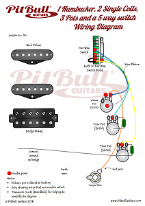

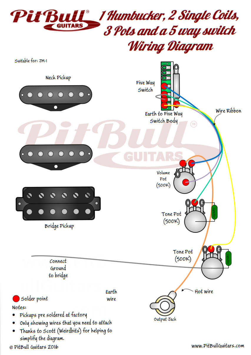

    There is a little bridge on the wiring diagram between two of the pickup selector soldering points that looks wrong to me. It looks like you would always be selecting the humbucker and middle pickup together. Which pickups should get the tone pot? Can someone check that the diagram is right for me?
  6. #26
    To avoid any confusion, which diagram are you using?
    The 5-way switch is really two sets of contacts in one package. On more expensive /traditional 5-way switches, you have the contacts laid out on either side of a central wafer. With these 'import' switches, all the contacts are laid out in a line with the two 'common' terminals in the middle. On some switches, as the commons are always connected for standard Strat-style applications, you just get 7 connections with the two commons pre-linked.
    So one 'side' of the switch takes the inputs from the pickups and takes them to the common output depending on switch position. The other half of the switch takes the common output and passes them to the connections running off to the tone pots. Obviously only two tone pots (not quite sure what Leo was thinking when he did the Strat), and on a Strat you'd traditionally have the mid and neck pickups with a tone control, the bridge without. It's only a question of swapping the connected tabs over if you want a different arrangement, and you can have two pickups sharing the same tone control.
    If it were mine, I'd wire one tone for the humbucker and one for the mid and neck pickups. What would you like?

    It's the one labelled One Humbucker, 2 Single Coils to a Control Panel. It says suitable for JM-1 under it.
    Your suggestion seems reasonable. How do i wire two pickups to a tone pot without shorting them together across the 5 way switch?

  9. #29
    The standard JM-1 wiring diagram shows the switch linked for a common bridge and middle pickup tone control, with the neck on its own tone pot. This is a carry-over from a standard Strat modification. A standard Strat has no tone control for the bridge pickup, so using the mid tone control for both middle and bridge pickup allows you to knock some treble off the often quite strident bridge pickup on a Strat.
Name:	JM-1 basic.png
    But with a bridge humbucker, you don't really want a common tone control for it and the middle pickup. By moving that connecting link as shown below, the humbucker has its own tone control whilst the two single coils share one. This is far more useful as with a 500k volume pot (normally 250k with all single coils), the two single coils can sound quite bright, so you may well want to have their tone control rolled back a bit.
Name:	JM-1 bridge humbucker own tone pot.png
    Note that as drawn, the tone pot nearest the volume is the bridge tone, the one furthest away is the mid/neck. If you'd prefer it the other way round, then swap the connecting wires over either at the switch end, or at the pot end, (but not both ).

    Oh I think I'm misunderstanding the switch. Do I wire the pickups to the three spare posts? It is a bit confusing that the existing wiring is not shown. The end result being that all 7 posts have something attached to them?
