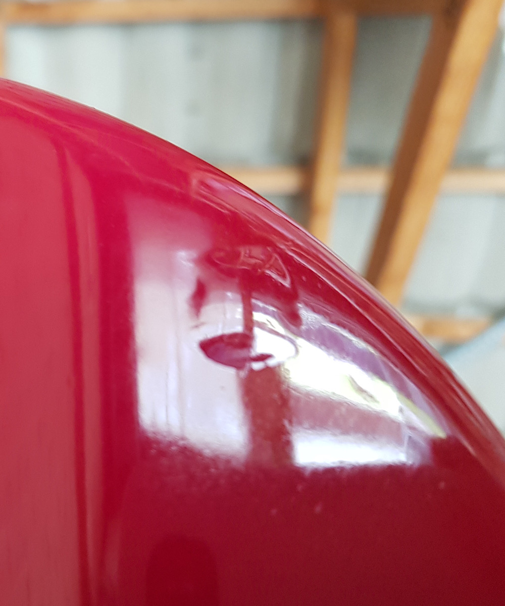

    Thanks Mac, I have this week at home and have resumed work on the bass. After an extra coat of colour on the body I left it out in the sun and low and behold a bloody air bubble. Never mind, sanded patched and painted again.

    I’ve had quite a few annoying paint blisters on my Jazz bass build. You can’t get the finish too hot before it’s had a chance to dry otherwise the surface goes hard whilst you’ve still got solvent underneath. This vaporises and the gas forms those bubbles. If you ate quick, you can pop it and push the bubble down so it sticks back again with minimal damage. But certainly with nitro, the solvent softens the layers below, and left too late, the bubble can take off more paint with it, leaving a pit below it which takes more filling.
    You have my sympathy.
    Yes, "drying" in the sun is not a good idea, as you've discovered.
    Sounds like you managed a good recovery though.

    Thanks guys, unfortunately it was back to the wood. So a quick sand of the area and filled with epoxy and away we go again. Luckily it was on the arm cut-out, so I could tape off the rest of the top and just re-paint that area.

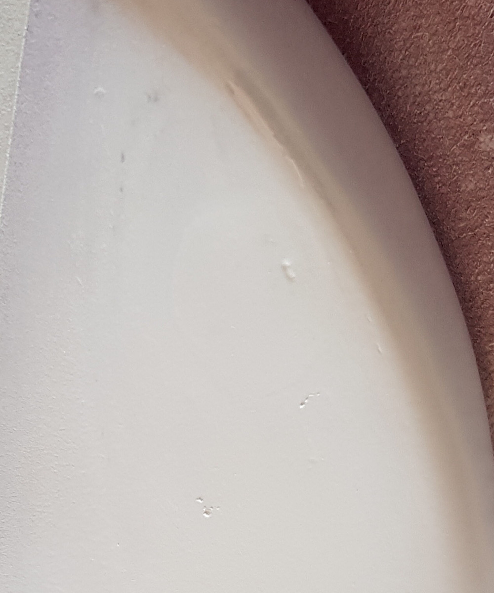

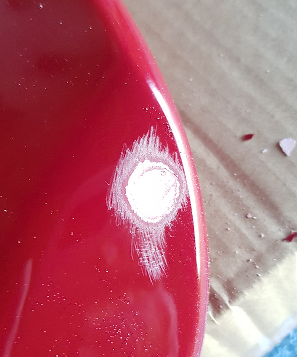

ID:	41191Click image for larger version.
ID:	41193Click image for larger version.

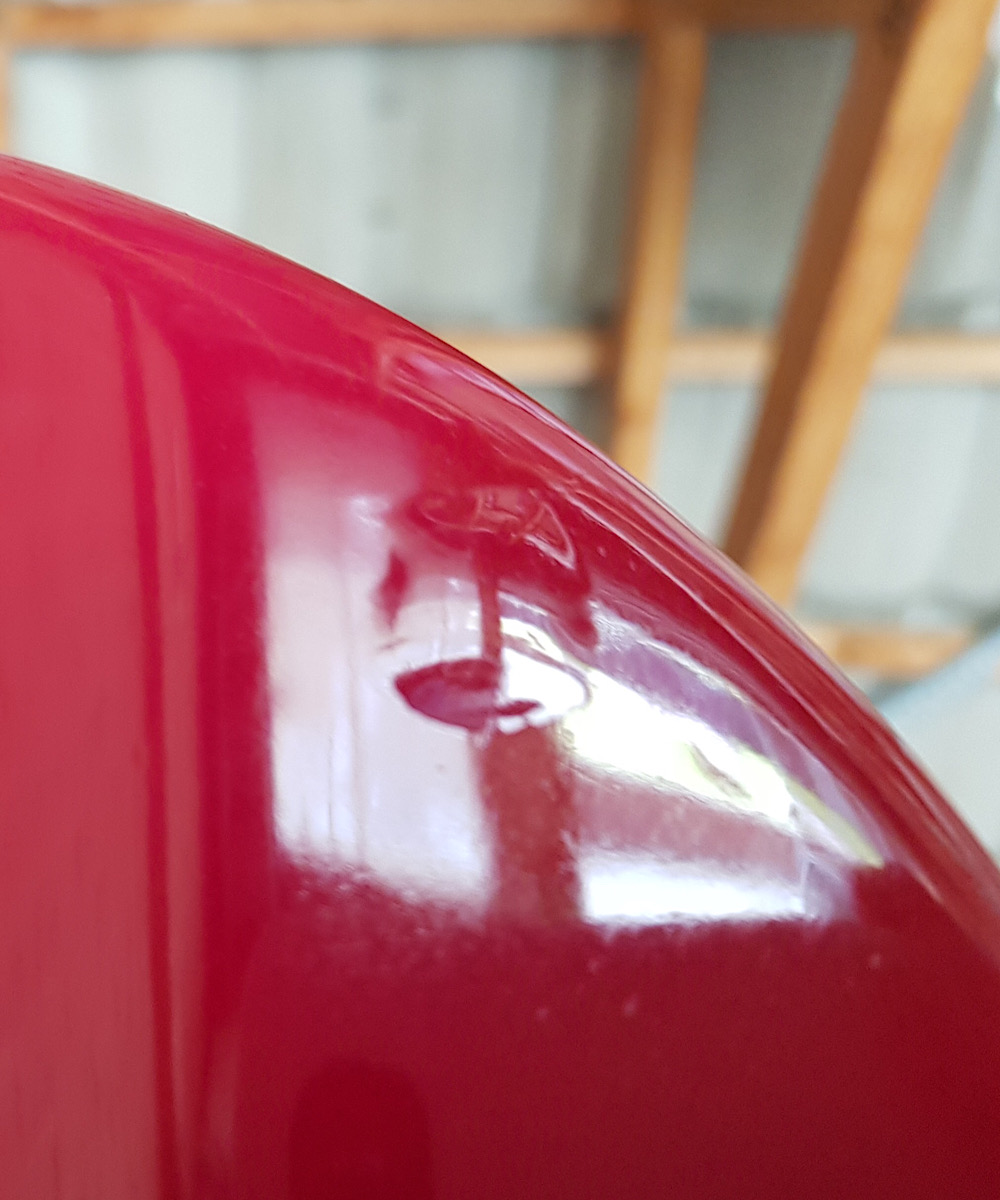

    Some pics of my repair on this bubble. After a bit of wet sanding I will give it a couple of clear coats to seal it and hopefully it will look as if it didn’t happen.

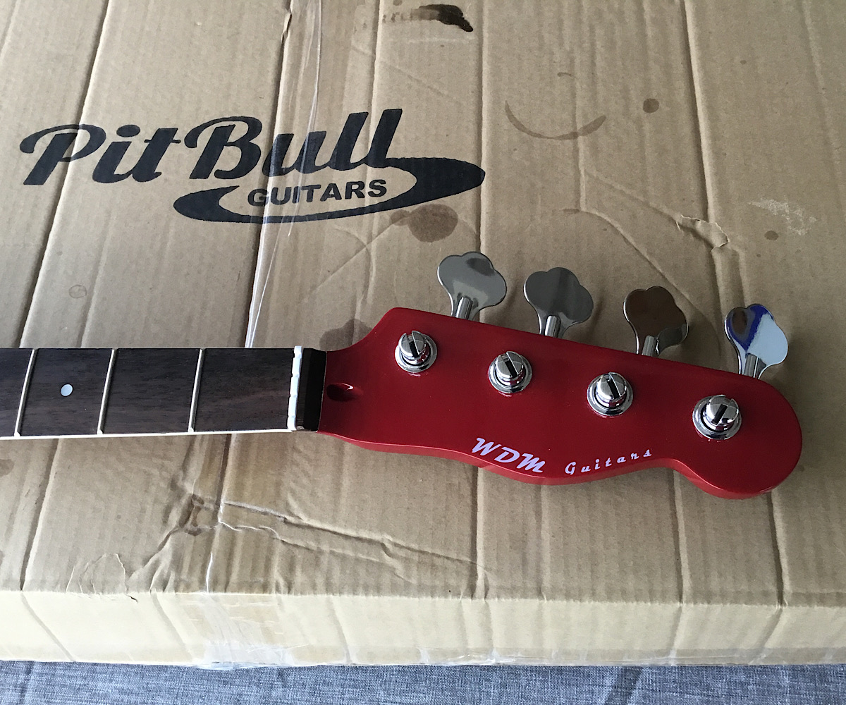

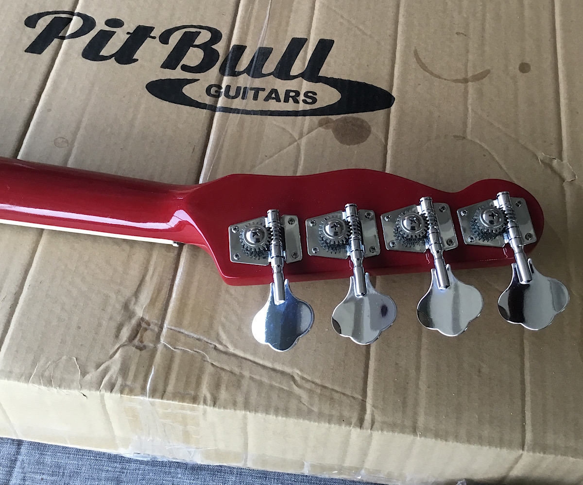

    Had a bit of spare time today, ha ha ha, so I added a bit of bling to the headstock. Coming along nicely.
    Too much time on my hands in lock down, not used to this not working business. I might have to start pulling other guitars apart and re-finishing.

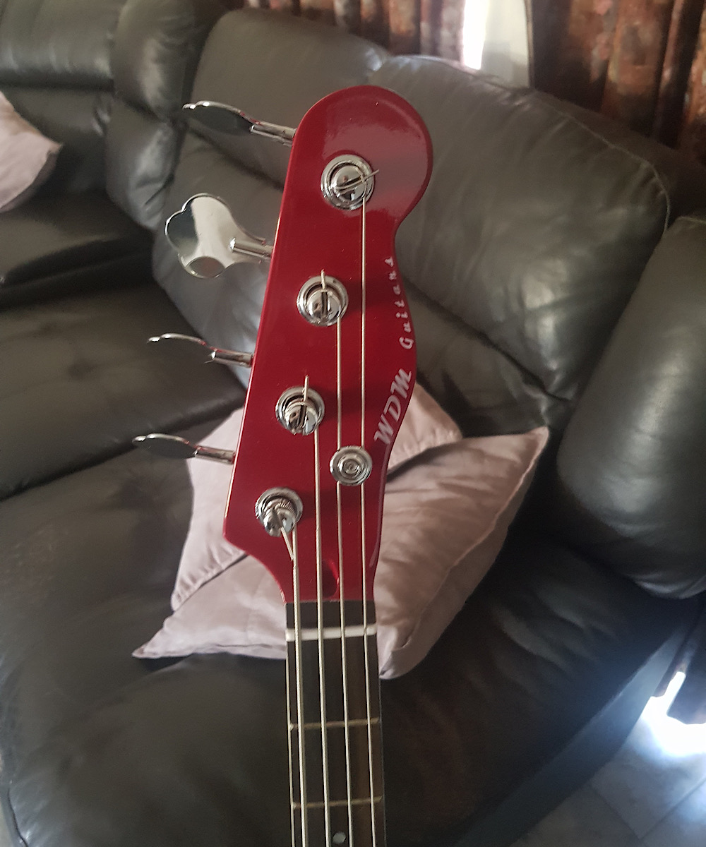

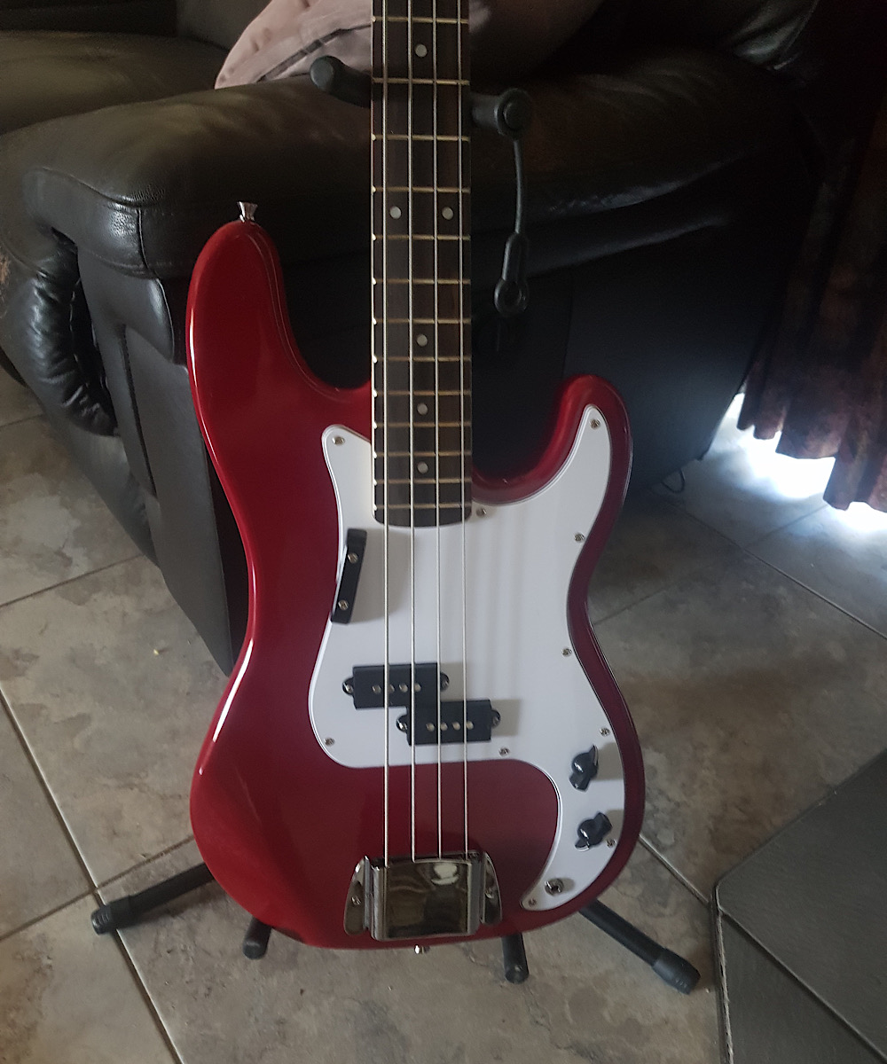

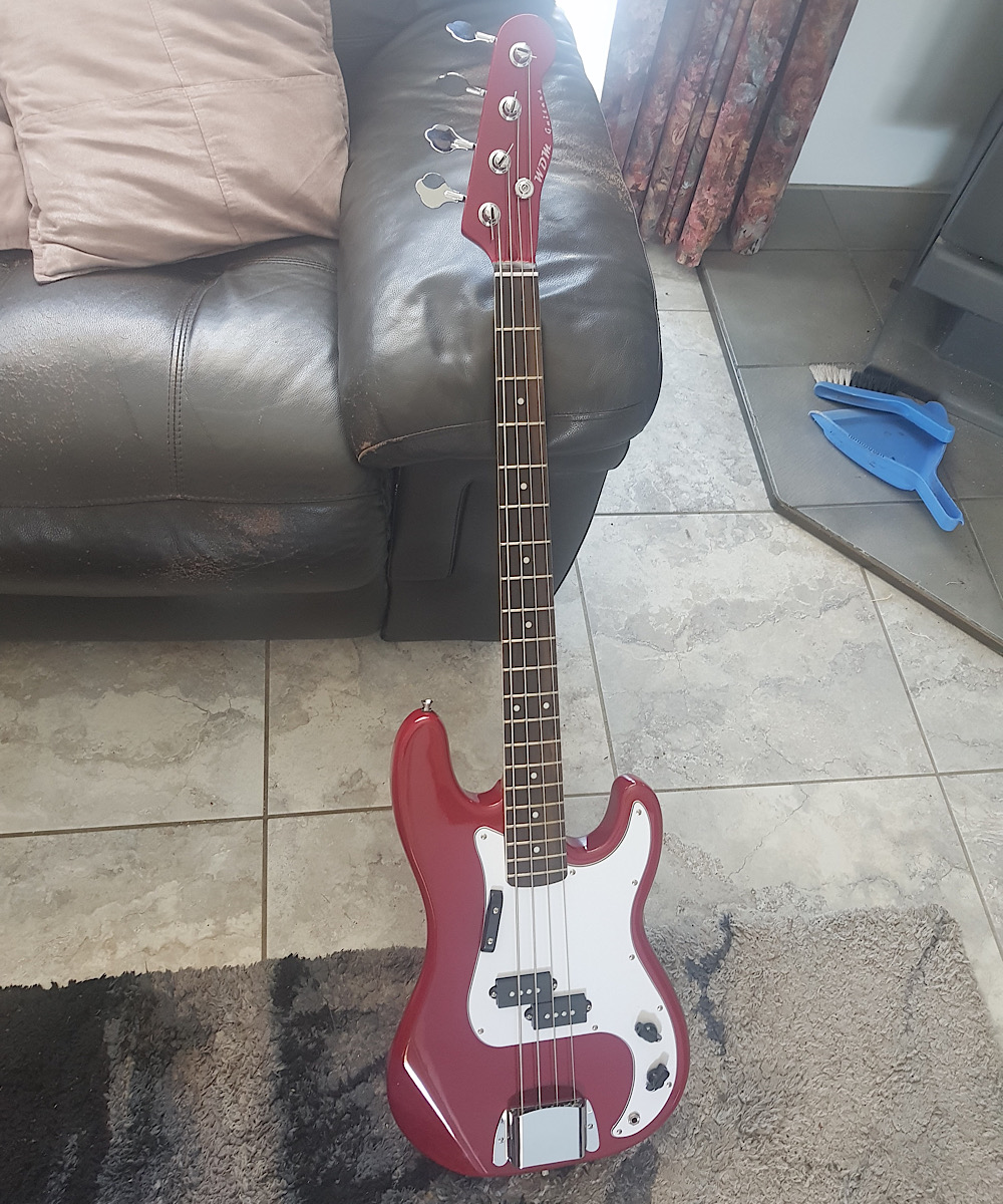

    Hi all, I have finally finished this little fun project and have learned a few lessons in spraying solid colours. I sent these pics off to my brother (who didn’t know about it) but haven’t heard back yet. I had a small problem with the action being too low, so I used a sharp chisel and took one mm off the neck pocket at the inner end to give it a very slight angle. Worked a treat. Click image for larger version.
ID:	41297Click image for larger version.
