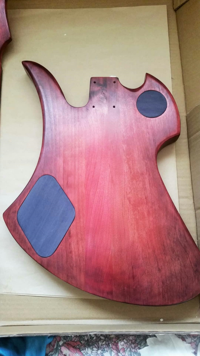

    I stained the covers with black dye, still have to sand them with 240 and I didn't decide if I should leave them black or dye them with matching color to the body.

  6. #26
    My preference would be to leave them black. It’s hard to stain two different pieces of wood to match exactly, even if the same basic variety of wood.
    If you feel the basswood covers feel a bit flimsy (especially the larger control cavity cover) you can always cut out another piece that’s say 1cm smaller all round, with the grain at right angles to the top piece, and glue it on to double the thickness and form a basic ply. Just leave enough of a gap round the edge so that it fits into the main part of the cavity and doesn’t catch on the rim. You can also do that using stiff plastic or similar as it won’t be seen.
