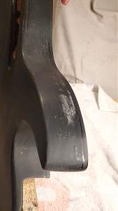

    apparently doing a matte back just really wanted to give me a serious issue. I kept sanding right through 5+ layers of poly and the black stain. I finally got it to a decent place, where I'm not going to fuss about it anymore...but this is what I kept running into.

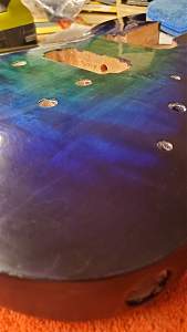

    here's a pic of the top...which gave me little to no issues.

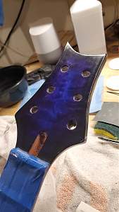

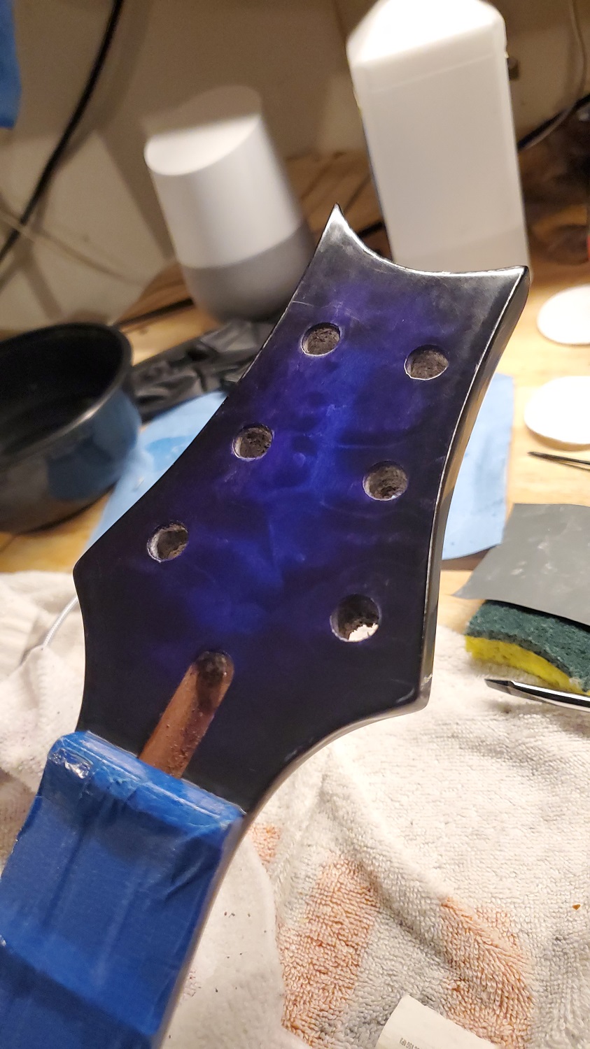

    an upclose of the headstock. There's some warping, a little sanding uneveness and oddness on this one, but I'm not going to fuss over it either at this point, because I think I'll make it worse if I try to fix it at this point. And since this IS my first build...I'm just going to enjoy the color blend.

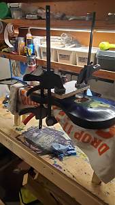

    And here's the neck setting on the little table rig that I had to build so my clamps would work for this project.
  4. #24
    Quote Originally Posted by marcianotmarsha View Post
    I love seeing how we all approach problem solving!
    As much I dislike having a problem, solving them creatively is actually kind of fun! Good work!

    I've never used wipe-on poly but I doubt that each layer is very thick. If it's anything like Tru-Oil consistency, then you'd need to apply a lot more layers to be able to sand flat without sand-through. Even with multiple coats of nitro spray (each spray of which gives a reasonably thick coat), I still get sand-throughs.
  6. #26
    I agree with Simon.
    I have used *wipe-on poly quite a bit on necks and bodies, and I typically apply at least 20 coats but aim for 24-28. (sometimes I lose track so just do extras)
    The reason I have an asterisk on wipe-poly is because I mix my own. I mix 50/50 poly & turps. It works just as good as the stuff you buy, and costs about 1/3 the price. Store-bought wipe-on poly is basically just thinned polyurethane anyway.
    The advantage of DIY wipe-on is I can vary the consistency if needed. I mostly spray my poly now and the 50/50 mix is perfect in my airbrush.
  7. #27
    Aug 2020
    Florida, USA
    23
    I agree with Simon.
    DAMN!! 20 coats?!? Well..now I know where I went wrong. geeeezzzz! I think next time I do this, I'll get one of those "thick coat" polys. Somehow it worked out really well for the top...but the back was a nightmare. So...lesson learned with my first build, I guess..

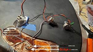

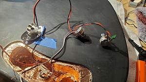

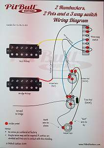

    Can somebody please help me make sense of this?!
    after all my fretting about the electronics, it turns out everything came presoldered (as far as the pots, the switch and the jack) I know that I'm going to need to desolder and then resolder the jack in order for me to be able to properly install the jack. But I'm trying to understand what is what in comparison to what I have which is.....
    and what the diagram says for my build....
    the red wire coming from the guitar is the bridge pickup, and the black one is the neck pickup. the black wire that is taped to the back is for grounding to the bridge.
    I also have a spare blue wire that came with the kit, which I'm unsure exactly where that goes as yet.
    part of my confusion is that the diagram has a picture of a 3 way switch that has 7 tabs. the one I have has 4 on one side (the 2 middle ones are bent and soldered together with the purple wire that is coming off of the volume pot. But there is no wire from the volume pot to the switch in the diagram. I think that's just the beginning of my confusion. both wires from the output jack are going straight to the volume knob, instead of one going to the jack and one going to the tone knob.
    I have a feeling I'm overcomplicating this...but...the picture and what I have aren't looking the same, and my mind is being blown.
    and it looks like there may be another much thicker tab on the other side that has the grey wire soldered to it.
  11. #30
    The PBG diagram is for a 3-way blade switch, whereas yours is a 3-way toggle. This diagram is better match for your build, but it doesn't really matter.
    Hopefully this helps:
    The rest of the connections appear to be OK, but I can't see all the lugs on the volume pot to be certain. Don't worry about the 'spare' blue wire.
    The black ground wire from the jack is going to the back of the volume pot and then to the back of the tone pot. The grey wire is going from the back of the volume pot to the ground lug on the switch. Thus both pots and the switch have a ground connection to the jack. The red wire from the jack is your signal 'hot' which goes to the lug on the volume pot. The purple is the 'hot' output from the switch to the other lug on the volume pot, and then another red links this to your tone pot. Make sense?
