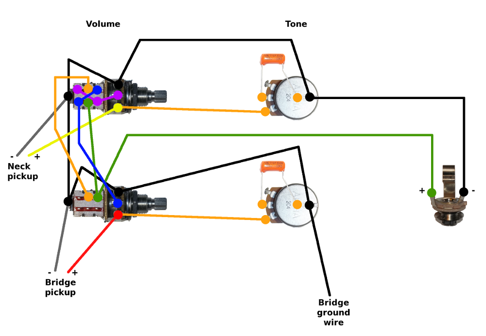

    You're almost there.
    Here's couple of ways you could wire it, in both cases the neck volume push/pull selects the single pickup (down for Bridge and up for Neck), and the bridge volume push/pull selects between single pickup or both (down for single, up for both).
    Jim's type of layout:
Name:	Push_Pull_pickup_selection_2V_2T - option 2.png
    Same result, different way:
Name:	Push_Pull_pickup_selection_2V_2T - option 1.png
    Hope that helps.

    Brilliant! This was definitely much more than I ever dared to hope for. Many thanks to all of you.
    With such detailed instructions I feel pretty confident I can make it work.
