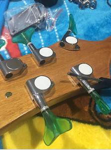

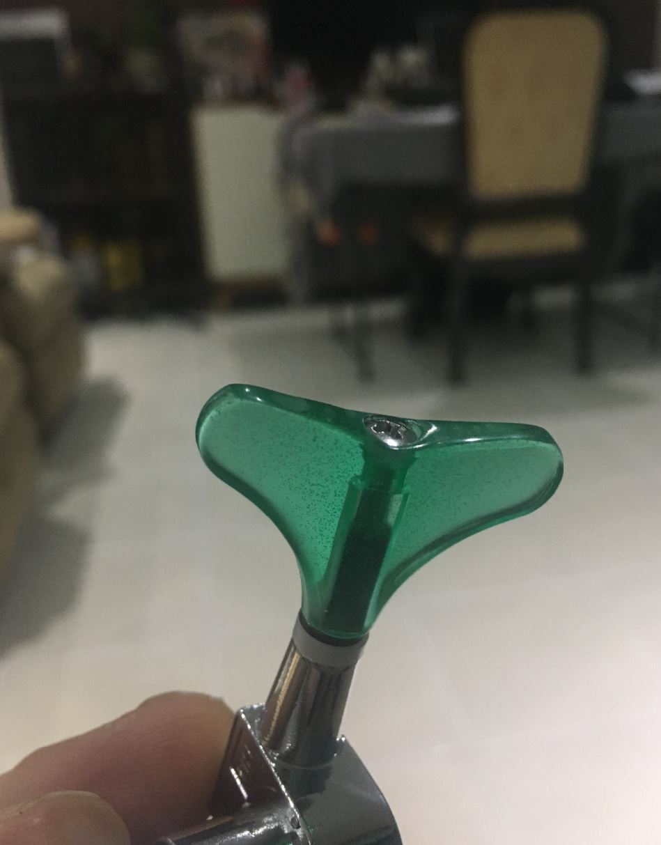

    And here are the machine head buttons and sanded and polished ...

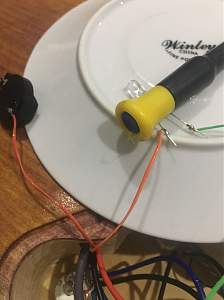

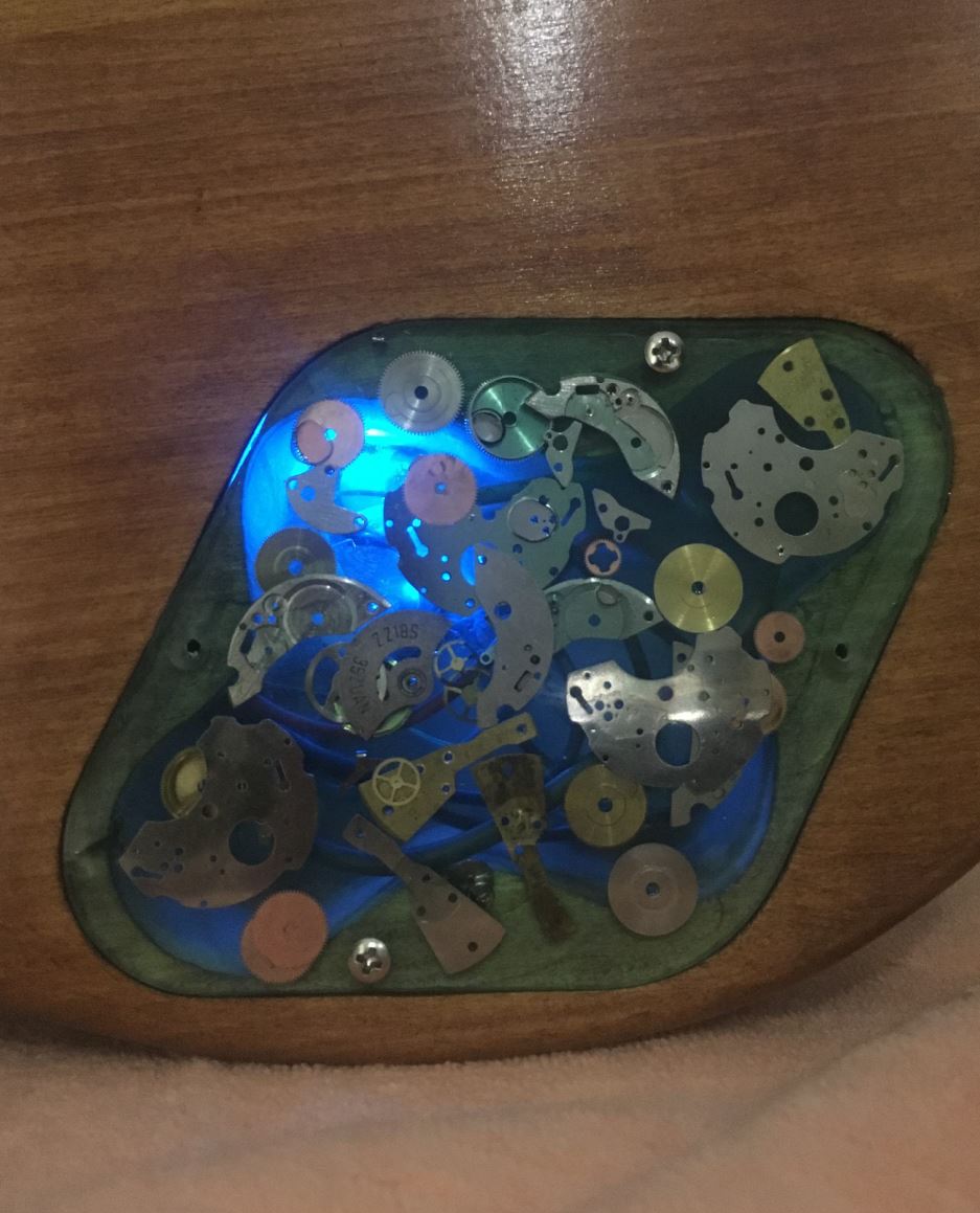

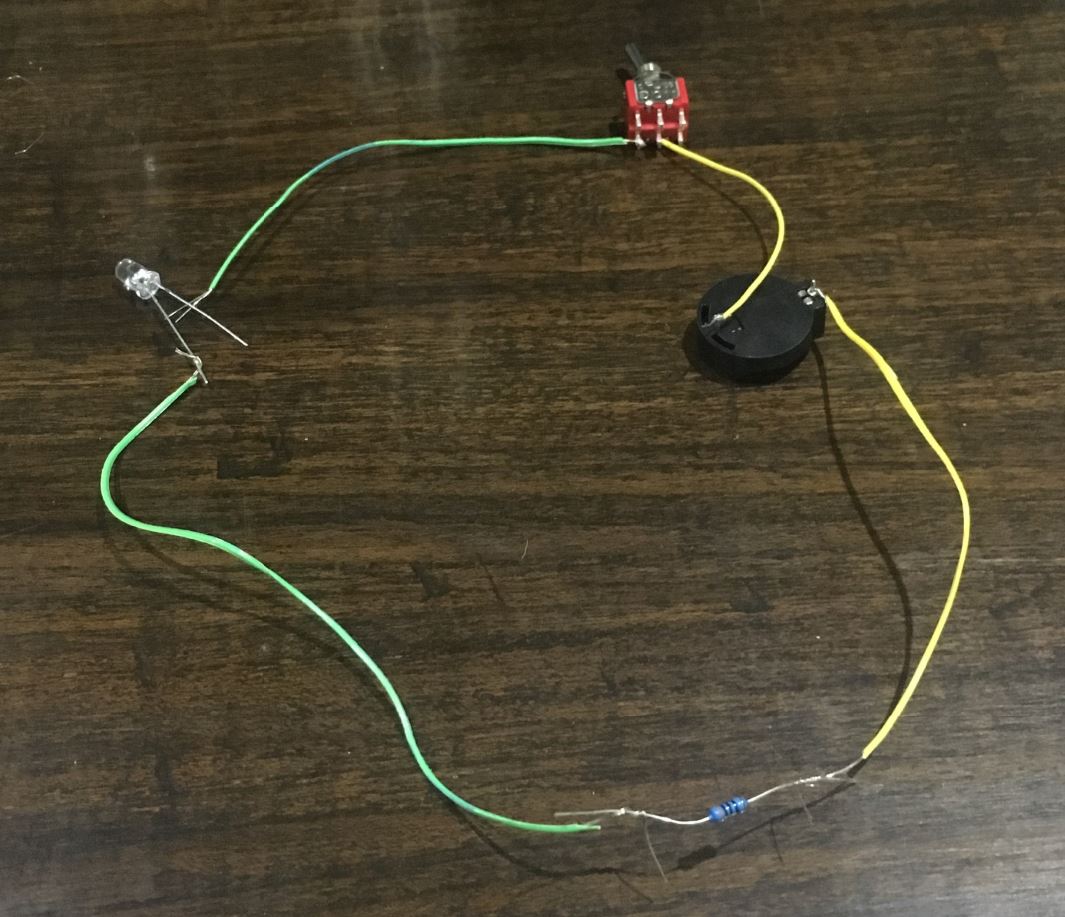

    While I was sanding the resin (and casting more!), I had an idea. This is the start of it, trying to figure out the wiring. Thanks to YouTube, I found just what I was looking for. Here is the test setup ...
    Once I was happy with that, I picked up the soldering iron and got to work ...

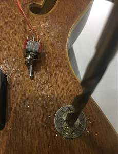

    One more hole in the body - sorry, had to be done!
    And wool-ah!!! A switchable light for the control box! I cast the cover in resin and because it is translucent, it looks so good!! I love the blue LED's. It doesn't make the bass sound better, but it is better for the eyes and soul!!

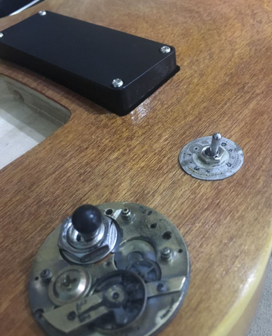

    Current state ... Smaller switch controls the light. Kinda pointless, but its fun \m/

    I like the lights, very cool.
    Are the visible from the front of the guitar, or just the back? Will the glow be visible through the f-holes?
    Heya, just from the back. I like the "hidden secret" aspect of it and the additional button makes me feel warm and fuzzy inside.

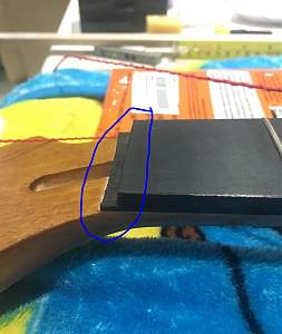

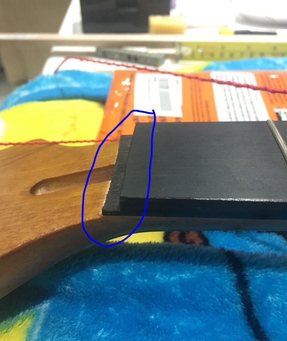

    I just installed the neck and when I was about to string it I noticed the nut is missing Not sure what to do
    ~~ love through art ~~
    Build 1: DHB-5 Semi-Hollow Electric Bass https://www.buildyourownguitar.com.a...ad.php?t=10621
    Build 2: GSM-1 Electric Guitar https://www.buildyourownguitar.com.a...ad.php?t=10714
    So I came across a hiccup My nut is missing (see post above). So, unfortunately, I don't think I will be posting much in tonight's session. Before I realised this, I had done the following so it was not a completely written off night. And I had only a few hours sleep last night so an early one might be just what the doctor ordered.
    Installing the machine head: I have been waiting in anticipation for this to happen. I am happy with the custom tuning pegs i cast in resin. I threw in a bit of Emerald Green and they came up beautifully. The holes were pre-drilled which made things a little easier.

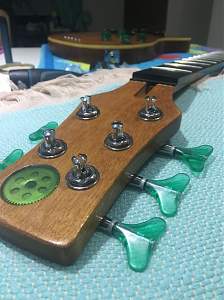

    And the end result

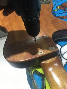

    Next up, I lined up the neck and bolted that in. I listened to @simon barden's advice and increased the holes in the body ever so slightly and drilled into the neck. The pre-drilled holes in the neck did not line up so I needed to make 4 more. Yay, the bass is now 1 piece

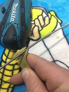

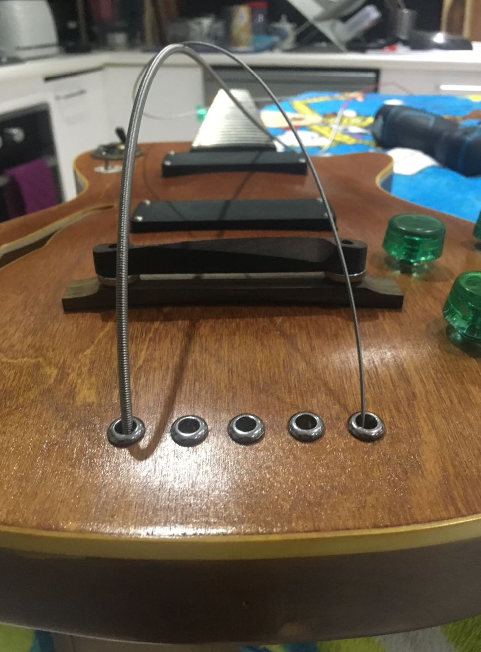

    Stringing: So when I tried to thread the B string through the body, it did not fit. A simple measure with my caliper, and a hole widening soon fixed that
    B and G strings through the body ready for the next phase
    And then the awful realisation that my nut is missing.
    Guess I will need to wait until tomorrow. This might be a blessing in disguise? I wonder if I can customise this?
    I will put it on the backburner and see how I feel tomorrow.
